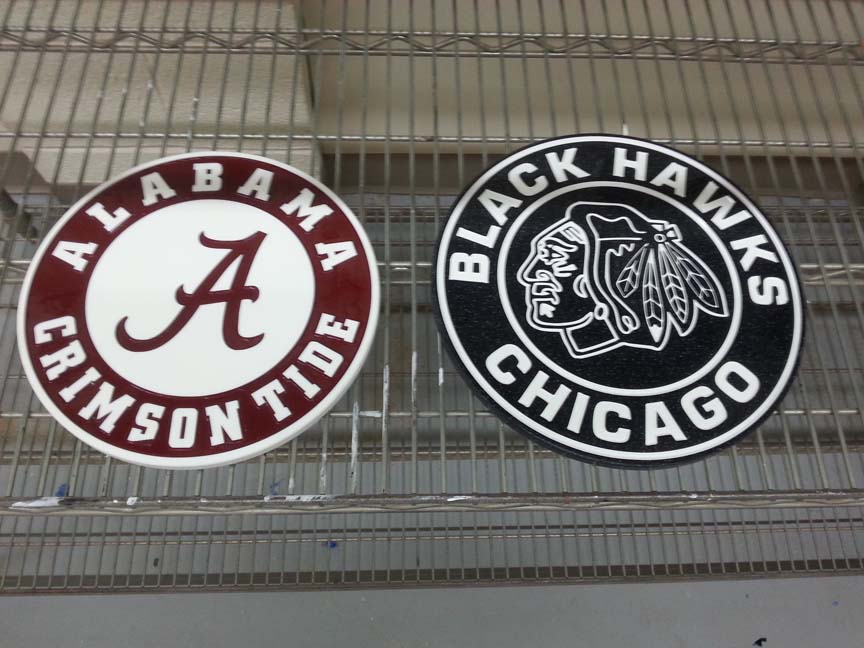

Some new projects.
They are made from corian using the vcarve toolpath with a flat area clean out tool.
After that they are spray painted and sand/polished, 100g to remove the paint after that we use a 4 step process made by 3M.
It is called trizact and is made for polishing acrylic.Attachment 27131

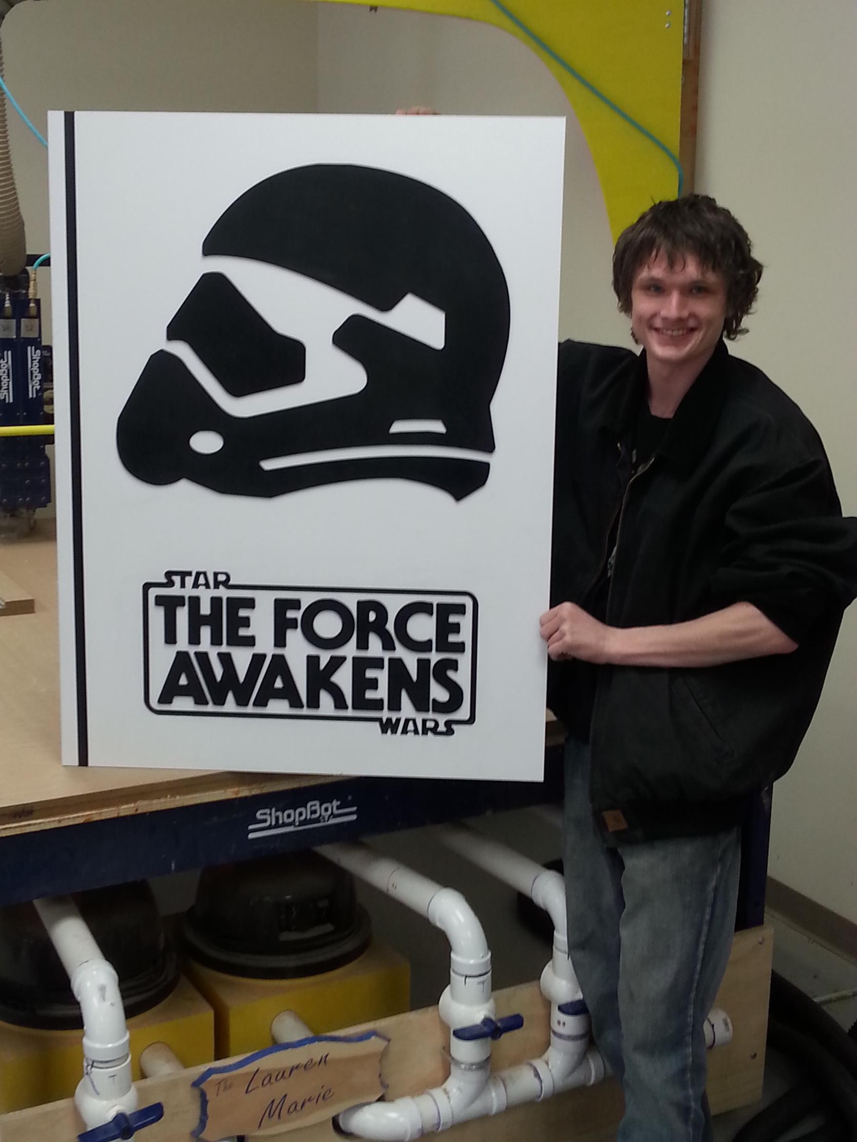

Another project.Attachment 27229
