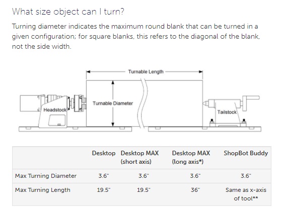

I believe they spec diameter, not radius. From the Shopbot website:
Attachment 34159
Randy
Yes, the measurement from the center to the table TIMES TWO. I apologize for my mistake.

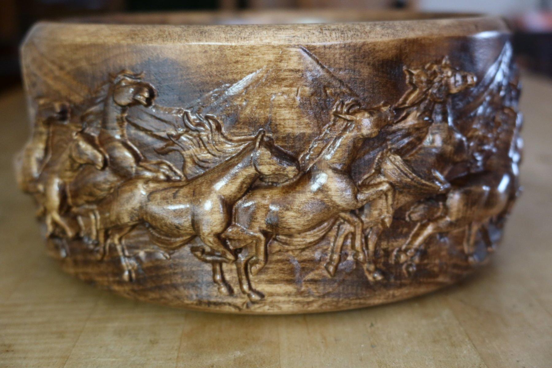

This carve is less than 10".
Attachment 35403
This one was a little over 10" diameter. I did turn the ID of this bowl on a lathe as it is 4" deep.
Attachment 35406
