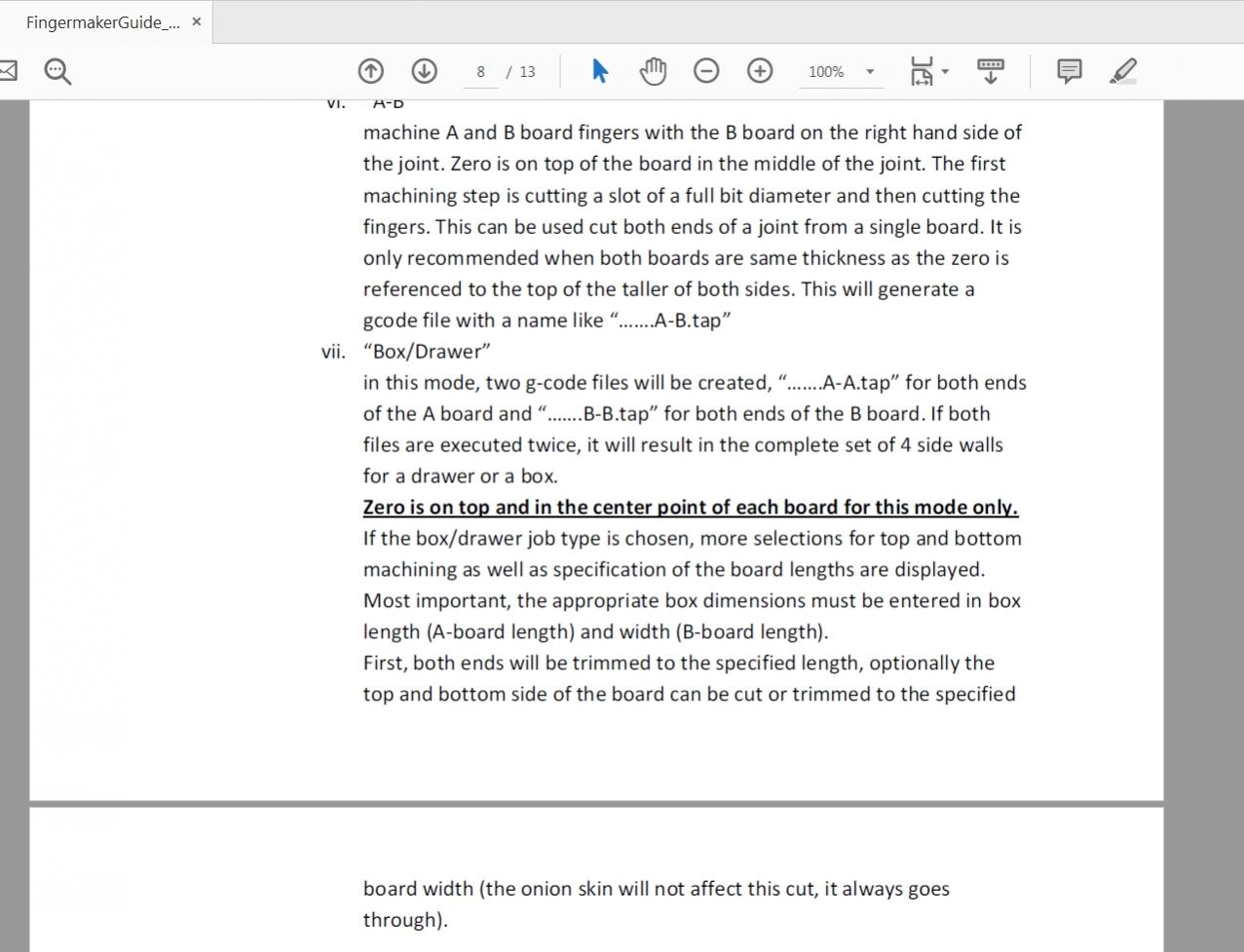

I have the TAP files generated by Fingermaker and wanted to open them in Aspire, hoping to shift the pieces for optimal placement on my lumber piece.
I didn't see how I could import it (other extensions yes, but no TAP file).
I can't get a satisfying view on Shopbot 3 (I downloaded the latest version to my 'new' laptop), and although I can preview the TAP files, I don't know how to shift the pieces, if that is possible.
I just found this on the Vectric forum: You can optionally output a CSV file that in turn can be imported to Vcarve/Aspire with Paul Rowntree's CSV importer, although it requires additional effort. If you happen to have the Shopbot control software (with or without the machine), you can import and simulate g-code files directly...
I emailed Tailmaker, as I seem to only be able to generate a TAP file, the CSV option still gives me a TAP file. Other ideas welcome.
