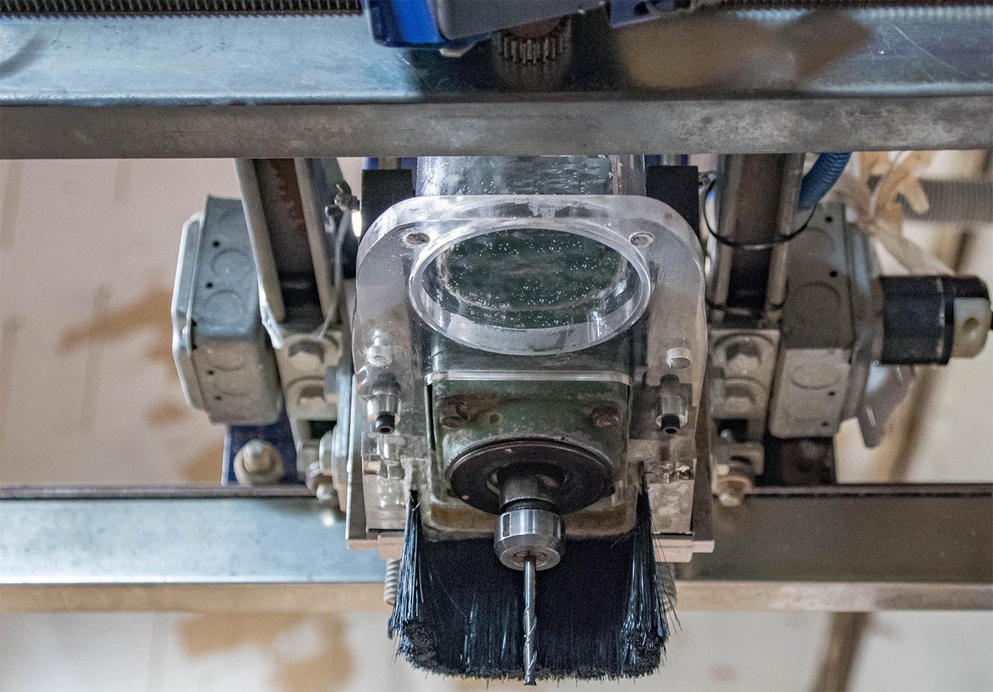

I've been procrastinating for long enough, I'm finally getting around to the upgrades on the old ShopBot. Out of necessity I've already upgraded the computer to a new windows 10 touch screen, although the touch screen part doesn't get used because the 'puter is in a box to keep it clean. Also replaced the control board with the latest version, as the old original died along with the 3PH Woods spindle control replaced with a HUANYANG VFD.
The dust collector boot is coming along, still have to drill & tap some holes. I cut the parts on the laser, split the boot so I could change bits without having to raise it high enough to get the boot off, magnetic attachment. It rained today so I played hooky today, working on the boot. So, tomorrow will be a work day. Unless it rains again.....;)
2 Attachment(s)
I miss calculated the clearance for the front magnet holding the boot. I didn't think the spindle would go high enough to hit the gantry, but it did by about 1/2" from the top of the travel. I cut the magnet tab off and relocated one on each side back far enough to clear. Everything fits now, snug but everything clears. I wanted to keep everything inside the gantry to keep it all out of the way. I have a few more parts to build for the vac system & then I can tear the CNC apart to start installing all the update stuff.

What did you use to design the yours, and how did you bond the acrylic together?
Thanks Eric. I designed this one with Flexisign. It's the program I use everyday in the sign bus., so I'm most at home using that program. I used ''SCI Grip'' acrylic glue to bond the parts.
