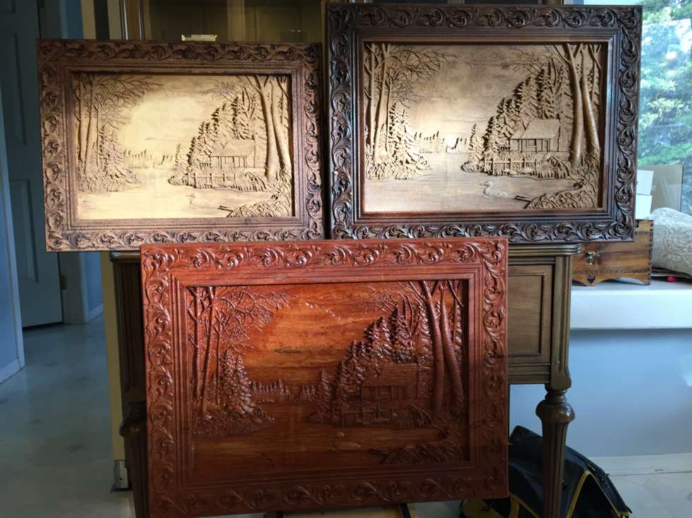

Another one, on the big machine cut time in half.
I've found that if my base is 5/8 the depth of my 3d model, no warp.
So if I'm using 1" stock, I'll only go 3/8" deep with my 3d model.
I can get around that, too. If I make a 3/4" 3d model on 1" stock, I'll just frame out the back of the sign with the approprate "extra thickness".
I've watched very carefully to come up with that 5/8 number, but your mileage may vary.
If a model is unbalanced, with more 3d work on the top of the sign (running with the grain) than the bottom, the bottom may want to cup while the top is fine.
I glue, clamp, countersink, screw, and plug my framing on the back.
Then I always finish it just as if the back is the finished product.
It's a lot of extra time and grief, and it often makes no difference to anyone but me.
The extra work makes the stuff I do ageless, and that's what I'm after. And problems suck. The extra time and lumber I put in has yielded a history of zero problems, so I just keep doing it. :)
Scott, I guess its your way of asking how I manage the relief warping of my carvings.
Over the years I have different methods for the variety of different applications we get involved in such as relief carving for doors and large plaques we make for presentations.
On most relief carvings you are correct, I usually epoxy a stained hardwood ply pre carving to the back and make it part of the piece, if carving a 3/4 inch material it would have a 3/8 or 1/2 inch prestained ply epoxied on it before carving and if carved 1/2 to 5/8 its very inert, but messes can be created using glues as they shrink when drying and create there own stresses also pre-cutting groves and epoxying is not and exact science, so if you have a way that's working for you "salute".

Thanks Russ, I ran one more of the same design, smaller different wood again, am very pleased with all 3 cuts, am going to do one more "for me" will do it when things slow down a bit and it will be 34 x 48 in size and 2 inch depth.
