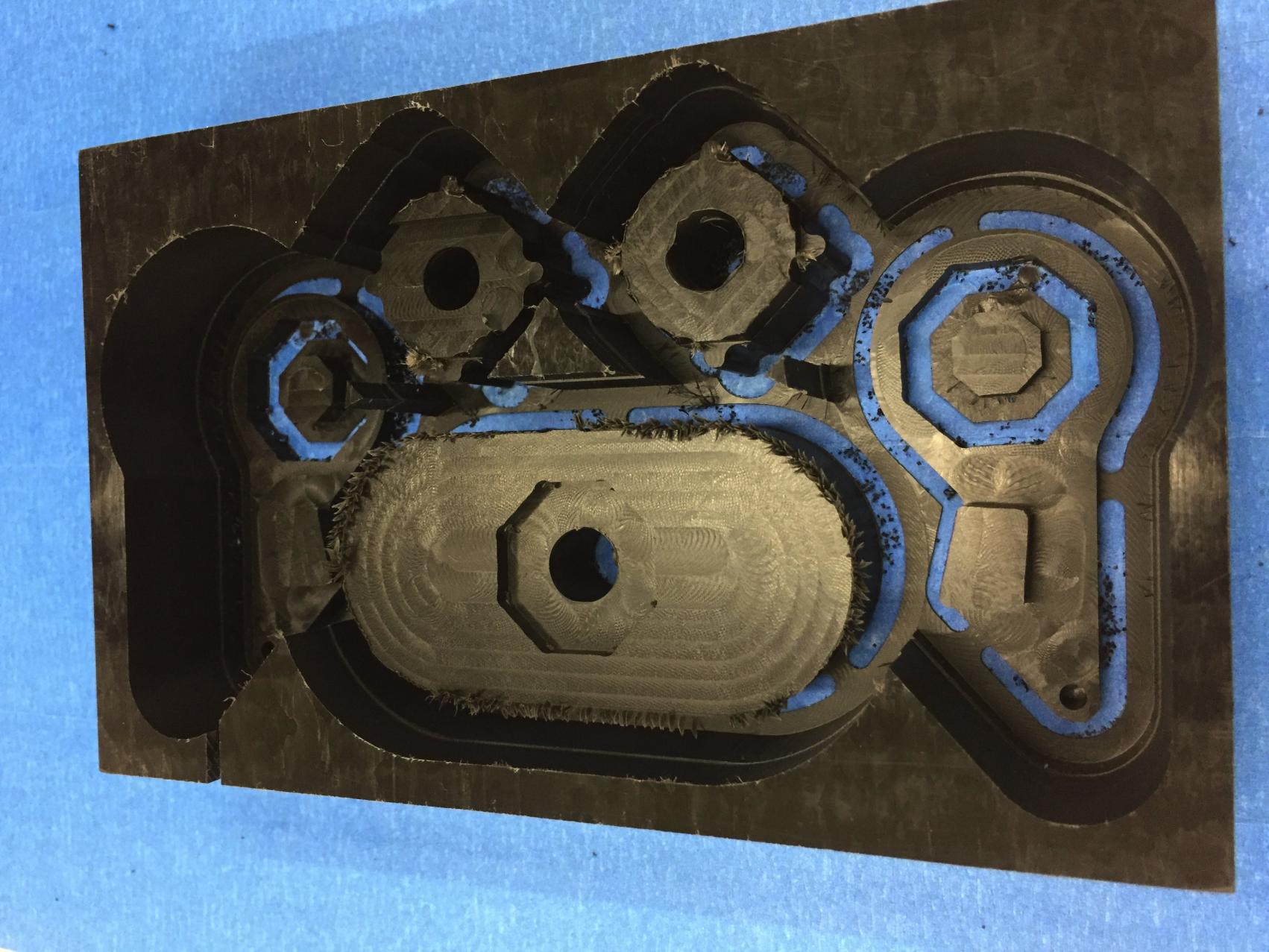

The vinyl nails SB recommends seem a little flimsy for work holding; has anyone had success with them? My experience is with manual and CNC mills, so I want to have a Kurt vise and some T-Bolts....which obviously isn't going to happen.
Festool's perforated table tops work great. I have one that was bought new when they were first released in NA. My thought was to replicate the design on an elevated spoil board to take advantage of the Z travel we have.
Any out-of-the-box ideas for work holding that have worked for you?
