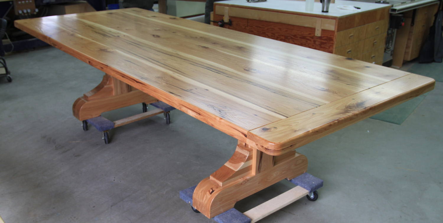

The dining table was done last year. It measures 10' long x 4' wide x 2" thick. The trestle legs are 6" square. The breadboard ends on the table were actually done using the Domino system. I've attached some pictures of the process.
The chairs were done and just delivered a week ago. 12 of them! Joinery is about 45 Dominos for each chair. The back legs and seats were cut on the Shopbot (Wally). I finished all parts with ML Campbell satin conversion varnish. I do all my finishing prior to assembly. Makes squeeze out much easier to clean up and produces a superior finish when I can finish all the parts laying flat.
This project took an order of about 700 BF of rustic hickory in a special order thru my supplier.
All in all it was a good challenge and fun projects to design, engineer and build.
Customer said it exceeded all expectations they had. Nailed it!!! :D
