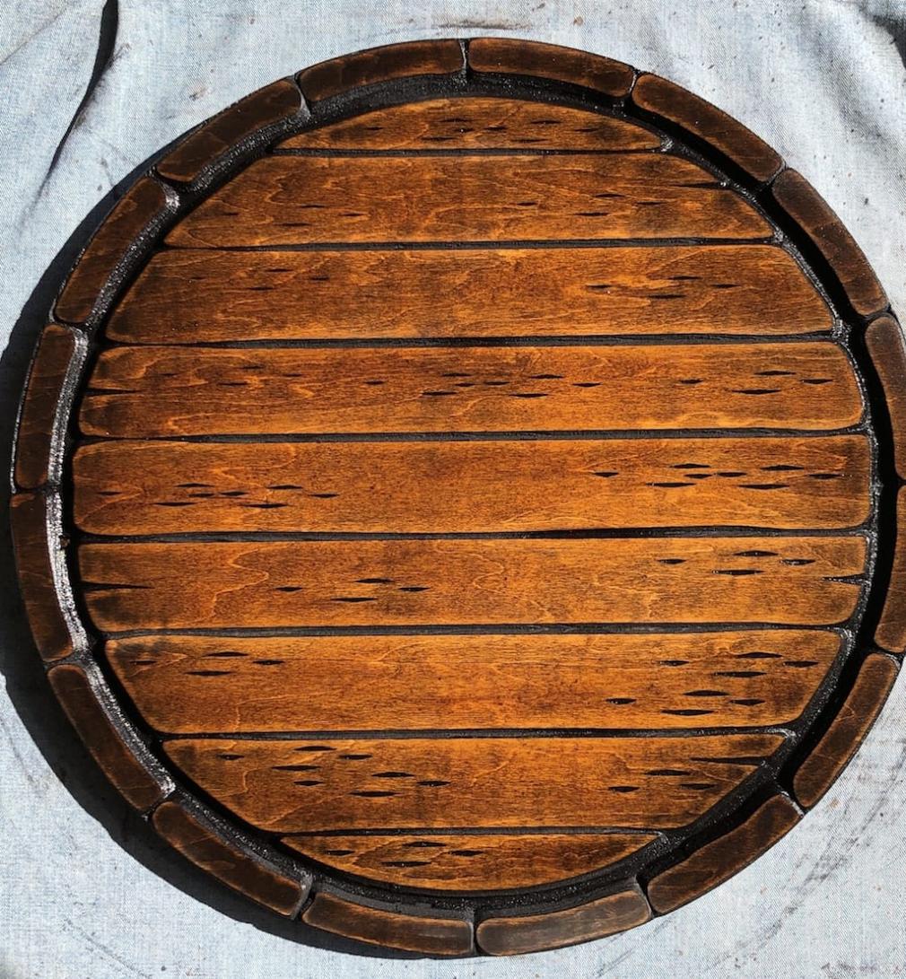

I have a customer that wants me to make the faces for this sign. this is a rendering. his customer was a barnwood look and is willing to maintain it.
but gluing barnwood onto say a piece of dibond is not a great idea. I was thinking of planing the boards down to 1/8" to make it a veneer and epoxy it onto a piece of 1/4" dibond then coat the face in epoxy then use a uv protection on that. I would also seal the edges after I cut through the face.
does thsi sound like a good idea? would I need to laminate the backside too?
