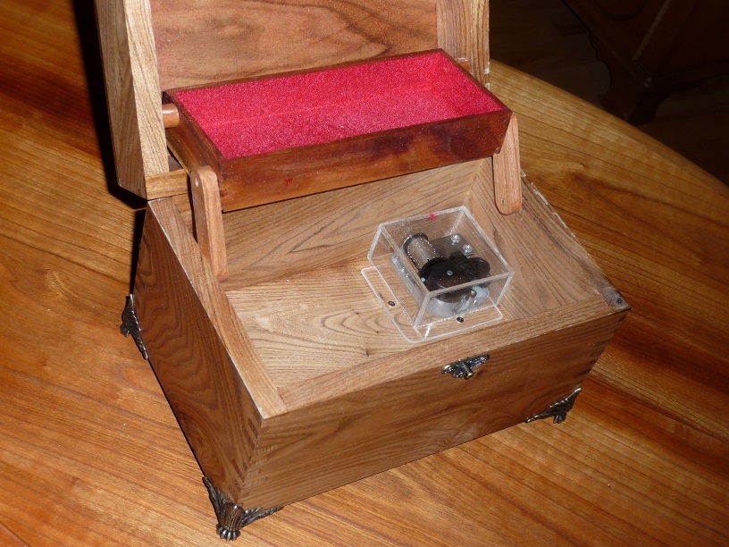

Cool. Really nice to see people working with it! I rarely get feedback..
