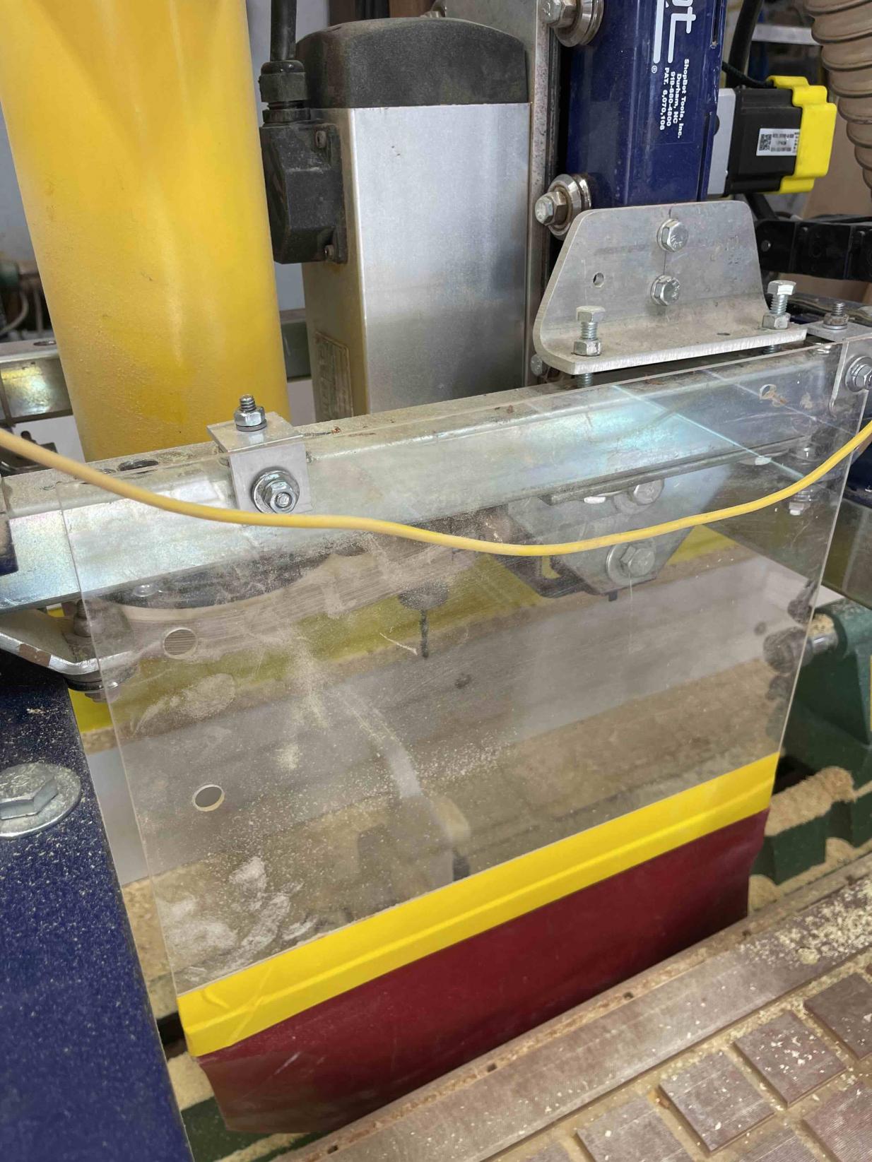

I'd like to see what people have set up for dust collection for a CNC rotary indexer.
Thanks, Phil

Inverted and mounted to the gantry with an adjustable bracket.
It follows with the gantry and hooked to any dust collector, works great.

I'm considering the same device for dust collection. Would you post a picture that shows how it is attached to the gantry?
Thanks, Phil
I gave up on dust collection on my PRT Rotary but I filled the sides and bottom where it is mounted and made a couple of shields mounted with rare earth magnets which move with the gantry. It pretty much keeps the chips confined to the trough where they are fairly easy to pick up and vacuum.
