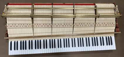

I have a c. 2015 PRS A 48x96 with a jtech photonics laser mounted on the y gantry. I also have a digitizing probe in order to make a detailed scan of piano action stacks (I make custom piano keyboards for high end concert grand pianos and colleges). The scan must be 3d and appx .05" wide by 52" long probing every 0.01". (the average length of the action stack.) This allows us to probe the exact position of the existing holes along the hammer rail. (88 holes appx every 0.5" with spaces for action brackets every 20-30 notes depending on the make and model of piano.)
However the probe ties up the shopbot for a appx 8-12 hours depending on the size piano. Normally this isnt an issue because we set the probe to do its thing overnight and analyze the scan the next morning. However, about 1/4 of the probes are failures for one reason or another and we must restart the probe during working hours. This is a problem if our production schedule requires the shopbot for milling, drilling, or lasering that day.
