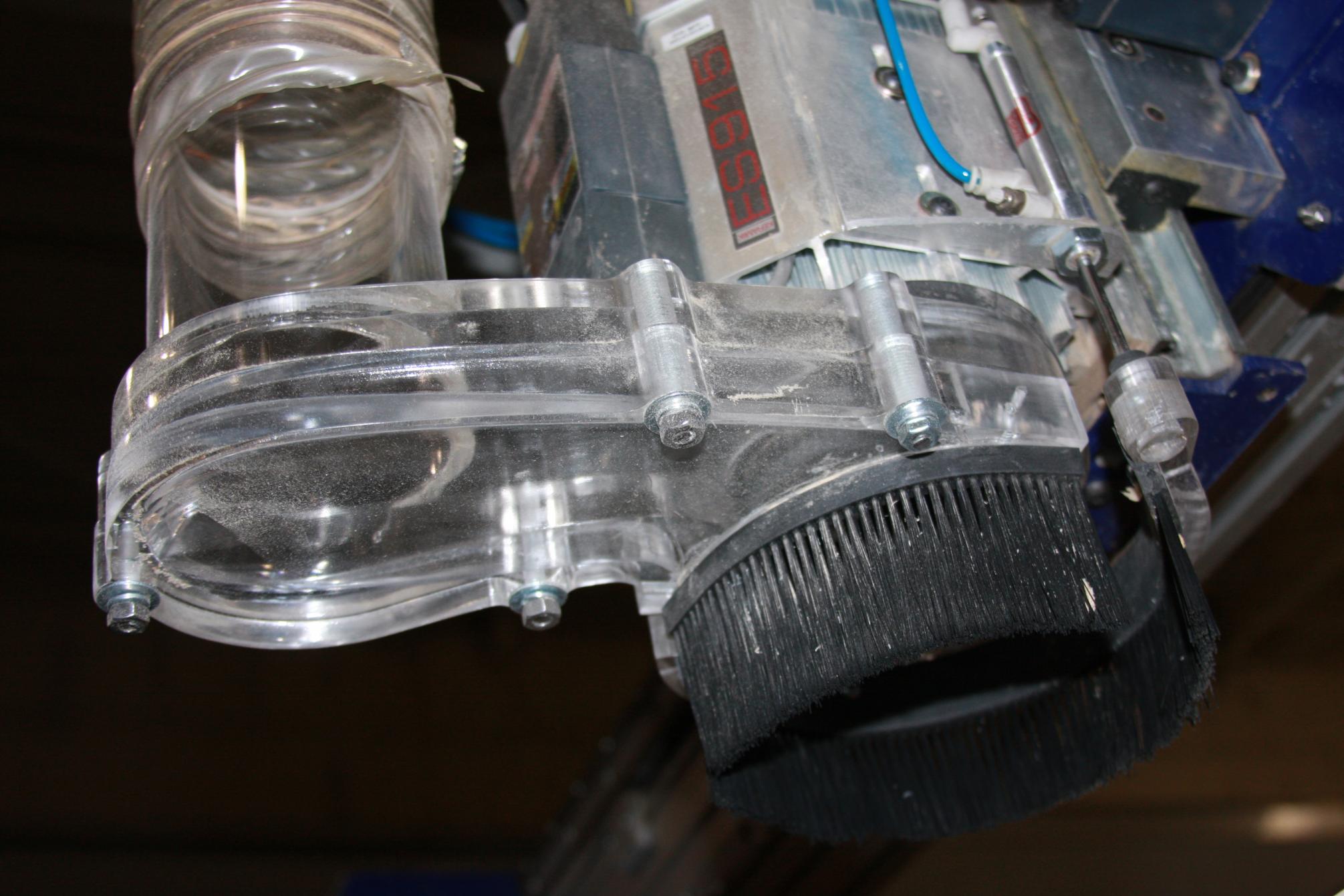

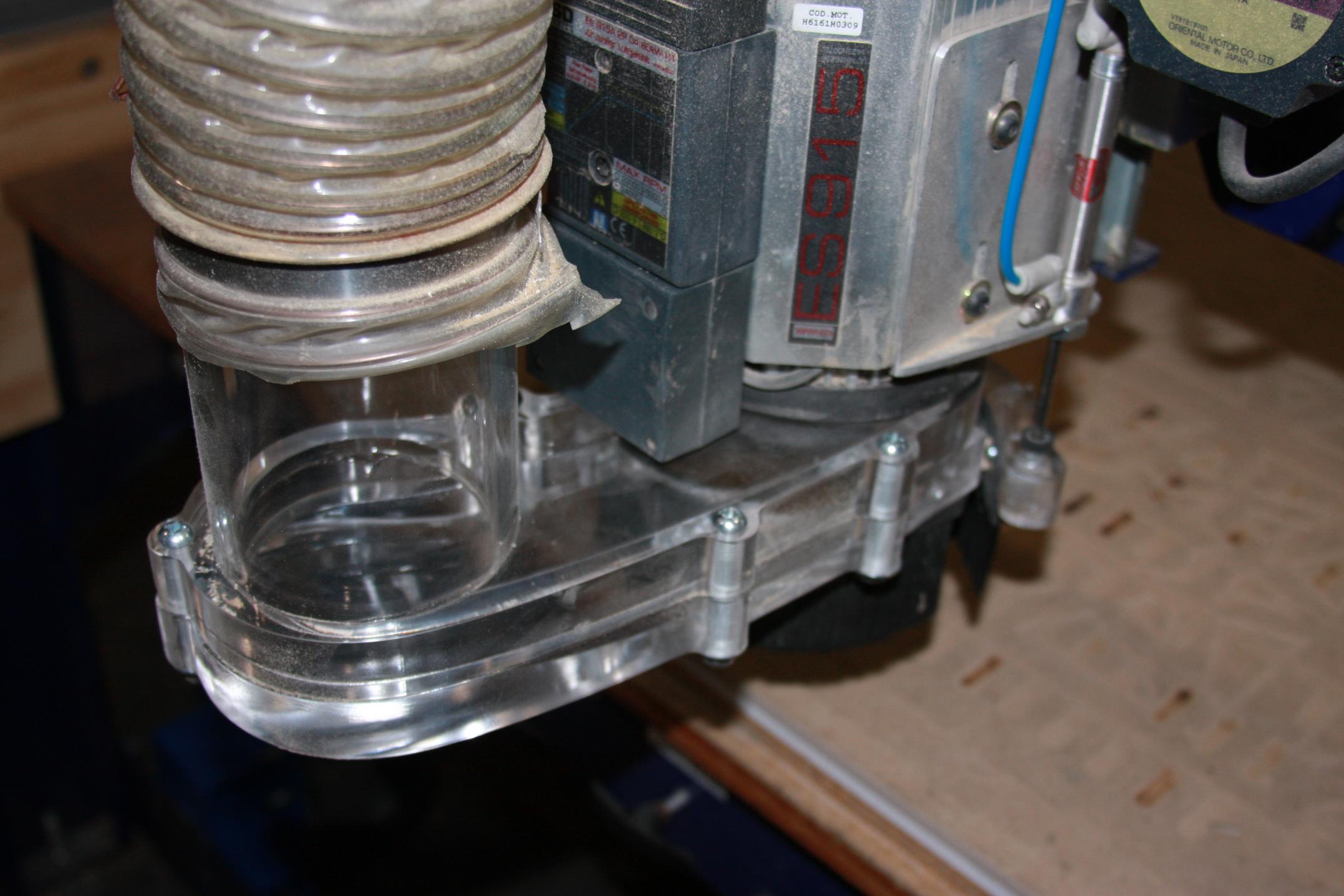

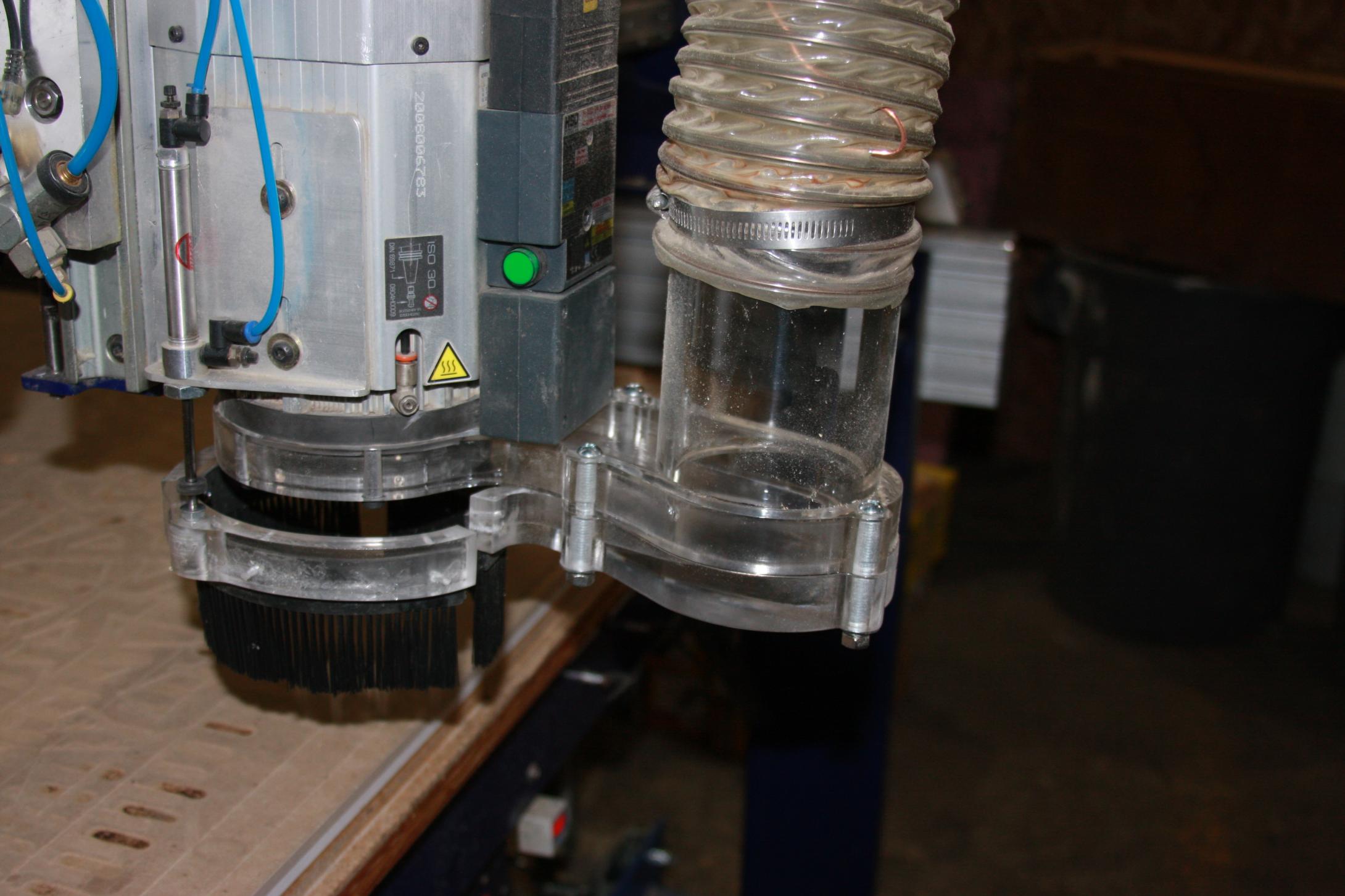

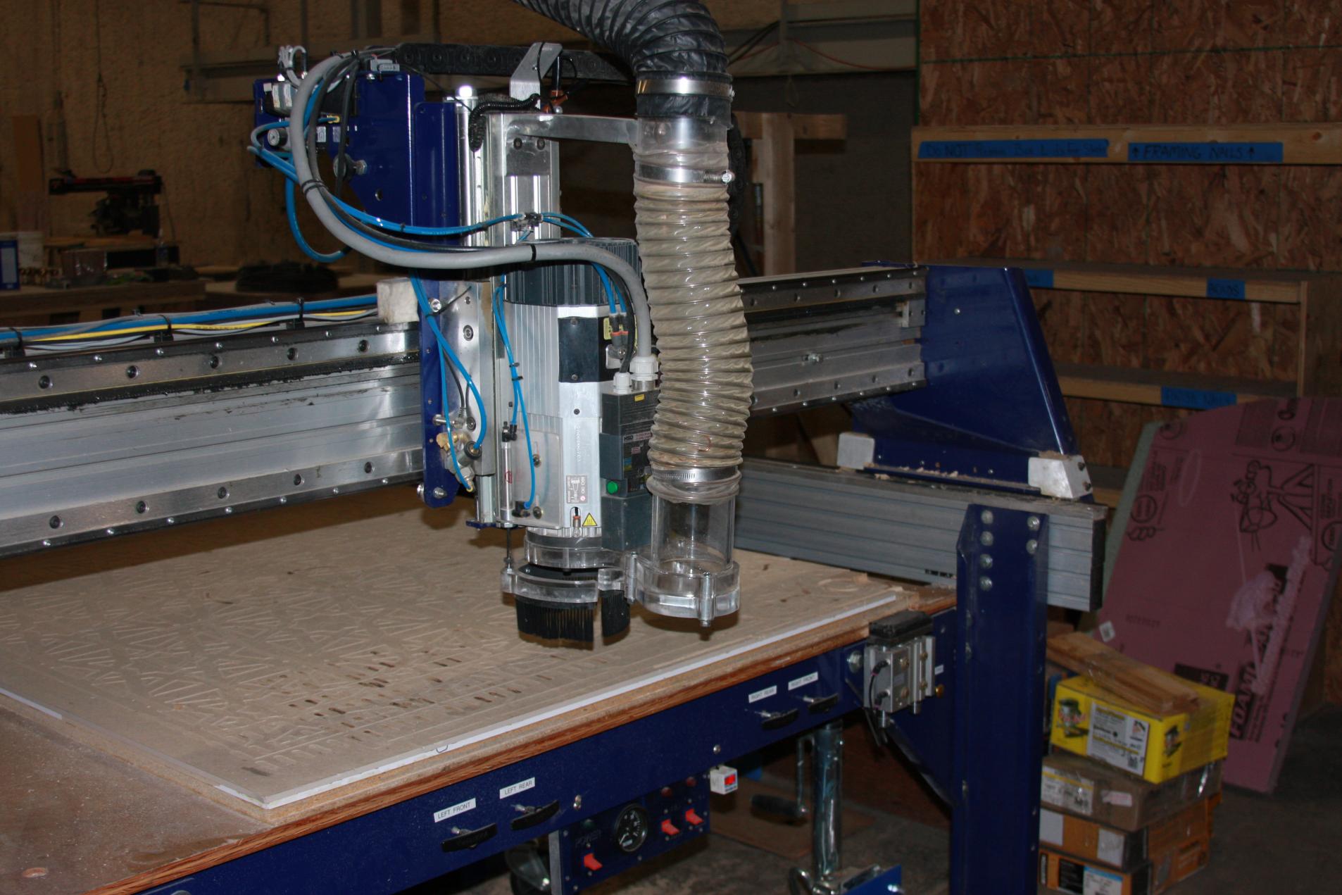

    Hi All,
    Made a new dust shroud for a PRS Alpha with tool changer. Cut from 1" plexi- comprised of four separate pieces. Flame polished the plexi post cut - although I was impressed with how well it cut and finished the acrylic from just the bit. Overall I was happy with the turn out so I thought I would share.
    Let me know what you think!

    Sure looks pretty! How does it perform when cutting MDF? And who did you use as your brush source?

    I have yet to cut any mdf since I put it on. However, I will be cutting some this week so I will let you know. - i'm curious myself. Also, I ordered the skirt from McMaster-Carr.

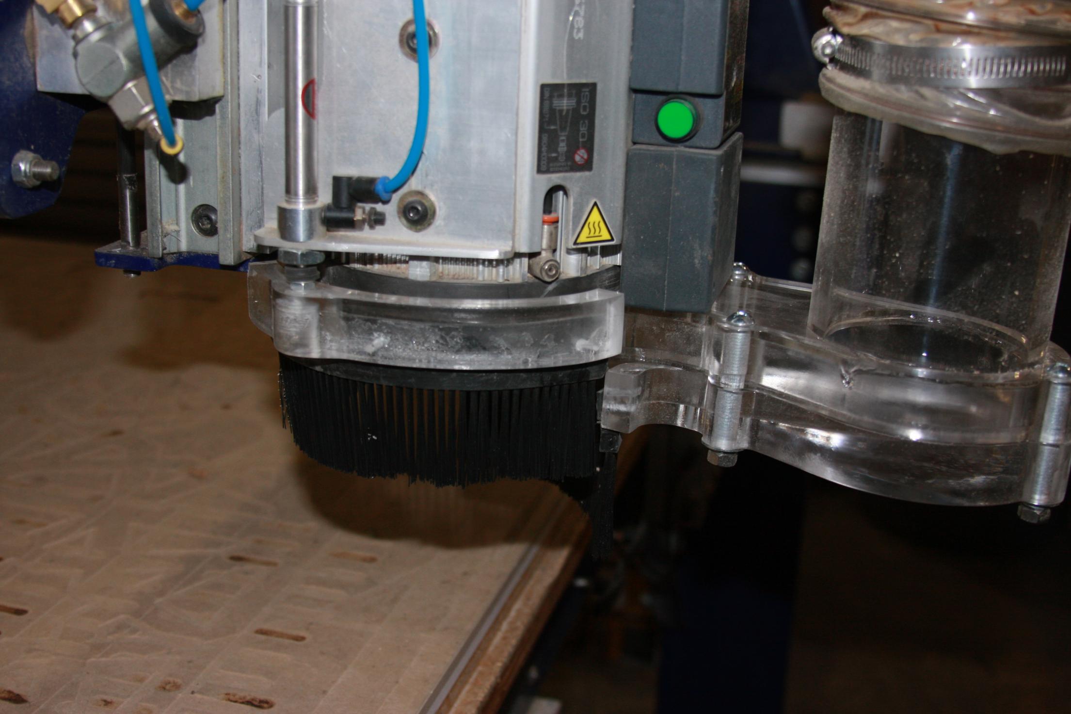

    Cody, picture #5 shows a Alum Block/Bracket on each side of the X axis Truck and they look like something you made to cover the rollers.
    Could you elaborate on them?

    Hi,George
    I believe you are referring to the felt track sweeps/lubricators.
    There are 4 on the gantry gussets one on each side of the gusset
    that clean and lube the x track. Also there are 2 on the y axis track ,
    we spray wd-40 on the top of the felt daily, it works its way thru the felt
    to lubricate the track. Not sure if this a shopbot feature as we purchased
    this machine from Master Gary C. and he had many special ingenious add ons.
    It may pay to contact Gary and ask him but i would be happy to take pictures
    of them the next time I'm in the shop.

    Your very lucky to get a machine that Gary has had, I like the dust shroud, looks very neat.

    Great job on the dust shroud! Dare I ask why you needed a new one?

    Here is an earlier post with more info: http://www.talkshopbot.com/forum/showthread.php?t=11114

    Gary,
    I accidentally broke the original because I killed the power without realizing the air had been disconnected. As a result, gravity took over and the dust shroud couldn't take the impact- breaking a large piece off the side.
    lesson learned
