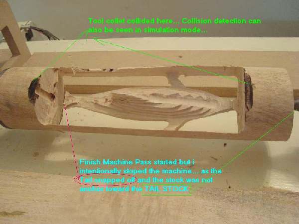

    Today I did Dolphin Model on my Indexer.. I created toolpath and did rough machining only... You can see something bad happened at the end of rough machining toolpath.. Basically the tail of the dolphin was very thin and i modeled the end anchors in a very bad way.. The Tail of dolphin snapped off due to bad supports...Also The tool was a little short and collet strikes with the stock, this collision is also detected by the software simulation...
    Although My Dolphin was ruined but It was my first experience with the software.. Next time i will do complete A-axis machining and post here..

    Here is the roughing operation...
    7,832
    What program are you using that gave you a collision detection simulation? And now knowing that you will have that collision couldn't you take that area of collision and do a rough cut toolpath to eliminate it before you do your main rough cut toolpath on your model?

    I am idiot ...Lot of mistakes in this single Model that i created in Visual Mill (Used this software for the first time for my indexer/A-axis)...
    1- I simulated the Model after machining it on my router
    (Me fooool)
    2-I generated the toolpath for only climb milling (Tool cut only in one direction)... This increase the cut time twice.. I must select the MIXED direction (conventional+climb Milling) so that the tool remove the material in both direction of its To and fro motion...
    I learned some lessons from this part and this is my experience. My next part will be perfect.. sometime I learn from others mistakes and most of the time i get experience from my own own mistakes ;) ..
