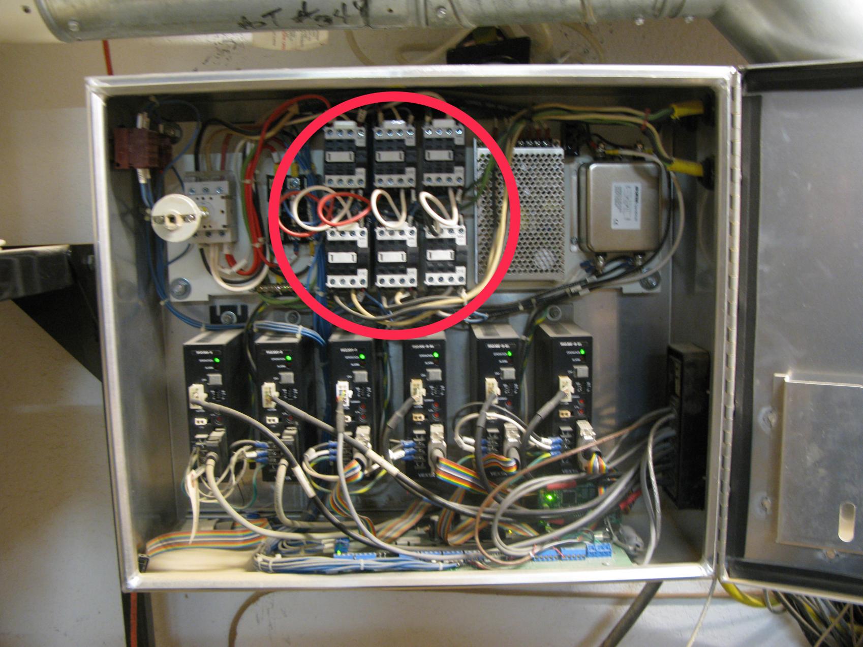

    Hey all,
    I came in to work this am and was going to move the table and take off the sheet of color core to find out that my drivers will not reset. I did notice yesterday that I was getting more than normal comm errors in between toolpaths and tool changes. I checked both stop button to make sure they was not stuck. restarted computer. restarted shopbot but i am still unable to reset the drivers. Fan on the spindle is on and proxxy swithces are lit up but the control box does not have a readout on display. any help would be greatly appreciated!!.
    Forgot to meantion this is a Alpha machine
    thanks in advance!!

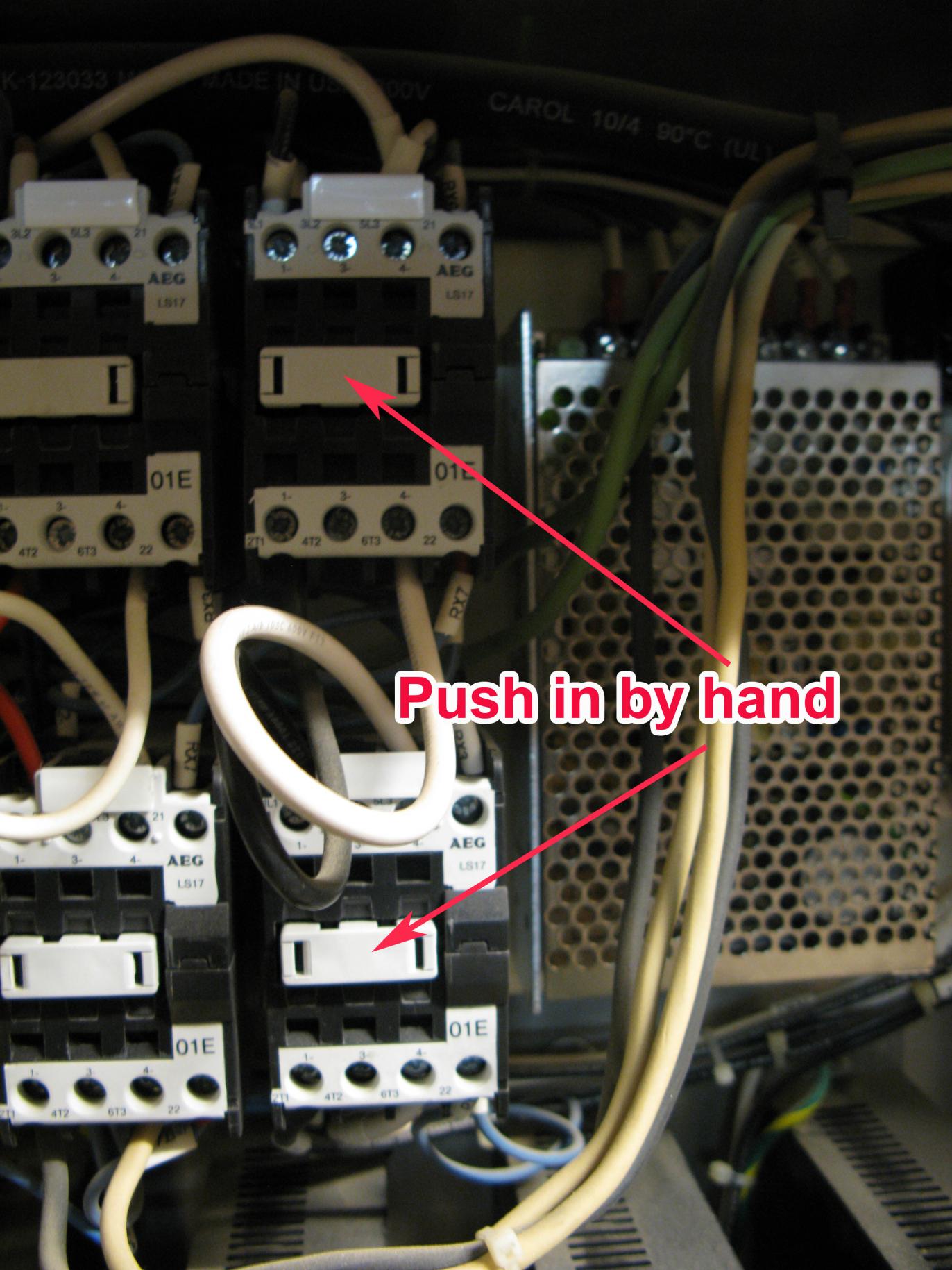

    If you have the older style contactors in the control box, have you tried pushing them in by hand?

    would I have to open up the control box in order to do this? if you could be a little more specific on the contactors i can attempt it.
    thanks again
    7,971
    Yes - You will want to turn on the power and IF you have the 4 contactors with grey rectangular center 'buttons' push them in until they magnetically 'stick'.
    Call SB Support - they can help you.

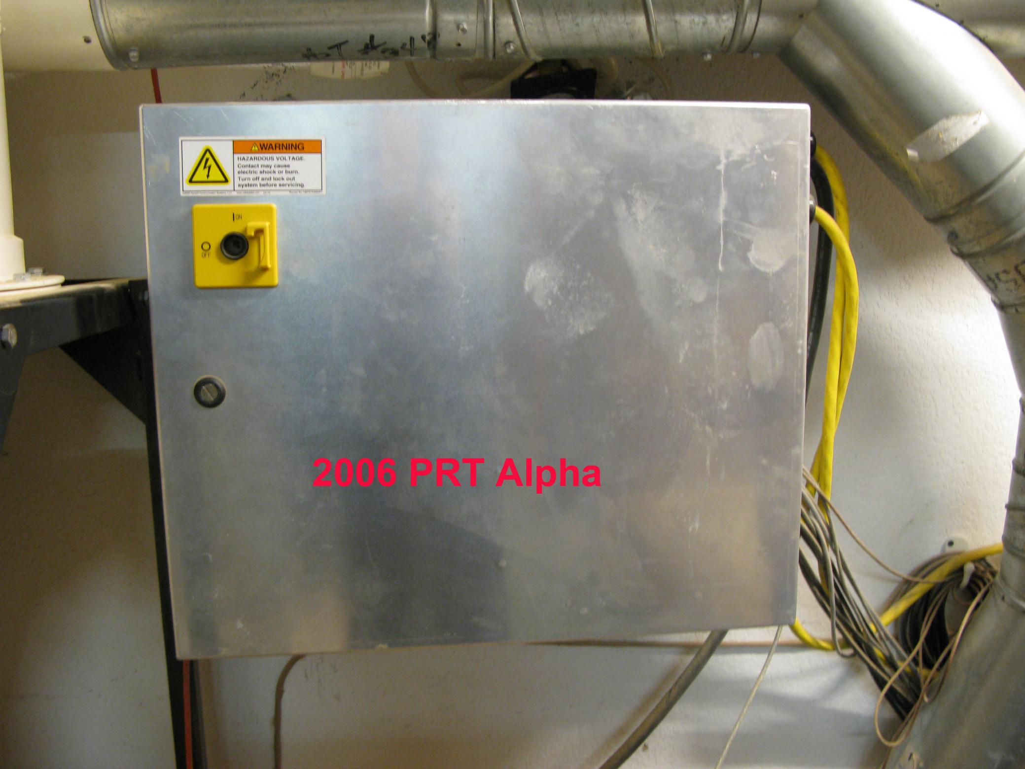

    2006 era PRT Alpha...

    Thumbs up thanks steve for the pics
    I ended up talking to shopbot on the phone and they walked me through it. Come to find out it was the buttons in the stop box were loose. I was able to take the stop box apart and wiggle the buttons and find the problem.
