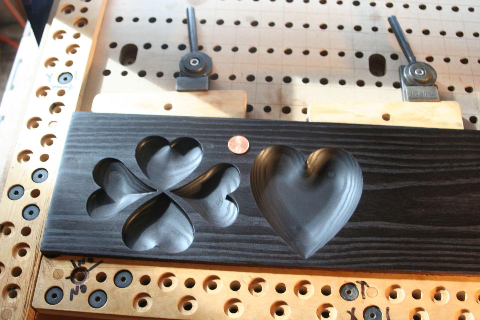

  7. #57
    Jul 2020
    3
    Finally!
    As a new Shopbot owner I have lots to learn..
    Thanks to Scott P. and his files my shopbot has a great holding jig set up - and it works well!
    Big thanks and happy holidays
    Vera
  8. #58
    4,380
    Looks like you owe more to Bill Young than me Vera
    Had a lot of open tabs on threaded inserts and the advantages, but power outage and Christmas deadlines(and being lazy) lost them and didn't repost.
    Will elucidate more on inserts, as Kyle Stapleton(teacher) had problems with just dowels.
    Deformation of dowels and holes fairly quickly made all 90 degree wedges lift material or loosen while cutting(vibration and cutting force) if I remember right.
    Will add a fair amount more and how to mod your spoilboard after deadlines are done.
    Inserts make a Lot of difference....and you can still do
    Enjoy your holidays Vera!!
    Thank you!
    JUST got 400 inserts and one Winter project is to make a better HDO spoilboard substrate, with epoxied MDF cutting area to avoid my perpetual humidity change issues.
