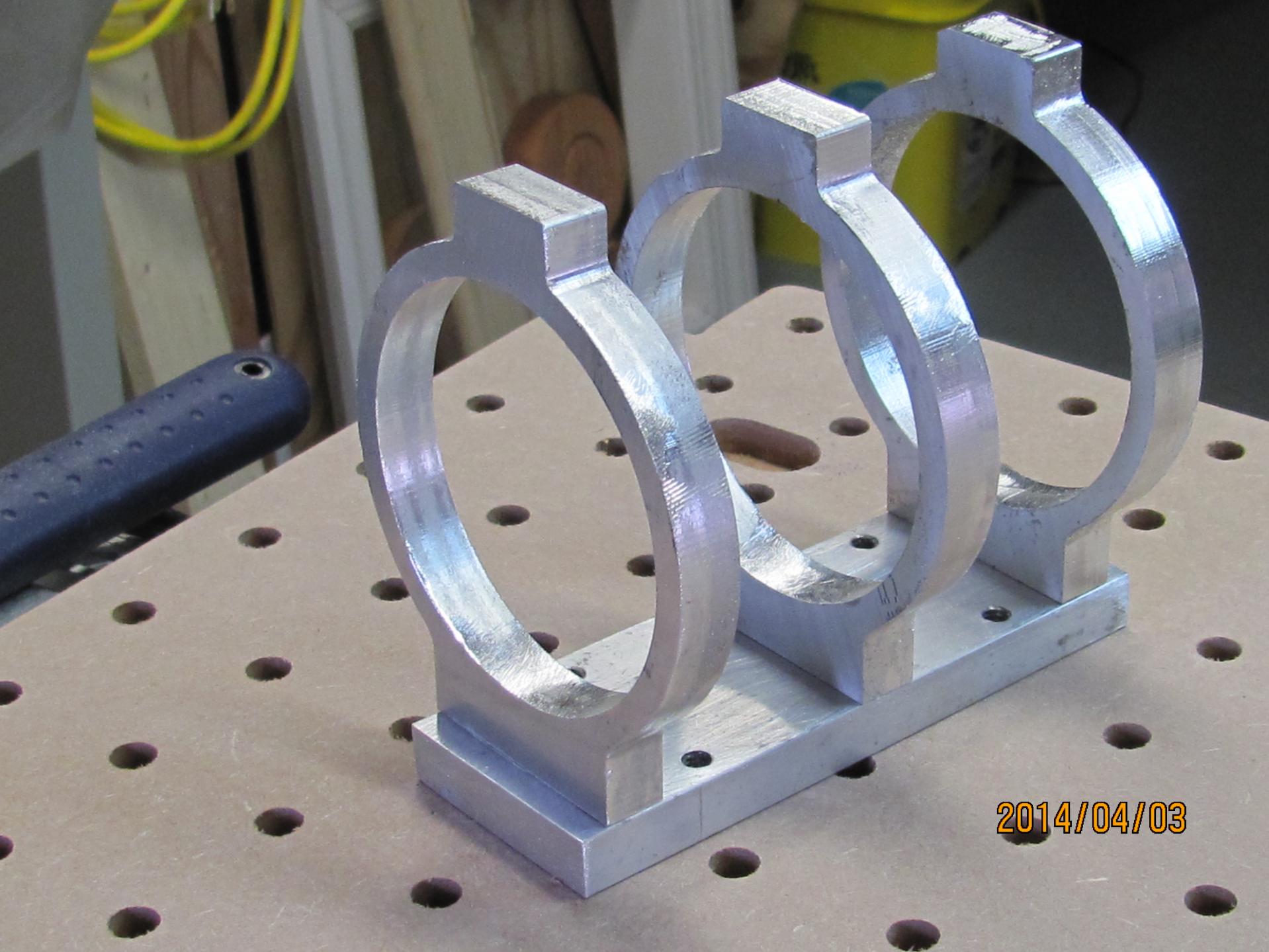

    I cut the Wedging top that Bill Young Posted , as I needed to hold some .5" aluminum for my spindle mount for the DT ( made a temp one so I could use the DT ) as I had a spare spindle at the shop
    Today I cut the parts for the mount , still need to drill and tap the parts
    speed 1" per sec ,step .0025 with a 1/4" up cut bit

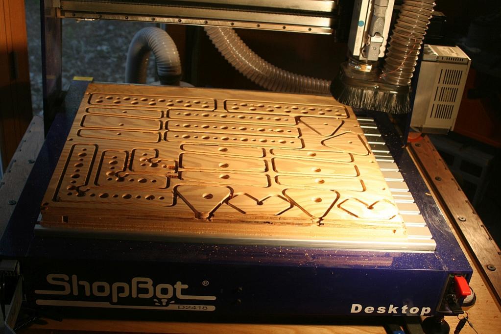

    Thanks for the pics Bob, Going Bill's top but with threaded inserts for cam clamps and fences, and job specific vac jig. Nice to see your set-up.

    Added threaded inserts to Bill Y's wedging top so I can use Shopfox and other clamps. Also added counter bored insert holes in wedges and fences for allen head bolts or Adrians nylon head bolts so I can keep safe Z at .2"--If they work well, will recut in maple or BB ply. Will install today. Thanks all.
