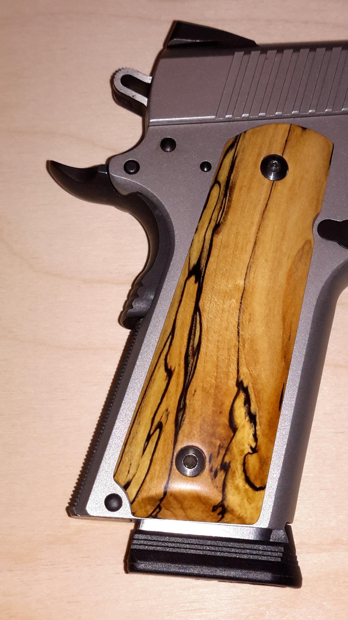

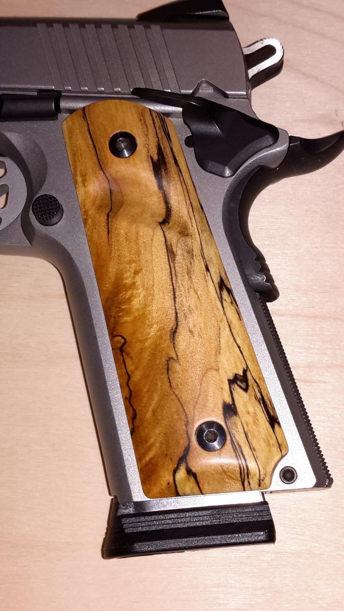

    Here's another try at the spalted maple grips. These turned out real nice. Also, a couple pair of quilted maple ones ( @ Scott P). They were book matched, but due to the way the grain changed or faded off as the model was revealed, they would have looked better if the pairs were swapped.
    A couple of coats of Danish oil to soak in and give them some depth, followed by 6 coats of Tru-Oil with a final rub out with 0000 steel wool loaded with some carnauba wax and then buffed out. The pictures really don't do them justice, as the chatoyance really goes deep and moves when tilted.
  9. #29
    4,420
    Spalted turned out GREAT See what you mean, the 2 darkers should be together. Photographing that stuff is as hard as opal. Looks great finished!
