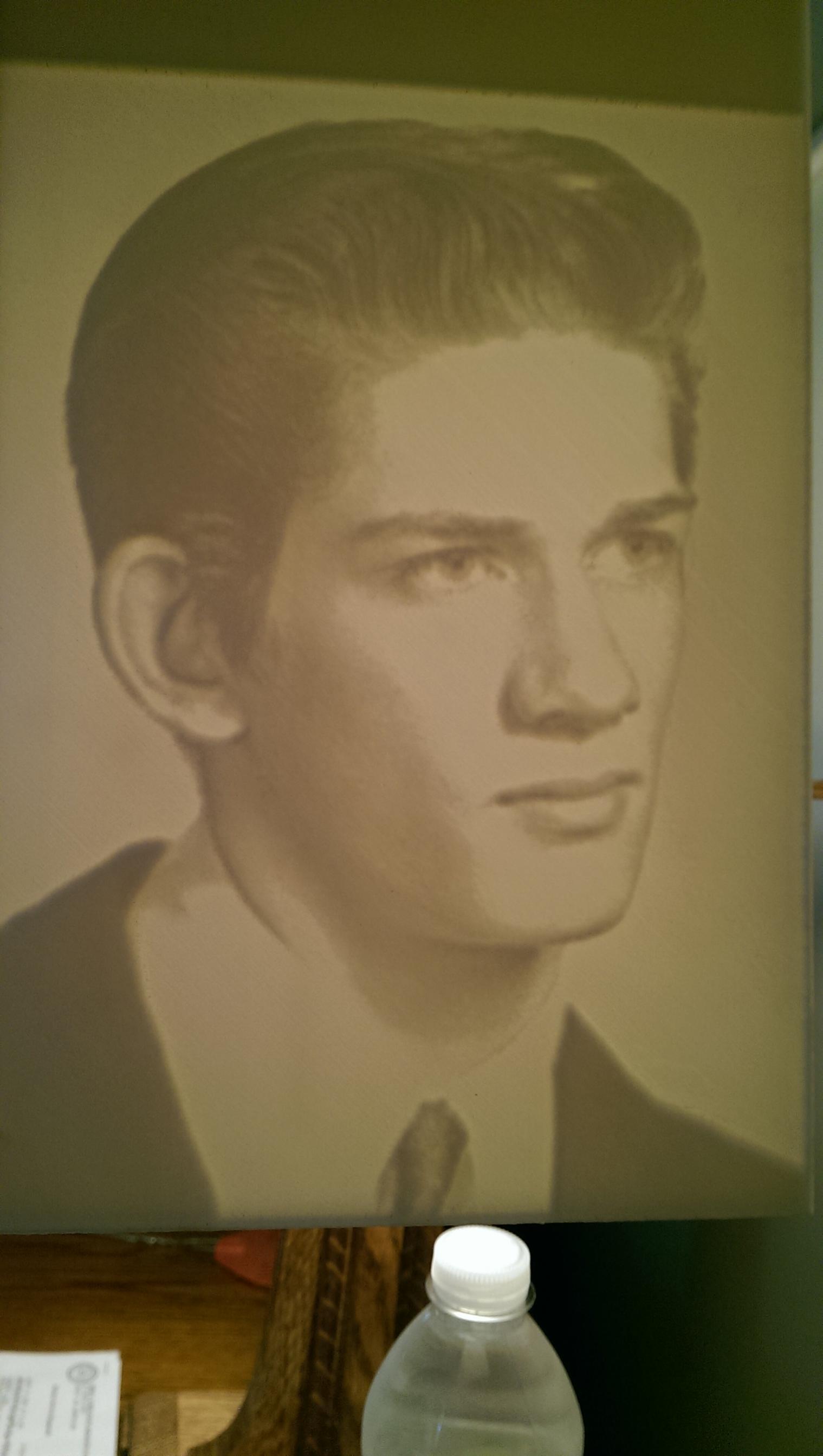

    new litho yesterday . Not framed yet just holding up in front of light bulb . Just got to figure out how to do this well on wood

    I'm just thinking outloud, have never tried this but....
    Take your litho file, save it as a stl, then take it into your favorite 3d program and carefully trace around the different parts like the hair, forehead, nose, lips, cheeks, ect and make each one a separate object and save them separately and call them up and assign differing Z heights and sculpt them to give them the right shapes. Hope i explained it correctly. Again not sure if this works...just thinking outloud

    Jack very interesting thoughts and I welcome all thoughts and help I just need to get caught up gather my patience and dedicate a whole day or two and get this figured out this is the picture I'am supposed to use on the memorial plaque for our family members . This was just to inspire me . thanks Jeff

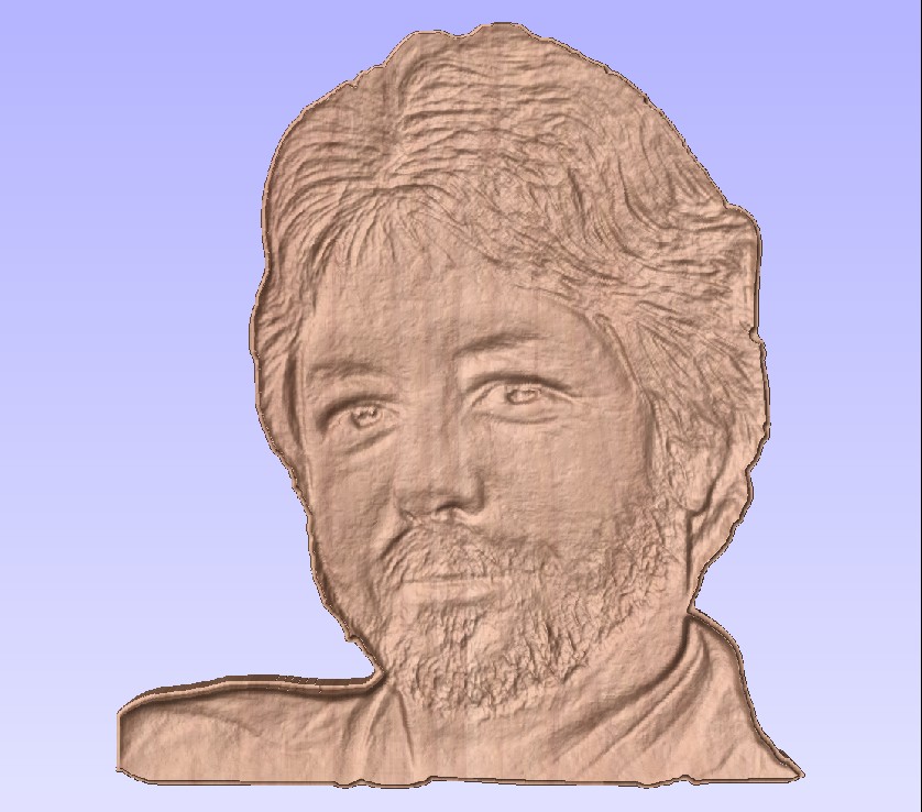

    Hi Jeff,
    I'm not sure which software you are using, but here's what I did in Aspire.
    Here's the first one I tried, when I first got Aspire. I simply imported a bitmap, create component from bitmap, did a small bit of smoothing and sculpting, then generated the toolpaths.
    Not great, by any means, but might be a start.
