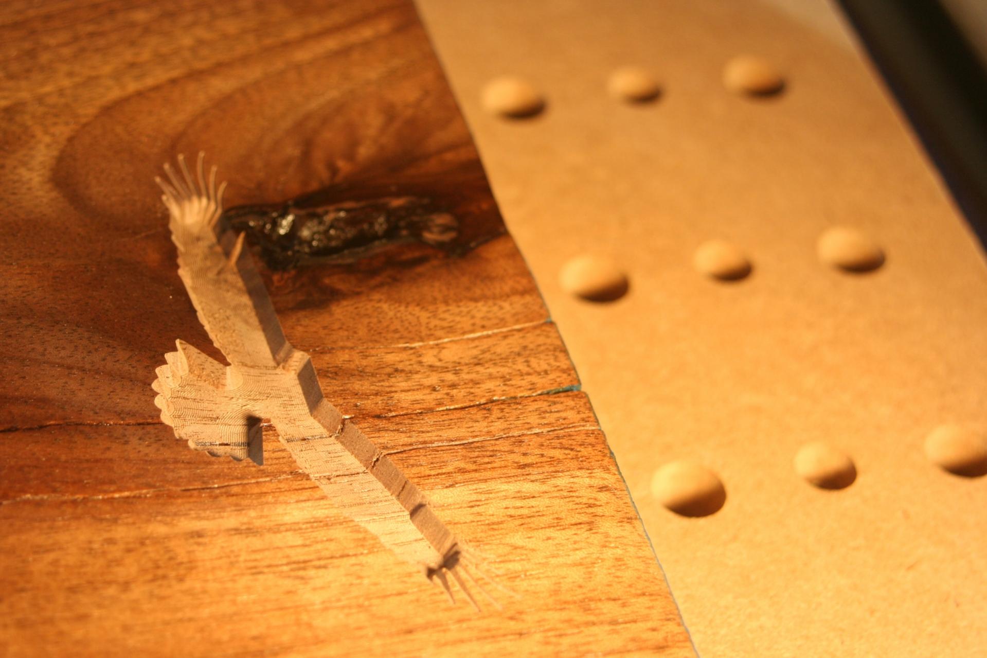

    First try of Paul Z's VInlay technique, lost parts of 2 pinion feathers on right side because of wood movement. VERY nice technique. Pocket .1" 1.1" width

    That looks great Scott. Was the wood movement due to the double-sided tape?
    4,420
    Thanks guys, No Steve, there are 3 cracks on the board(1 is 16") and I was told to use scrap the first few times. I'd CA'd the board the day before and clamped overnight. Was also told to do everything in the same day, didn't notice anything when surfacing, but over the course of the day it got 30degrees hotter and 20% more humid and it cupped and cracked the CA in the big gap. That meant the harder I clamped it-the shorter the distance between the wingtips. Anyways, second vulture is ready to be unclamped and surfaced. Bloodwood button scrap this time. Wish I had aligned the grain better.

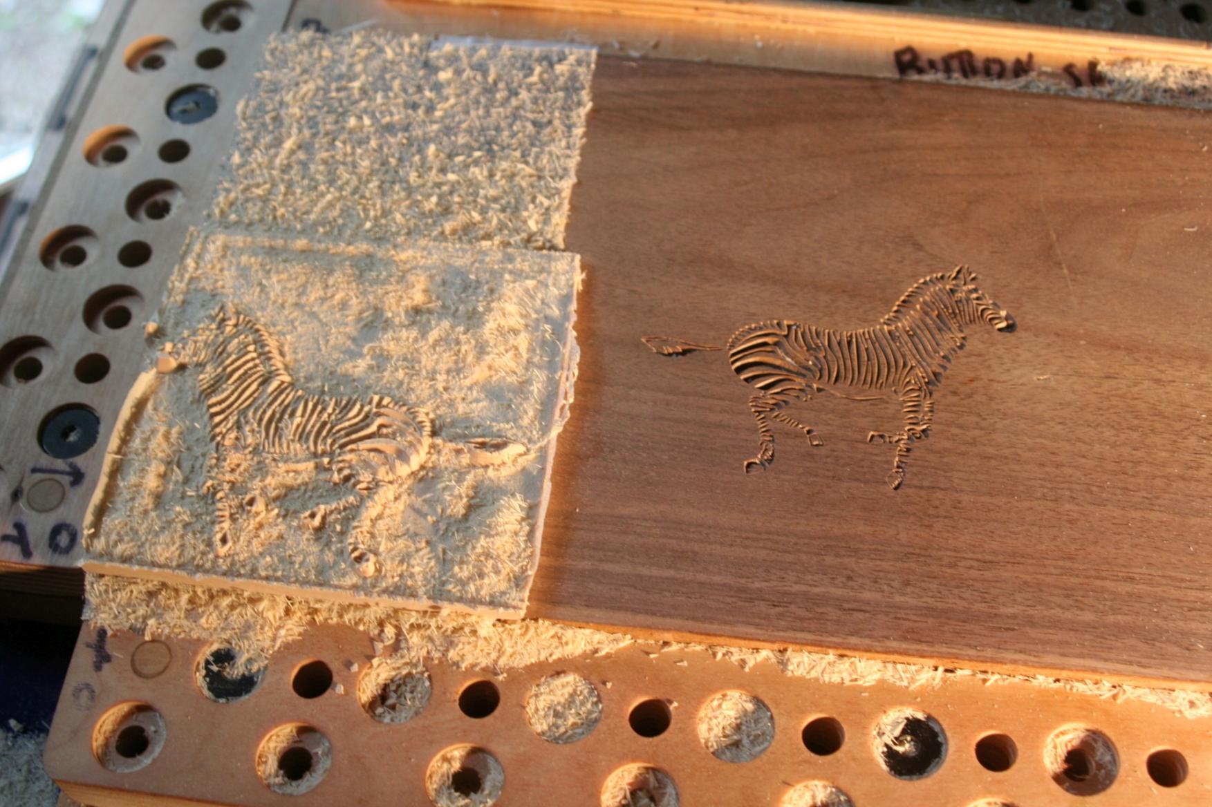

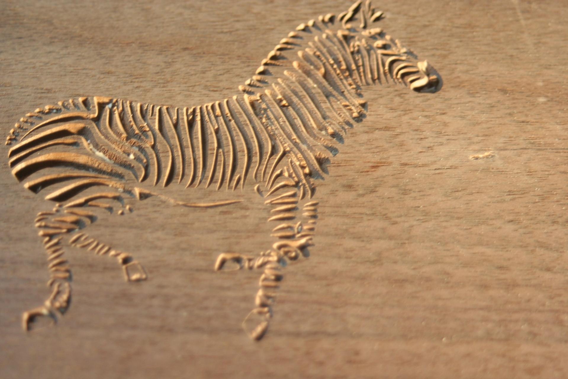

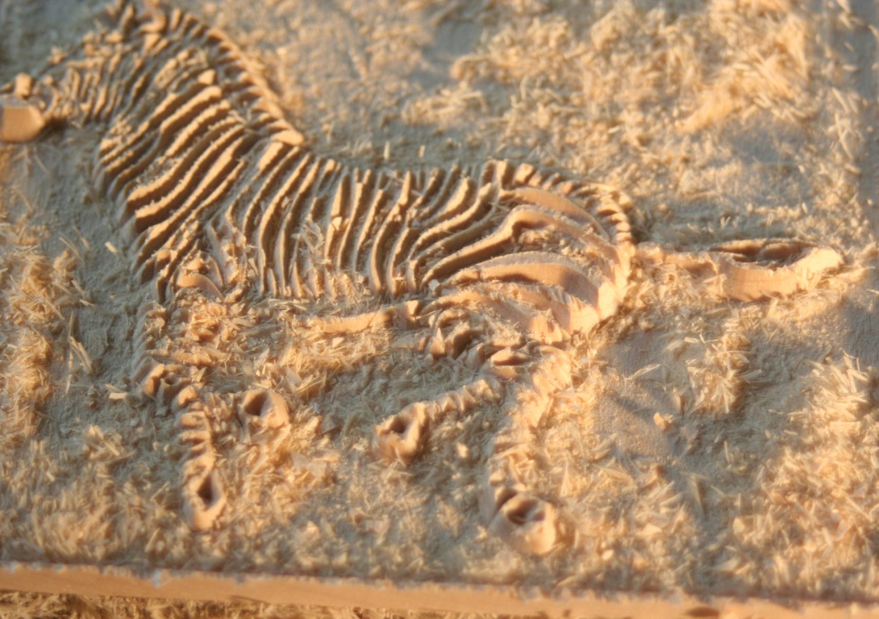

    Pretty slick method. Dad and I got maybe 2 ambitious this morning, going out to clean up and glue the Zebra now. Good example of Hard Maple "Fuzzies" after first pass I was looking at it after first pass and thought "What are you Scott--NUTS?". Zebra 3.5" wide in same board as the "Vultures".
    3 passes now and looks doable after I touch it up a little.

    Monty, Zebra is just coming out and Dad had to leave Just as legs are showing.
    He wanted pics, sooo. Got to run.
