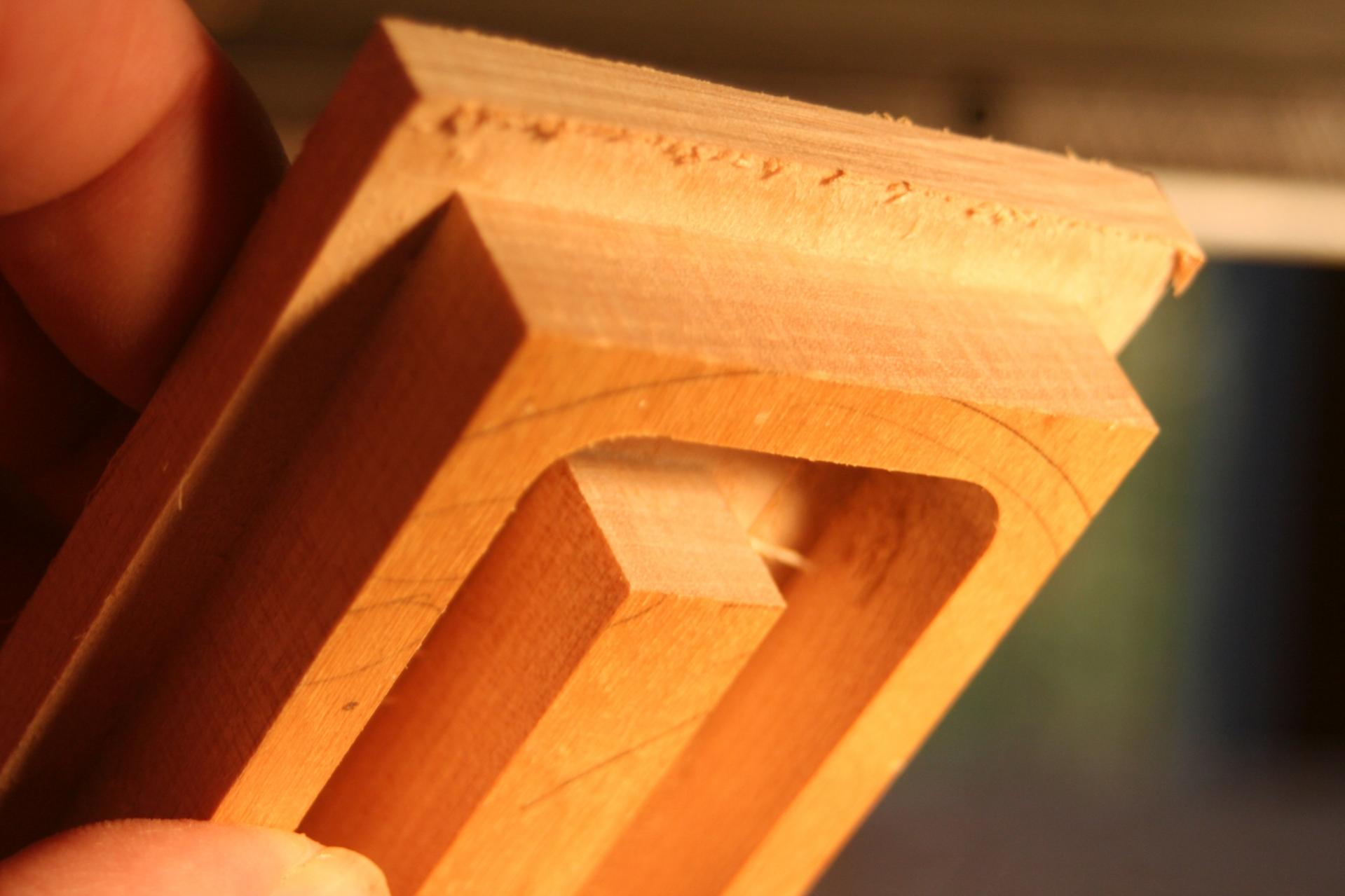

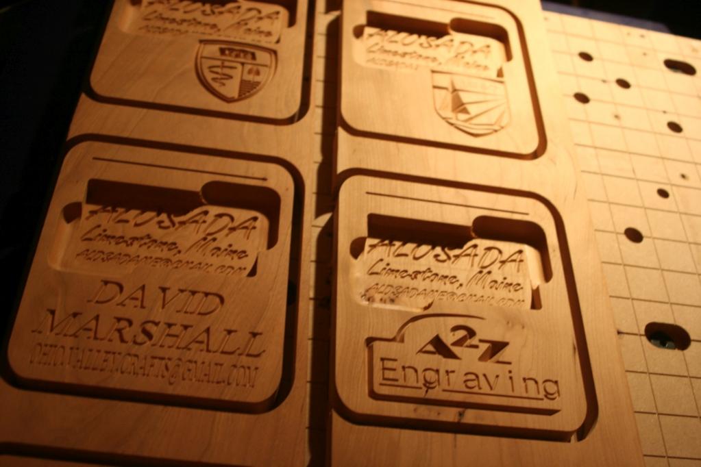

    Justin, a bit under the weather here, so hoped somebody else would kick in, but hate to see a first post unanswered. Grainasalt please.
    First thought is to use the same 1/4" Downcut using a machine allowance on the profile cut of about .015", and the copying the toolpath and setting 0 allowance and setting pass depth for a full depth pass.
    Sometimes you can simply set "last pass" depth to something silly like .0001" and last path only lets the bit get away from any cutting forces and will clean up pass cuts. Experiment!
    Might recommend using a "backer board" dimensioned to an exact height and then using a "transfer/masking tape---Carpet tape--and the transfer/masking tape again" to make a sandwich that cleans up easily. Can't find the "triple tape" link from Brady and Russell
    1/4" down Onsrud OR Centurion 1/4" down fem work great for the three woods you mentioned, Spiral ramp seems to leave the least cleanup.
    Make sure you make the tabs thin enough for the bearing to clean up totally and not have bearing hit tab at ALL for the radius finish.
    Play with it a bit. Small, fast, light(1/2 diameter) passes seem to give the least sanding finishes. Haven't done comparable cuts in 6 months so listen to other opinions please.
    Sorry I hadn't taken more relevant pics.
    Hope it helped.
