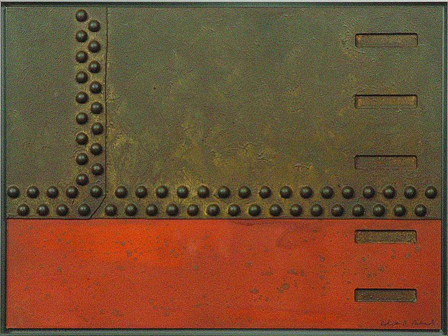

    I've just begun experimenting with Sintra and am happy with the results. Here is a photo of my first try.
