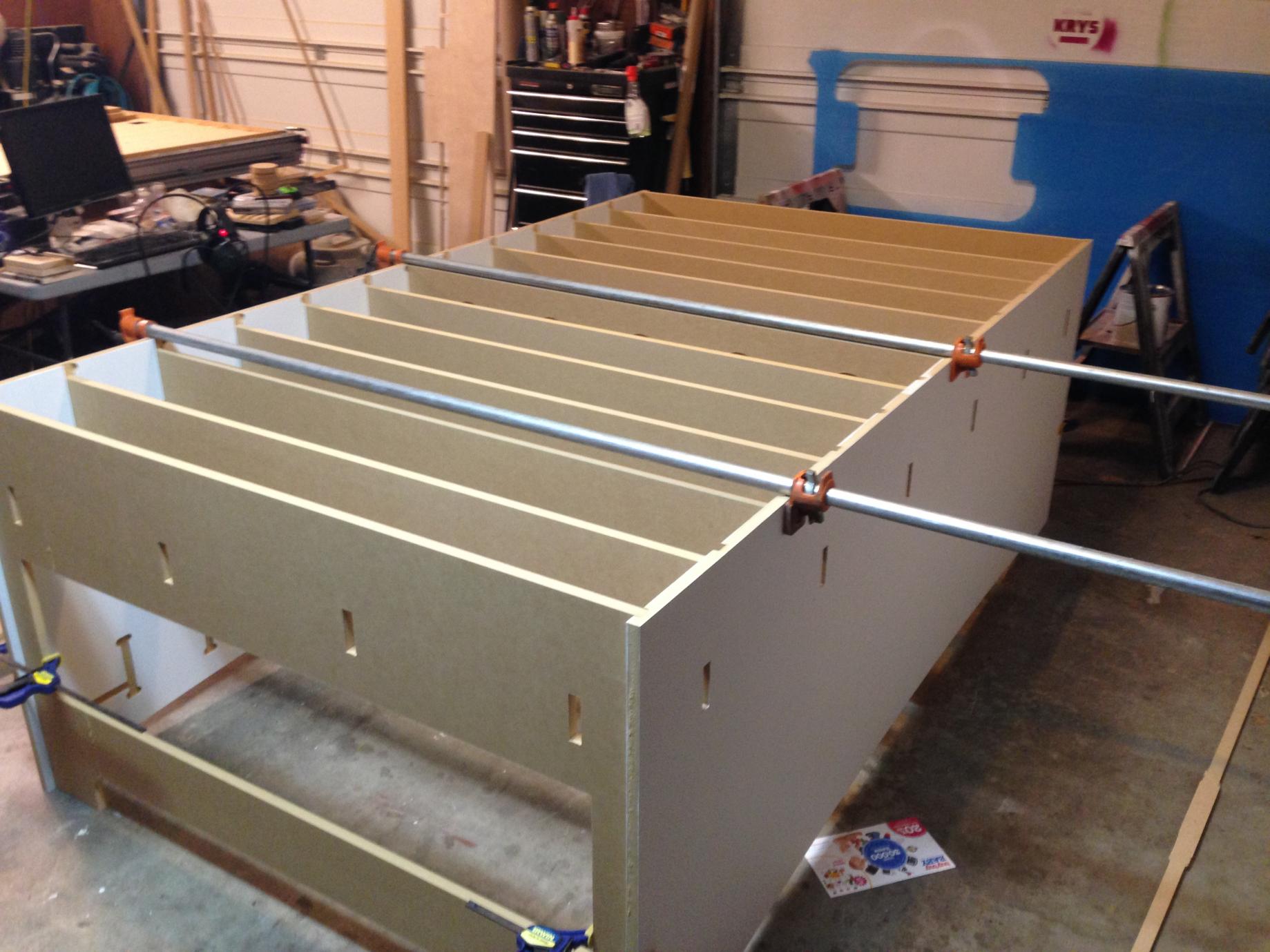

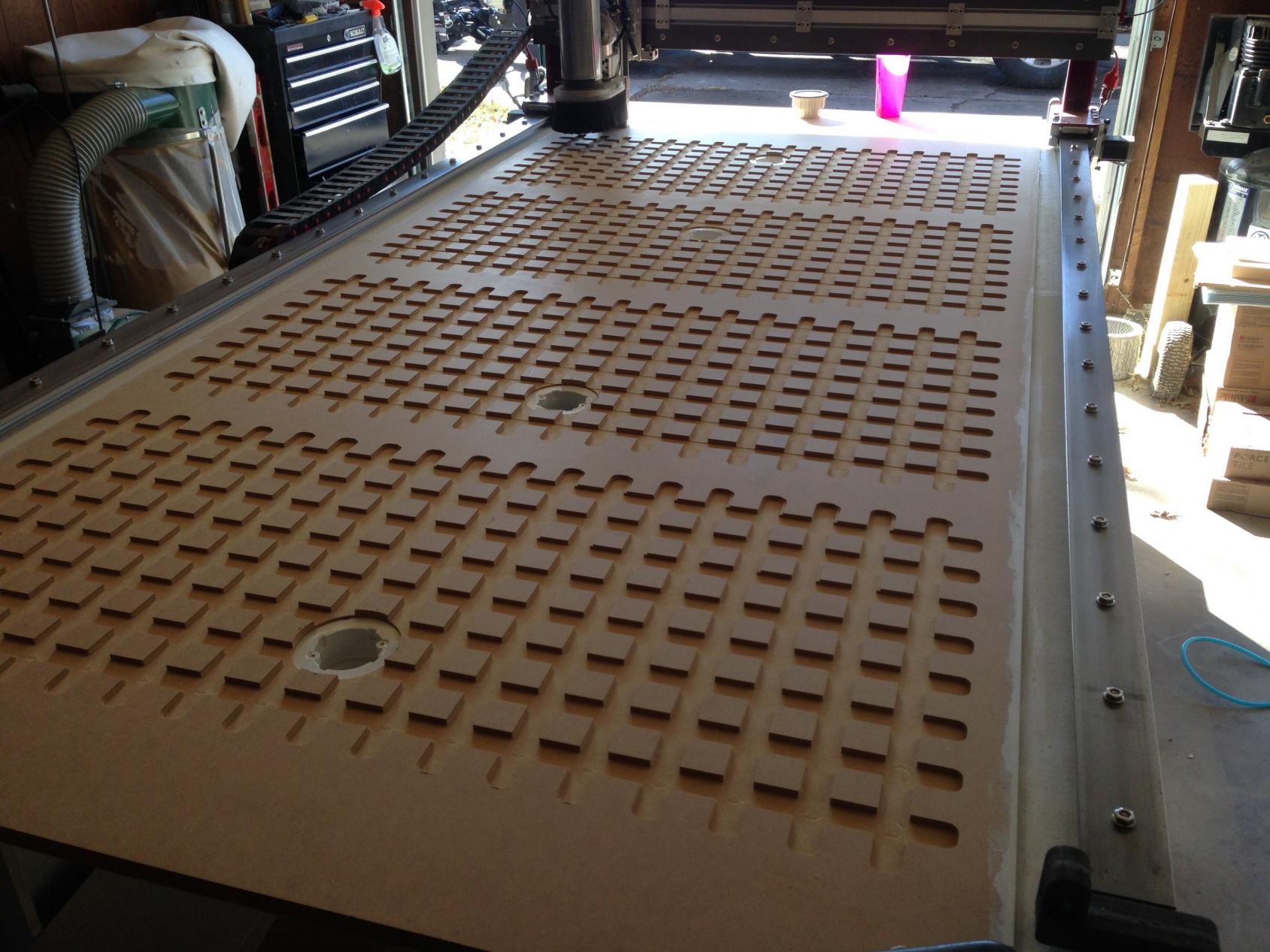

    Around Christmas I decided that I needed to update my machine to incorporate a vacuum hold down. I just got tired of screwing everything down and all of the inconsistencies that come with screws. So I rebuilt my stand to allow for vacuum plumbing and sheet good storage underneath.
    Also I decided to go with a variation of the plenum from I believe one of Chris Brady's designs

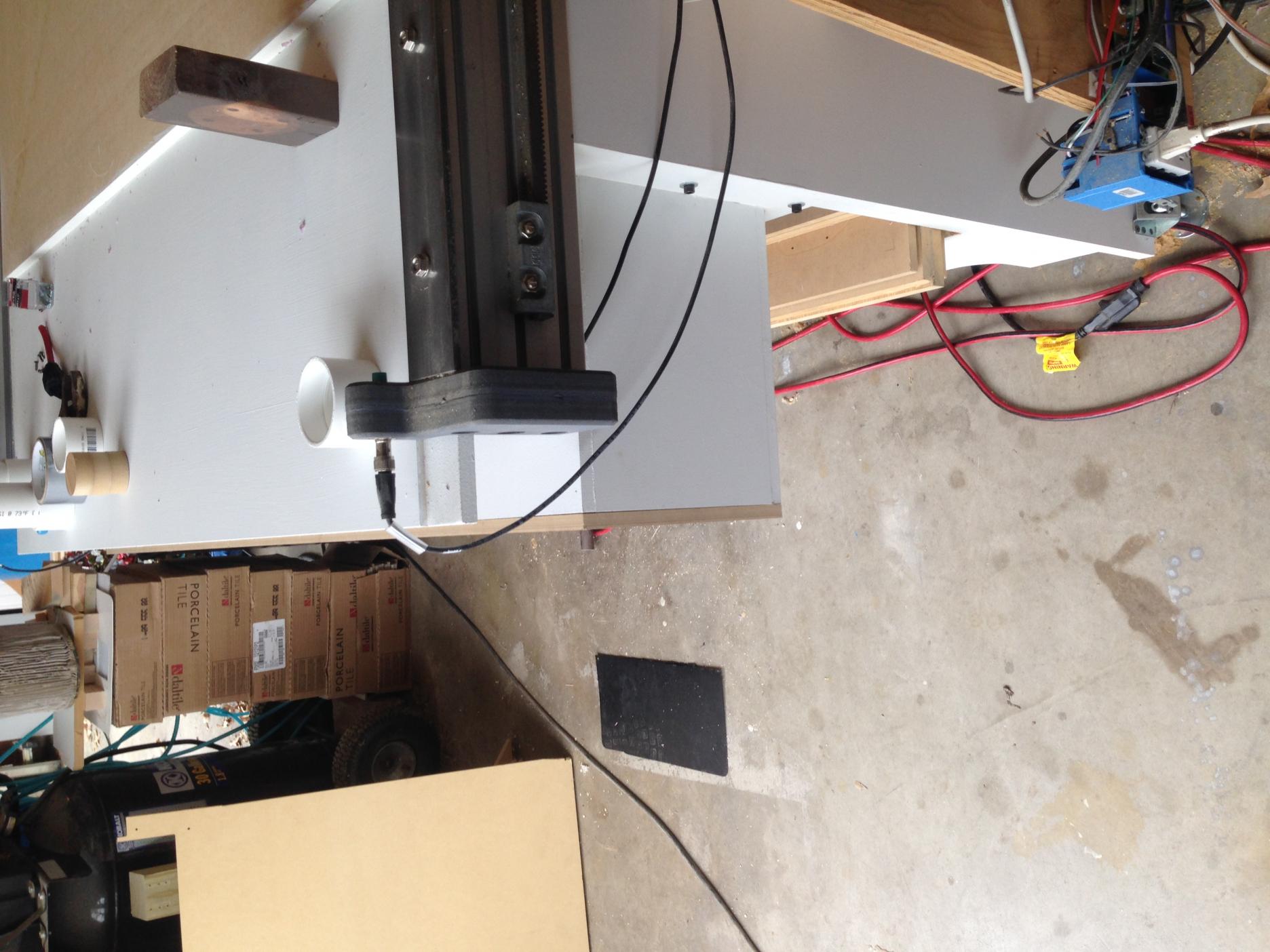

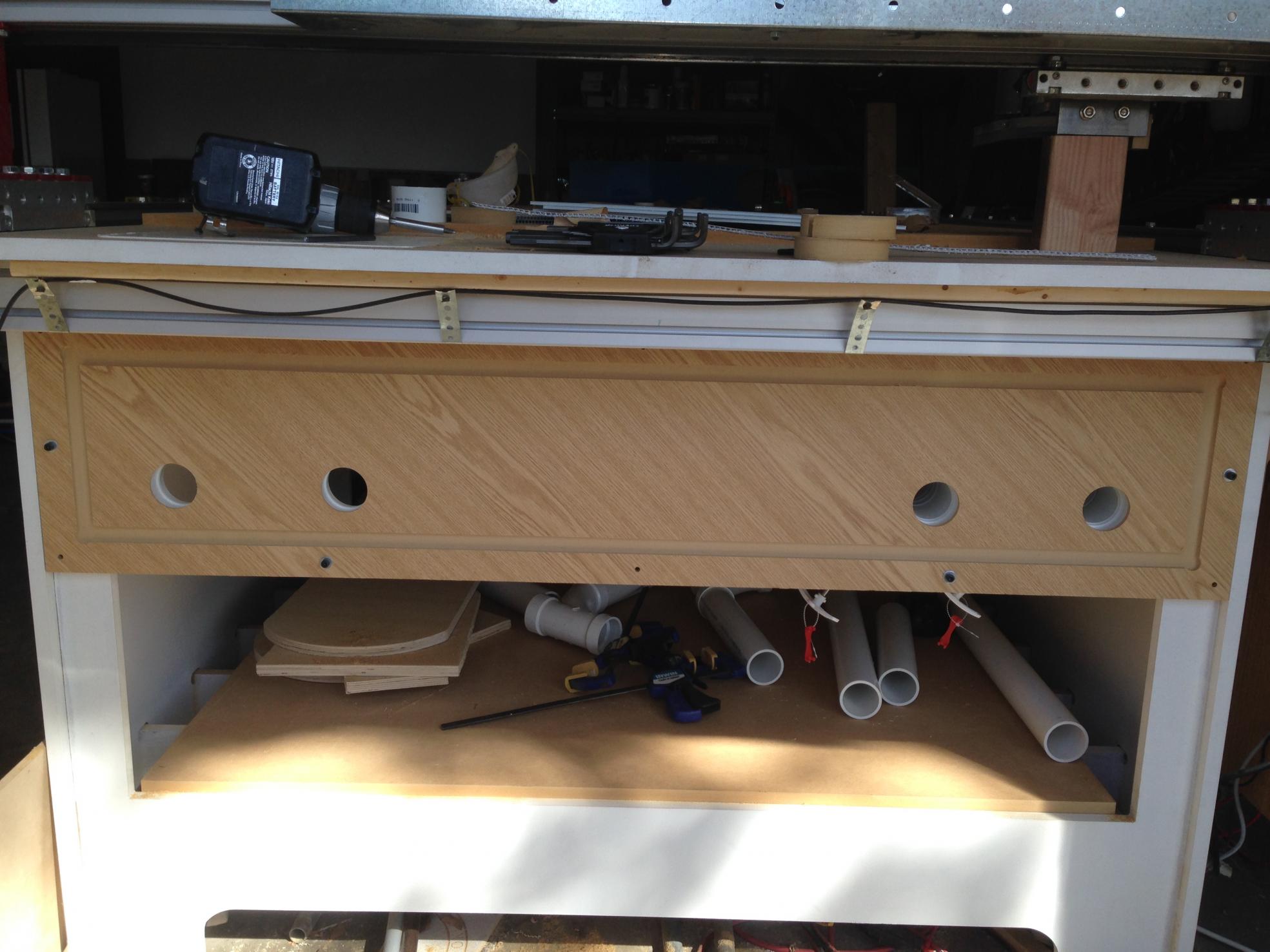

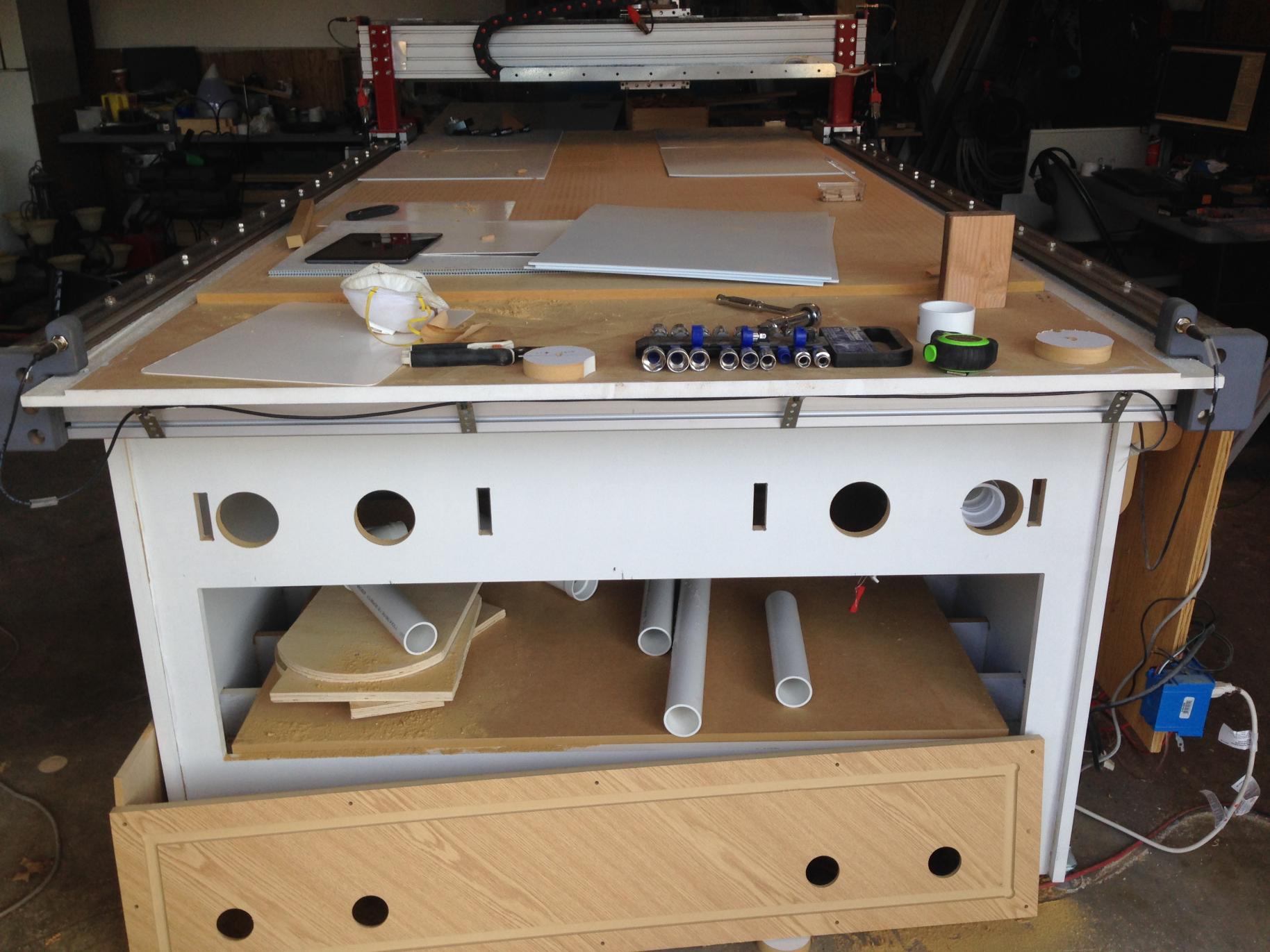

    Basically there is a back plate that I can bolt to the end of my machine that faces the garage door, and corresponding holes in my stand that lead to 2" PVC pipes routed to the 4 zones in my table plenum. Each zone has a gate valve up under the table right behind where the vac box attaches.
    Back plate in place
    This was all routed out of 3/4" melamine that a friend sold me cheap b/c it was a maple wood grain patter that he no longer liked. I plan to paint it all in the end so it was a good deal.

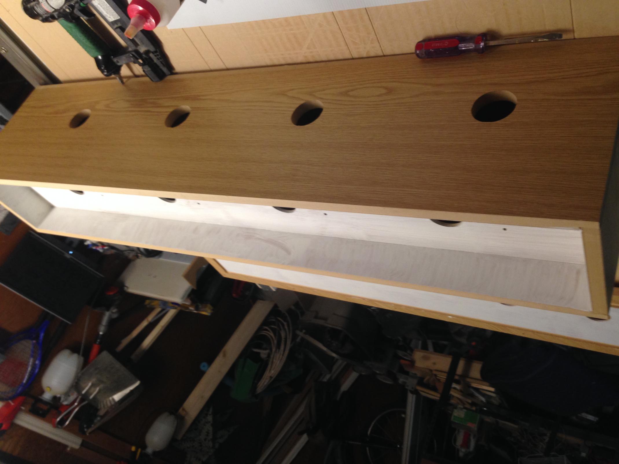

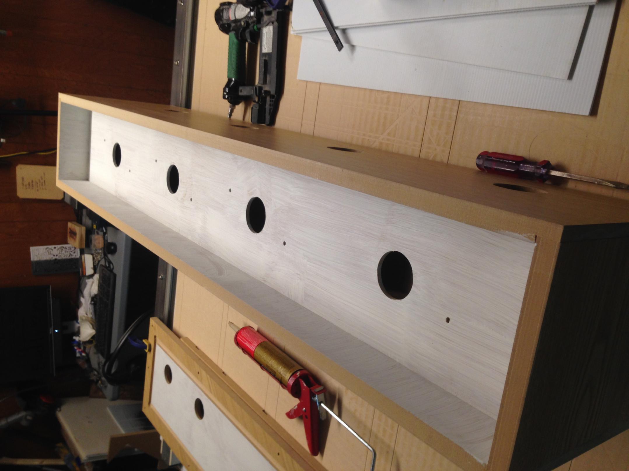

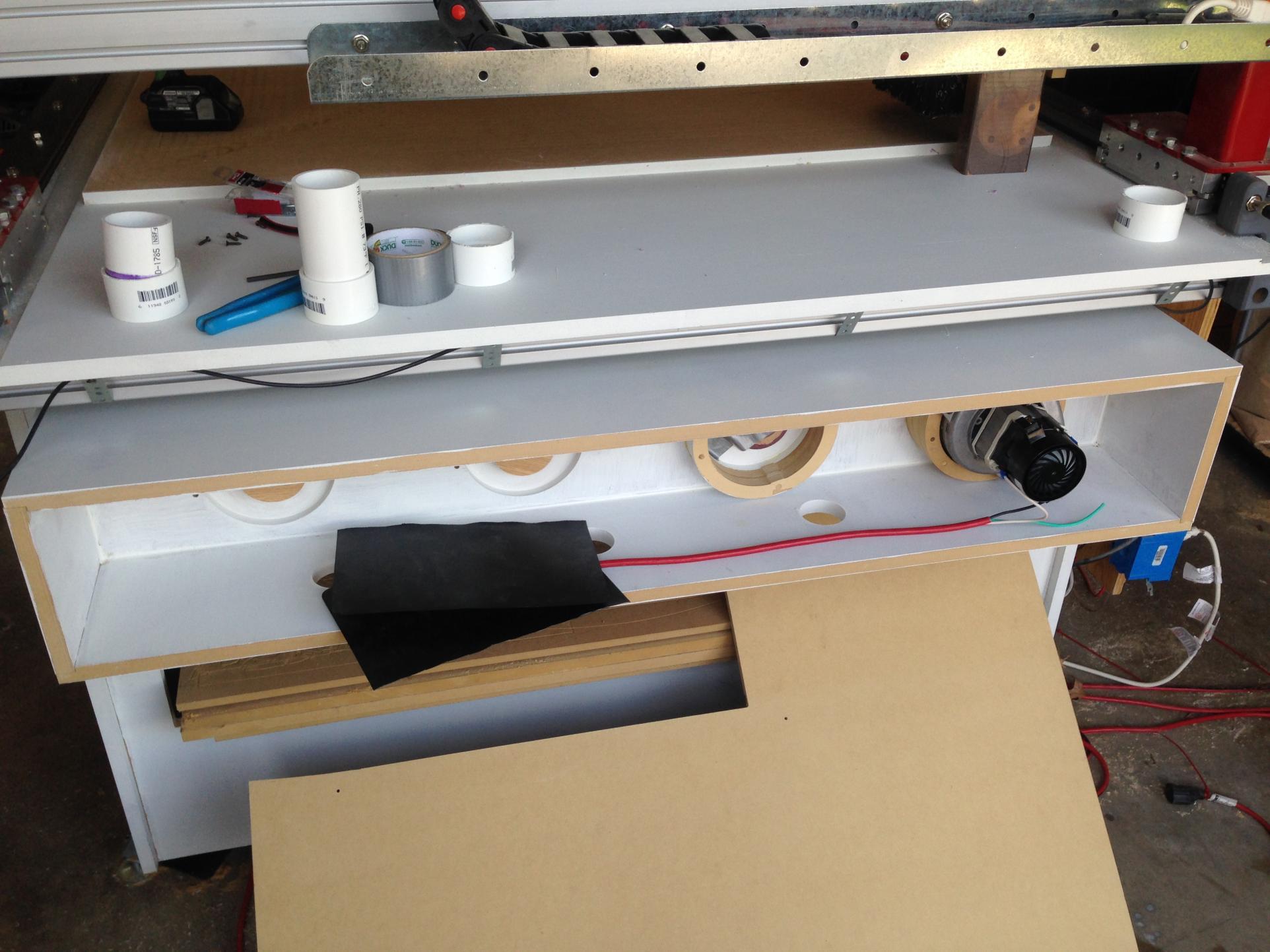

    I test fitted the back plate and all was well, so I glued up the vac box and glued it to the back plate. The vac box is 12" from back plate to the lid where the fan holes are located. Around 4" of the vac box is plenum that all of the motors will share which is also connected to the stand plumbing via PVC couplers which are cemented to the back side of the back plate. The remaining 8" is dedicated to the motor housing and lid.
    Picture of the vac box plenum from above

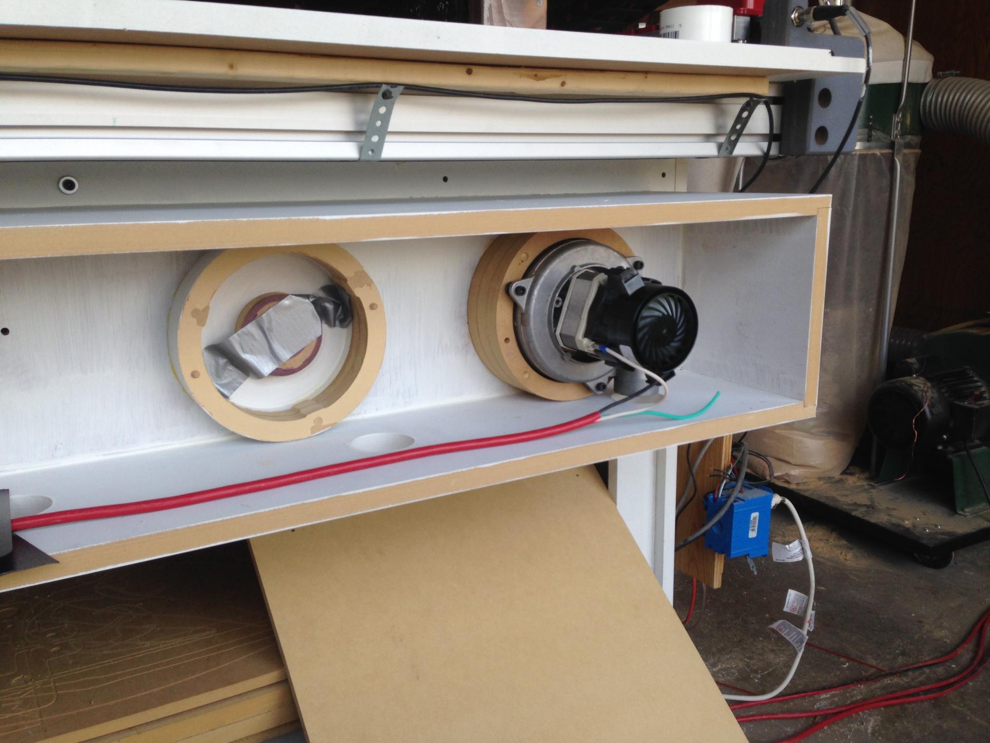

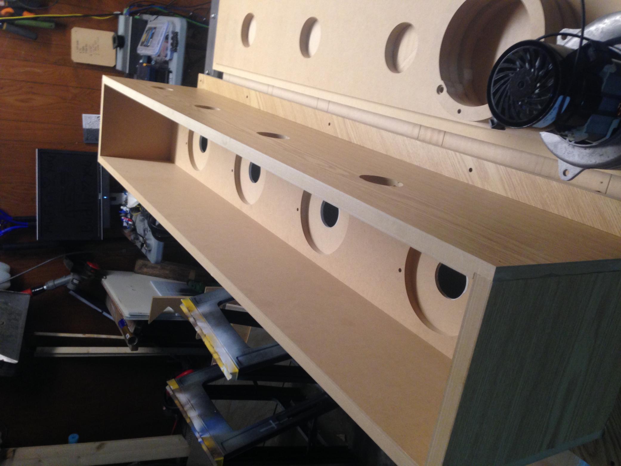

    Vac box plenum side from the side showing the downward facing exhaust ports

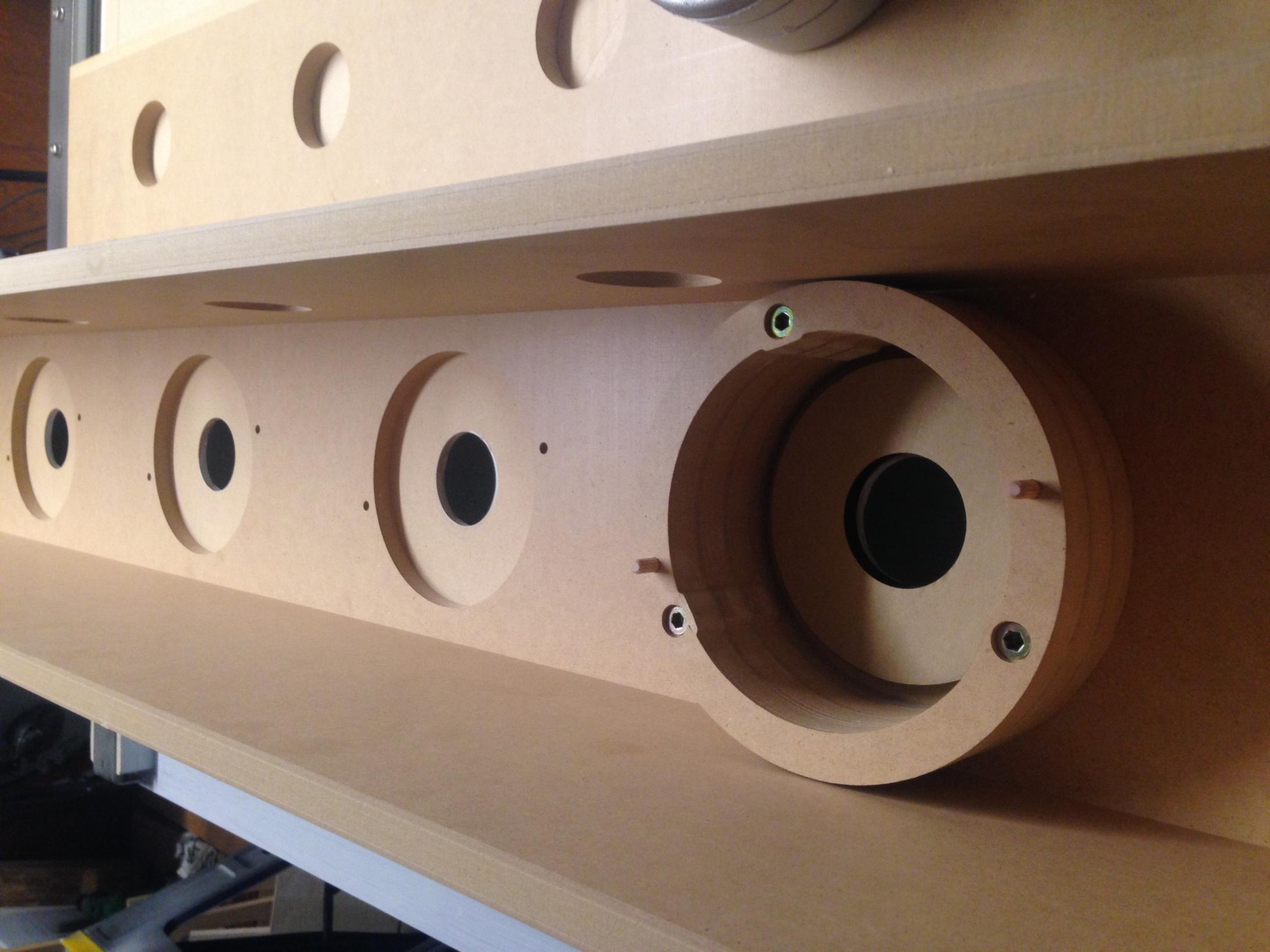

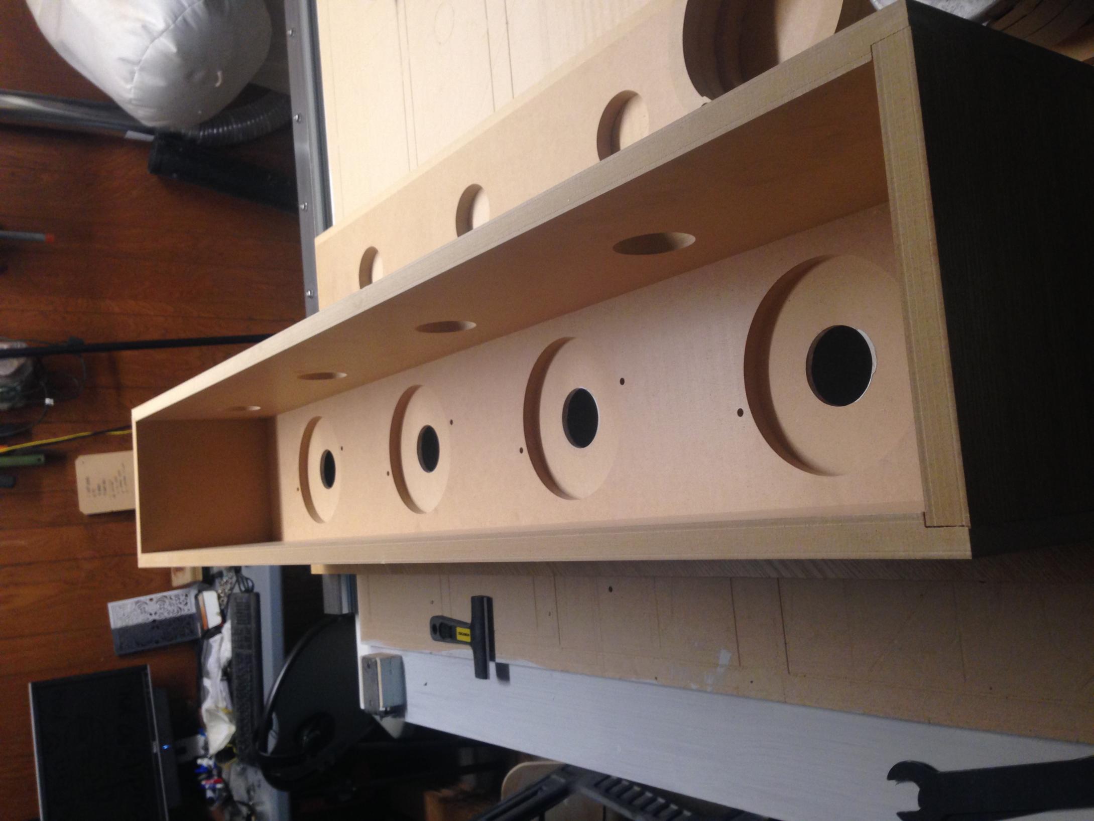

    Vac box motor side showing insets for the motors and gaskits

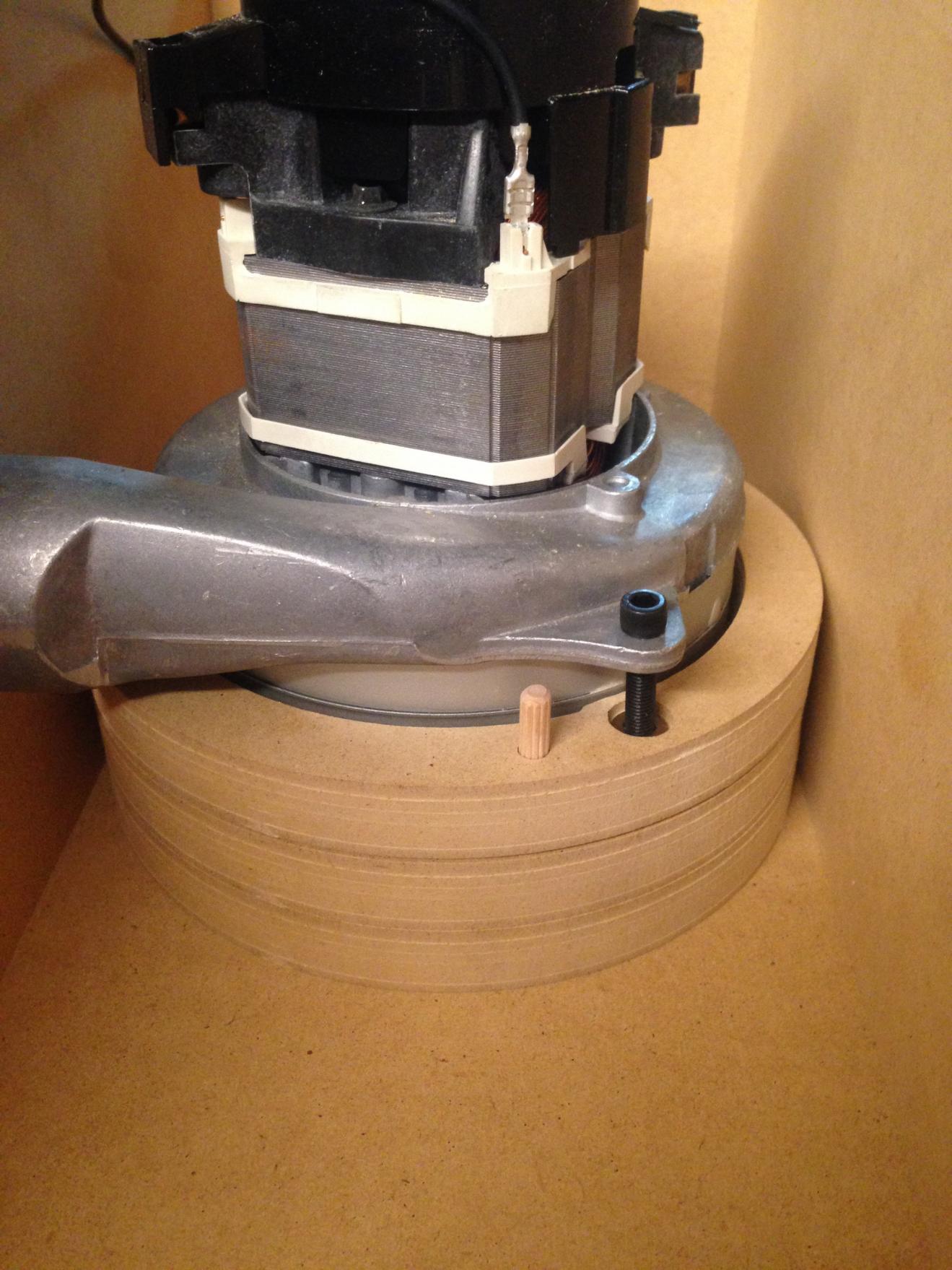

    I didn't like the idea of having the long threaded rods, so I made some collars that I glued together for height and the top one has a threaded insert. There are all aligned via dowel pins.
    Collars in place
    Motor in Place
    I liked how the collar design turned out, however using MDF for the collars turned out to be a bad idea. When I tightened the bolts to hold the motor down, the middle collar was pulled apart and came loose. I didn't feel like doing a complete redisign and didnt have any other type of wood available, so I just cut another set of collars and added 4 holes that I pushed a 3/8" dowel through from top to bottom. These additional dowels seem to be doing a good enough job of holding the MDF collars together, but I already have a better design in mind.

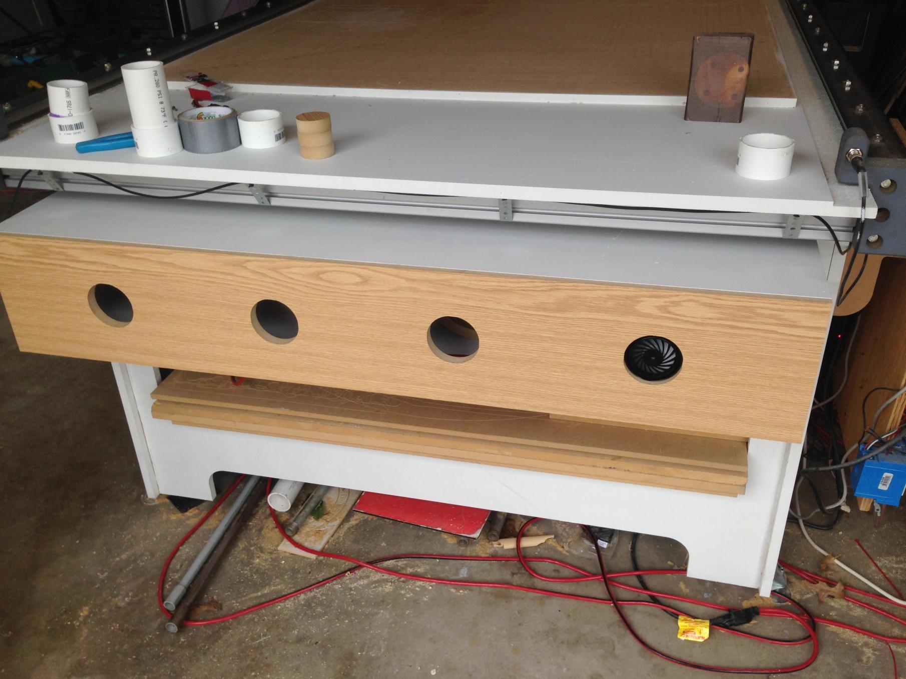

    Collars glued in, motor mounted and bolted to the stand.
    After it was bolted to the end of the stand I just had to run the 2" pvc to all of my zones. As I said before there are gate valves up under the table right behind the vac box back plate. They are out of the way, which is nice but you have to get down on your knees to operate them, so I might try and automate them with some actuators at some point, but for now they do the job.
    I didn't take any pics of the under the table plumbing, but that's pretty standard. I used 2" PVC and the long curve 45 degree turns then used some toilet flange to connect to the table plenum.

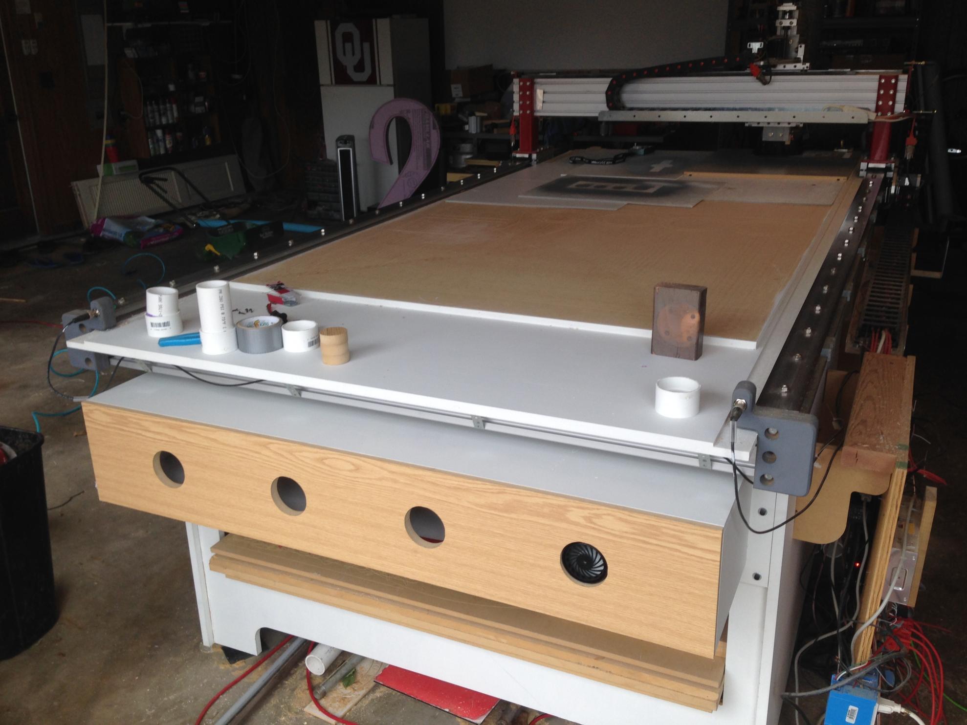

    Plumbing done, lid on. From some angles it looks like the box sticks out past the end of my table, but its actually flush.

    I have still not cemented any joints, and I just have some wood scraps covering up the holes I made for future motor additions and my initial results are 7Hg at the table with a sheet of MDF on the bleeder board. Overall I am very happy with my results. Before I had finished this box I had a plain old shop vac piped into my plumbing and at best I would get 2-3Hg. So with over twice that amount, and with the additional CFM I would say that this was quite a large upgrade. I plan to rework the motor hold down collars and add an additional motor in the near future. I can't imagine I will ever need 4 of these motors, but I built it so I would have the option should I choose.
    One question, has anyone taken a temperature reading from inside the motor box? I noticed mine was pretty warm after about 30 minutes.

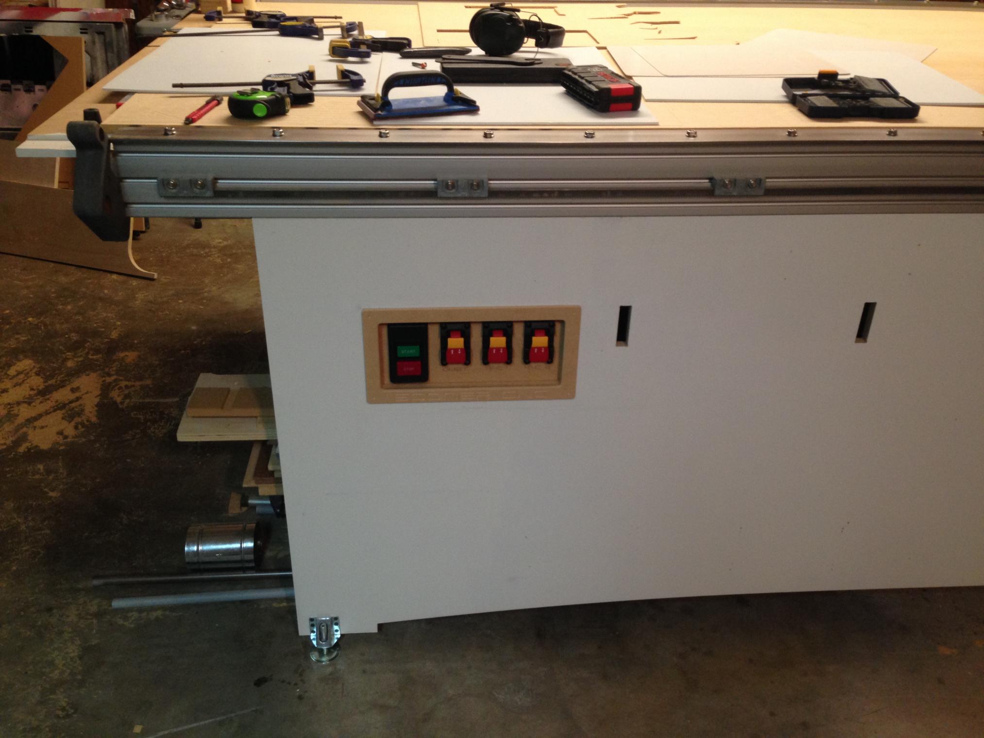

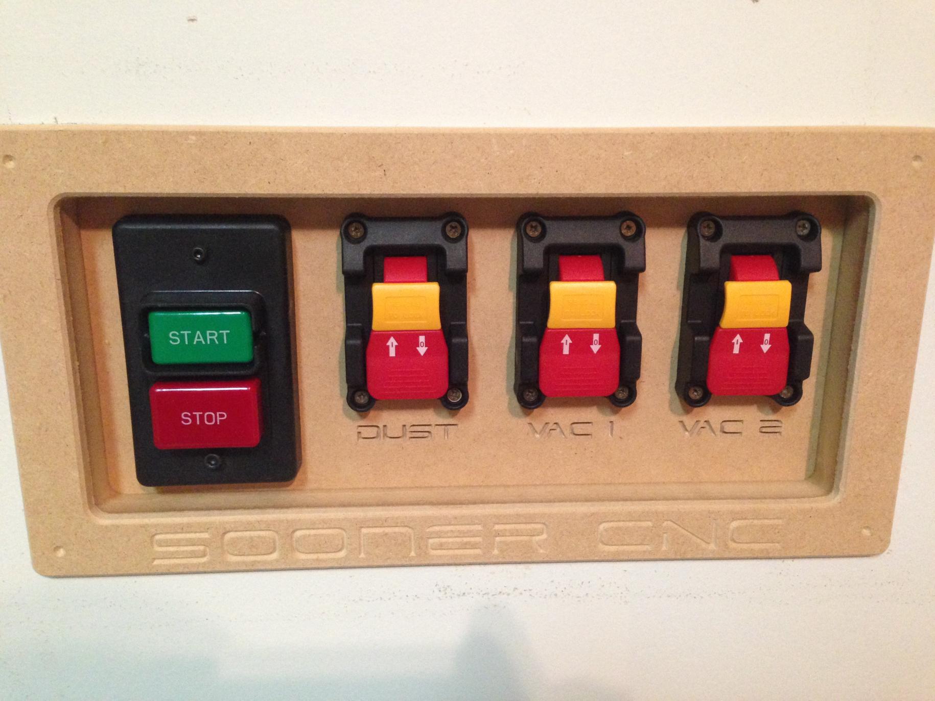

    Got tired of walking around and throwing individual switches so I made a switchpanel. First switch powers on machine, next is dust collection, followed by 2 switches for the vac box.
