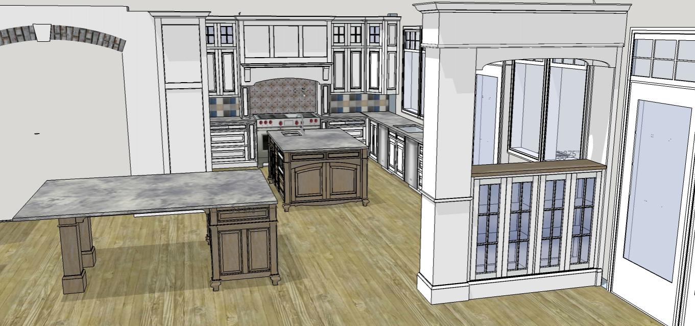

    Default In defense of Sketchup, FDWIW
    Okay- had to chime in here. I'm at about 10 years into Sketchup. Began that way as I did not have cnc until 4 years ago. The adaptation/acrobatics to get things into Vectric for vectoring etc. was a bit of a curve, but accuracy of parts is impeccable. Still feels cumbersome and I wish for a streamlined process, but once you've made a commitment, very difficult to switch gears.
    I would not recommend Sketchup if 3D sculpting is your goal. Just not worth the trouble from my experience - Brady's assessment there is correct. Then again, furniture and cabinetry is 99.8% 2.5D, if that's your primary function. While there are those combining and bridging Sketchup and Vectric into one process, we're back to the CAD/CAM program of the month club, which clearly none of us are fans of. Further, I'd still have to do all the work to generate a unique set of cabinets within that program. This means I'm doing all the work of drafting one of a kind pieces that I do now, but paying them $150+ to save an hour or two of conversion. Pretty much a wash, so I've elected to skip the inevitable learning curve and stubbornly cling to the processes I've already honed.
    Process for me goes like this:
    -Sketchup is used to model and draft in detail for client's visual proof. (see image)
    - Many major appliances and lav products can simply be plucked and placed into the model from 3D Warehouse
    -That very model is dissected and dxf's exported for CAM processing in VCPro
    -Cut List Bridge allows me to export parts list to Cut List plus
    -Cut List plus very quickly gives me a numbered list of plywoods and hardwoods bill of materials, allowing me to order materials, print a cut list for hardwood processing in the shop and print labels to attach to ply parts as they come off the machine.
    All this is done for an elective annual fee of $120 for up to the minute updates and toll free help from Trimble/Sketchup, which I've not yet needed.
    Sounds like you've received ample guidance for your specific needs. I just wanted to interject this for the benefit for readers who's business model may be similar to mine and could use some clarity on utilizing Sketchup to run a successful business.
    Image attached is a Sketchup screen shot of a kitchen I just completed. Showing it without any special rendering plug ins applied, just light shadowing within the program. Though rendering/light-up programs can dramatically improve an image such as this, the vast majority of my clients are nothing but pleased to be able to preview their project as shown. X-ray view helps illustrate all details of joinery are there.
