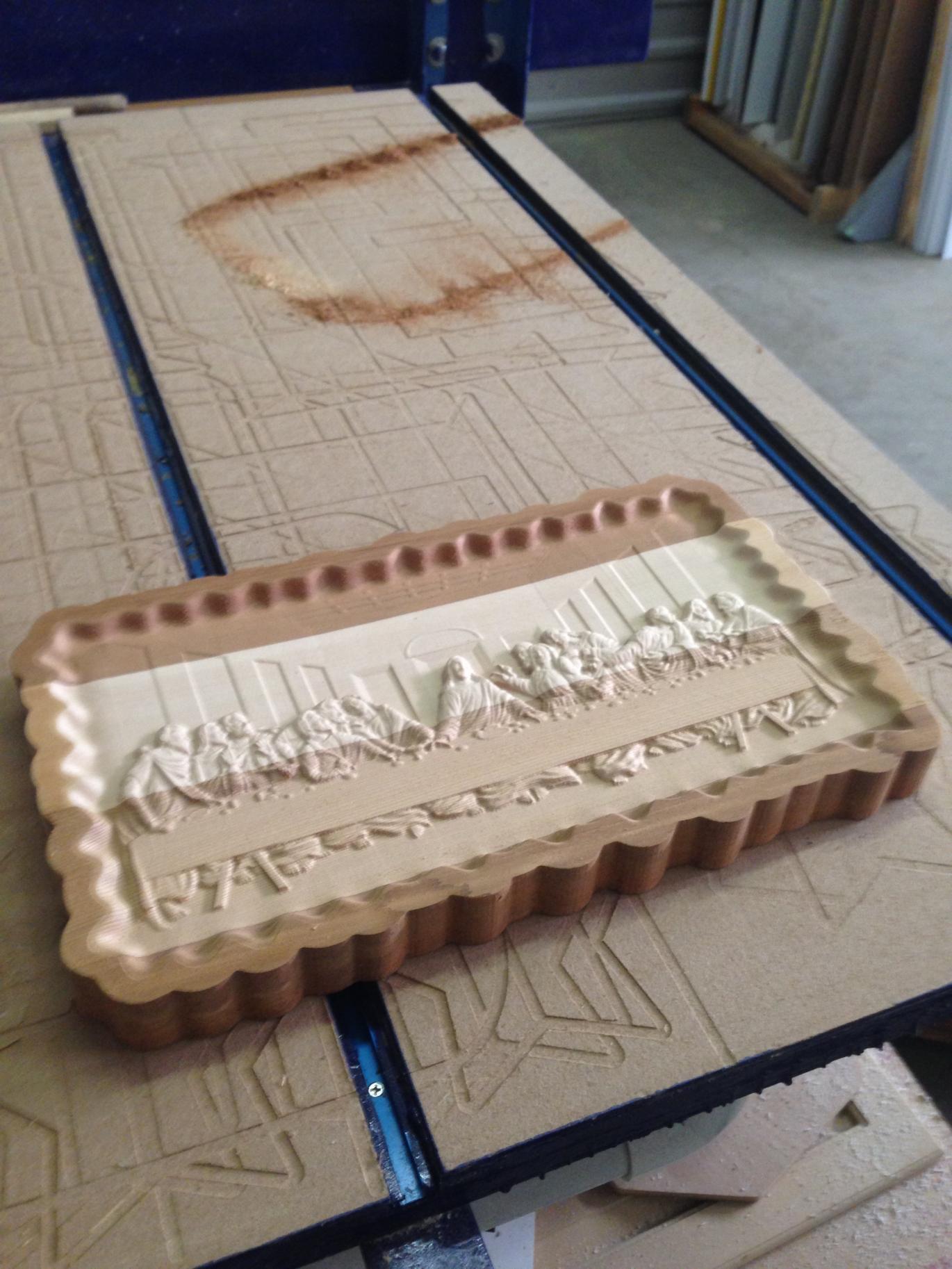

    I let my SB run unattended for the last roughly 7 hrs of the finish pass. I went home and slept. I was pleased to come in the next morning and see the Bot at 0,0 and my porter cable router still running at low rpm.
    Trust me I took all safety precautions. No dust collection, no vac hold down.

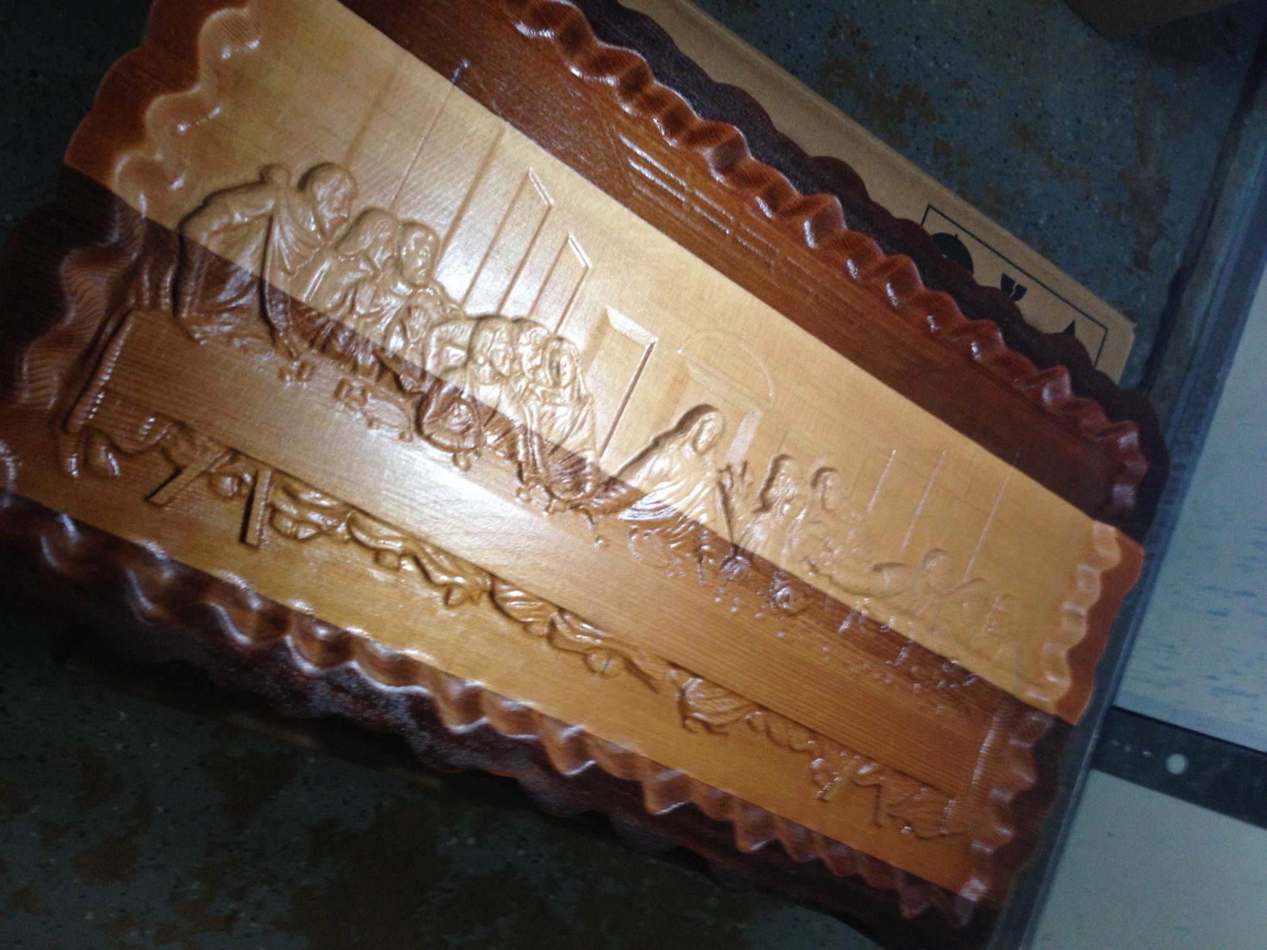

    It is not something I plan on doing again, but it was for my grandfather and it was right before I had to get on a plane to DE for our family Christmas visit. I actually carried it on the plane raw cnc carved wood. Then stained it in DE in my Dad's sheet metal shop right before I gave it to Poppop. He loved it, and it was still a little taky from the multiple clear coats I was giving it from a spray can.
    The wood was a piece of scrap of 1.5" thick western red cedar I had from the corner of a sign I did years ago..
    I bought the 3D art from https://www.vectorart3d.com/

    Hello David. That is a beautiful carving. It is exactly what I want to do very soon. Could you please tell me the size of your carving and approx. total roughing and finish toolpath times? Also did you resize the file after downloading? What are the dimensions of the download when imported into aspire? thanks in advance.

    I have the file to cut the Last Supper but have never done so. That looks beautiful. Did you encounter a lot of warping in this carving?
    7,830
    Quote Originally Posted by cowboy1296 View Post
    His depth of cut versus material left shows he had plenty of material left so i doubt he had any warping. However i did a blanket chest lid out of walnut and cut it way too deep leaving only about 1/4" material and when i unfastened it from the table it sprung into a pringles potato chip. a total waste. Depending on the size and depth of your carving i usually leave twice the amount of depth of cut for material on the bottom. That is not some magic rule, it's just what i do.
