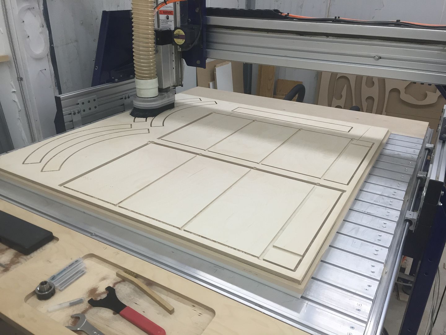

    I'm making a whole bunch of pint sized shelving and kids benches, etc for a local school/daycare. I'm matching several pieces that were purchased elsewhere (but in KD form) and everything is made from 1/2" (12mm) Baltic Birch.
    I'm cutting all the gables (there are 15 individual units, plus other things irregularly shaped) out on my BT48, with my 48" x 48" cutting area, and universal vacuum. Jobs like this are why I needed that vacuum! Being able to throw a 1/2 sheet on the top and press go, and walk away. Very nice
    All the grooves and dadoes are cut to accept the shelving, backs etc and we just need to glue everything together afterwards. Sure makes jobs like this simple. Simple means profitable!

    The material is 12mm Baltic birch, cut with a down spiral 1/4" bit in two passes. The material is actually 0.475" thick so I first climb cut to 0.4" then conventional cut to 0.48". No tabs.
    Even with the down spiral my dc picks up the shavings on the 2nd pass. I have a 7.5 hp Belfab unit with a cyclone ahead of the fan unit. It isn't huge but does a great job of handling a shop my size. We often have several things running at once and it is just enough to keep up with three of us working.
