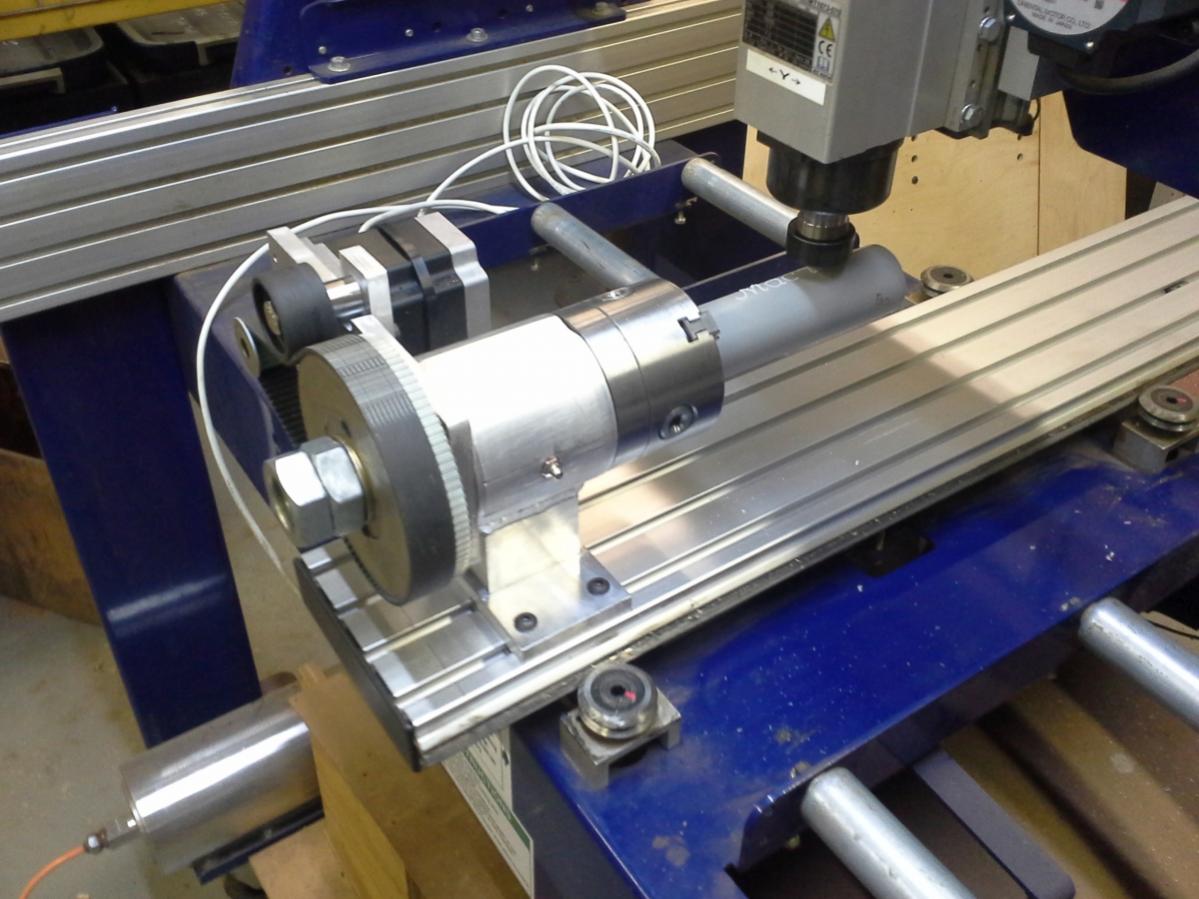

    Well I finally finished my 4th axis for my ShopBot.
    Special thanks to Brady Watson for the help on getting the right motor and drive board for my machine.

    Very cool! Now we expect to see several indexer projects here...soon! Even though you don't have a long bed you can always design projects in sections and be able to dowel them together to form a large project like a bedpost or something similar. Good job!

    NP Brad, and yes its very stout.
    Timken bearing,Gates timing belt and gears 1:4 ratio and 2 people cant even make it flinch while moving lol

    Looks great, if you don't mind, how much have you spent on parts?

    around $650 for all the parts and raw materials, I work in a machine shop so I did the designing and machine work my self.

    Great job. What is the biggest stock you can use with it? 4 or 5 in?

    Sorry for the late replay been busy,
    The chuck can grab on to a 4.5" stock and the B axis (indexer) can chuck up on a 8" piece and not hit the power stick,
    but because I don't have the Z axis extension so the Z axis can only take a 4 inch.
