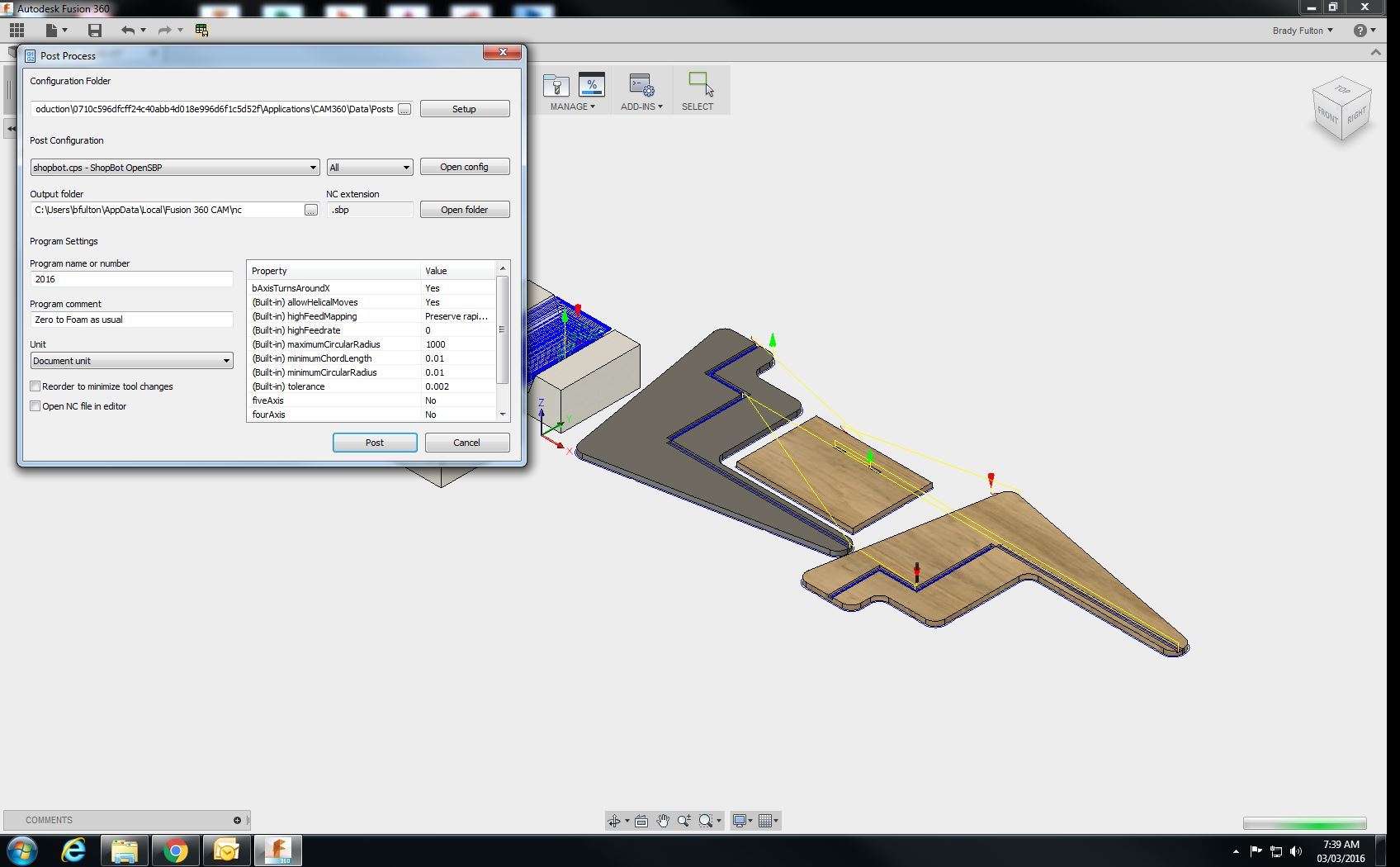

Having had some issues with the post-p's tech support informed me the iso version is a alternative export version that Shopbots can read.
Stick with the standard shopbot.cps

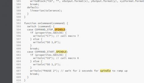

If it doesn't output with the .sbp file tag automatically. Just add it to the file name it will be fine. Oddly this resolved itself automatically within a couple days of usage. (25th April 2016)
Also I find there is no start/stop spindle command being generated for some reason.
-Solution.
When saving the post-p file there is a option to view in nc.
Have this box ticked.
Then after pause command insert start spindle command. SO,1,1 and at end of file instert spindle stop SO,1,0
R-click on the file name and save.
All should be well.
Also When outputting. Tip. you can drag the cutting tabs to change the cut order.
and you can highlight multiple cuts to output as a single G-code file. (if same tool used)
