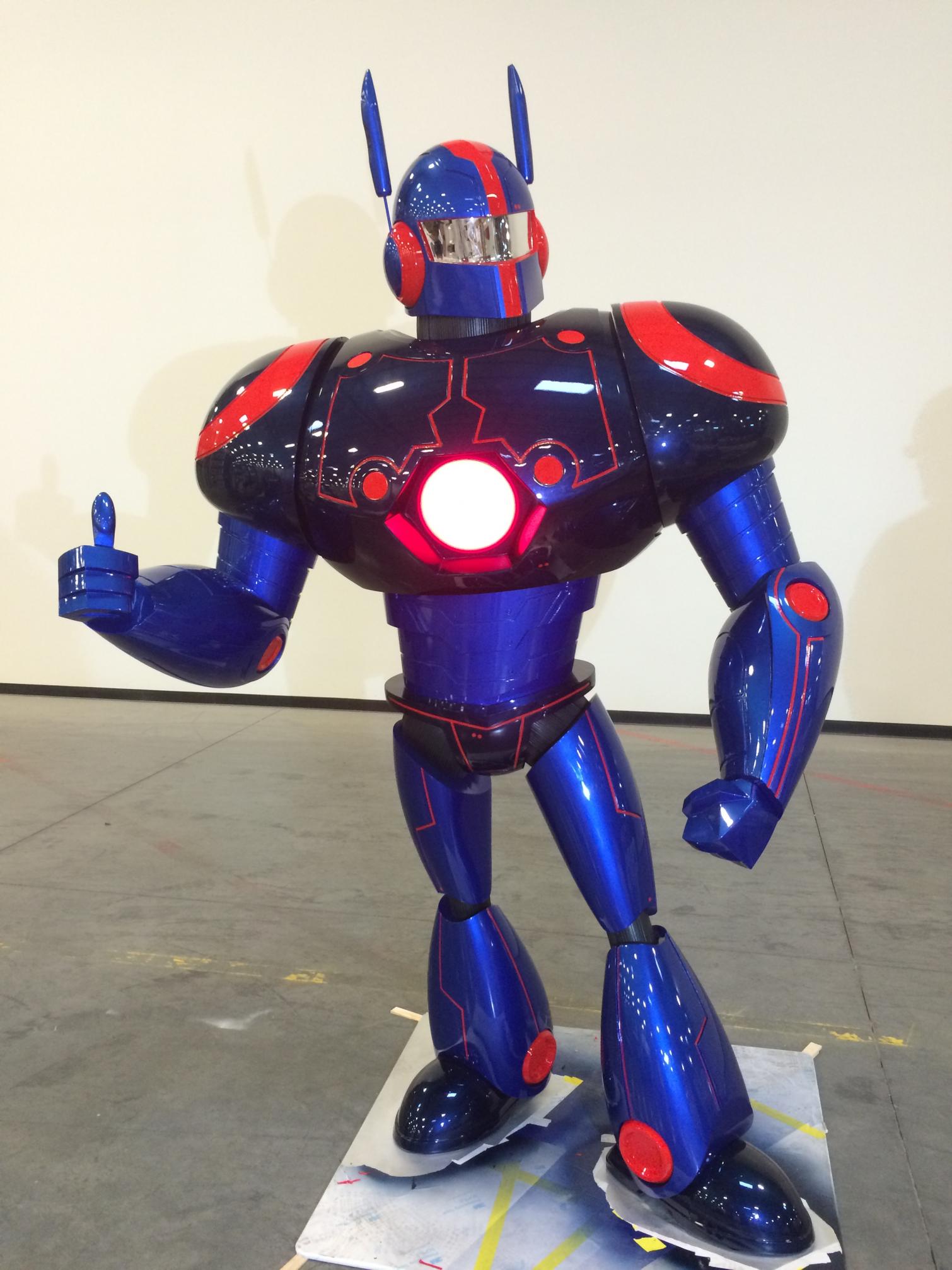

    IMG_2558.jpghow glossy are you looking to go ? how perfect of a sign are you looking for ? I paint and finish sign foam with some flawless coating, and very high standard automotive finishes, perhaps I can help you.
