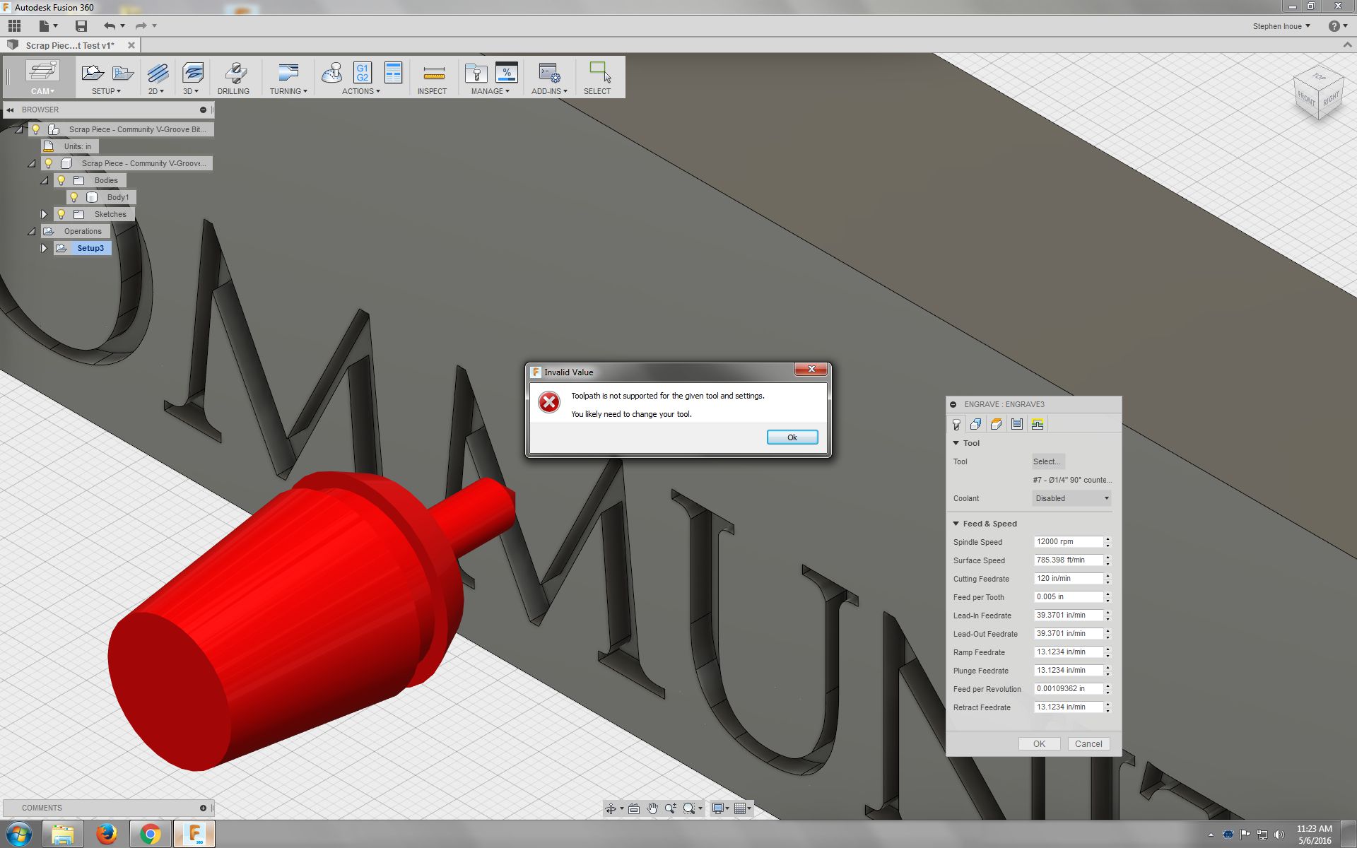

In Autodesk Fusion 360 it isn't so clear. In the CAM space when I choose 2D, Engrave I get asked for a tool type. I had originally defined my Whiteside V-Groove Bit #1500 as a Counter Sink, but when I choose an engrave path using it I get a tool error. I'm going to redefine the tool as a Chamfer Mill to get around the error message, but I don't get the sense that a V-Groove Bit for Engraving is really a Chamfer Mill tool.
Has anyone done engraving using Fusion 360 figured out how to define and use V-Groove Bits?
