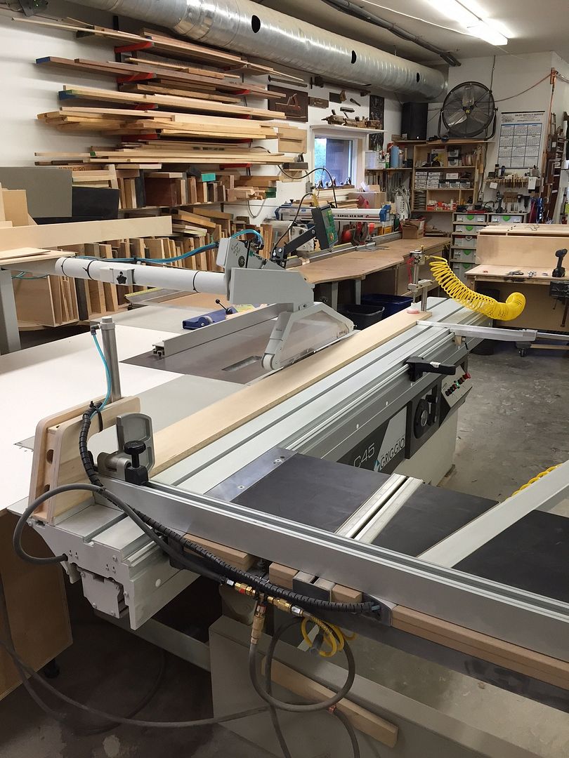

    So I was investigating getting a parallel fence for my slider - an add on, that is used along with the stop on the cross cut fence to better align and cut strips of sheet stock (vs using the fence which is canted slightly away from the blade and can introduce an error).
    Commerically made, I was quoted nearly $800 US dollars each.. which would amount to nearly $2400 Canadian for a pair. (using two allows easy cutting of tapers).
    I was mulling things over in my mind over the past several weeks. Since I do some rudimentary metal work with my lathe and mill in the shop tool room, the only thing I was apprehensive about was making the part that hung off and locked to the edge of my Griggio sliding carriage. Its a funky shape unlike most of the standard slots and bars etc.
    Then I got the idea to try and cut the complex shape from layers of Baltic birch on the Shopbot. I used 6mm material, and a 1/8" bit. Gluing several layers together, I thought this would probably work!
    After the wooden block was assembled, I epoxied an aluminum U channel to it. I fabricated a cam clamp from aluminum and brass to lock it to the carriage. A slot milled into a block of aluminum, and a 3/4" square bar of aluminum complete the fence.
    The locking bolt is a 1/4x20 brass threaded rod with a handle and wont marr the aluminum sliding section. A peel and stick tape and a cursor I borrowed from one of my Kreg fence stops allows very accurate setting.
    Can be taken on and off the saw in seconds. Locks well, and is very accurate.
    Total cost was about $30 and 3 1/2 hours of my time. Now I need to make another.

    Proper set up of any Euro panel saw, is to have the ripping fence slightly (like maybe 5 thousandths to 10) "open". The rip fence on a slider is really there as a stop, to set up your cut - but the material is always referenced off of the cross cut fence.
    Think of it as you are either using your rip fence, or the stops on the cross cut fence to set your cut, but the material is always held up against the cross cut fence (which is set perfectly square to the blade).
    Yes, you can still cut something using the ripping fence, but a small error is introduced especially on long pieces. The angle is set to give clearance a prevent any jamming of material between the fence and blade/riving knife.
    This is the traditional way to set up and use the saw. Ideally, 100% of your cuts (both rip and cross cut) are referenced from the cross cut fence, and your piece you are cutting is on the sliding carriage. This gives you perfectly square panels.
    Which brings us back to the reason for this parallel fence. If you want to rip, say, a narrow and long piece - it is hard to accurately reference the end to the cross cut fence and hold it without a means to also reference the other end.

    I dont think we are differing...
    I too trim the end of the sheet, place it up to the cross cut fence, take a cut along the long edge of the panel and start ripping, using the (what I am calling the ripping fence, ie the long fence on the saw that on mine is replaced with the Tigerstop fence) ripping fence as a "stop". And yes, I too pull the fence back behind the blade when cutting smaller pieces. But for ripping I leave it in the forward position.
    The thing is, what do you do when you have, say a 10" piece left over and need to rip an accurate 6" piece from it? The 10" is too short to accurately square the panel and take a cut, so you use the ripping fence to do this.
    You may have your fence set parallel to the blade and carriage, but that is not the true way these saws are set up. Every technician I have spoken too (some European trained and them moved here to live/work) has told me that on Euro sliders the fence should be set approx 5 thou open, to allow a cut to be made and give clearance between the blade and fence. This prevents any binding, and any poor quality cut especially in melamine. I have set up my saw this way, as do many in our business.
    So back to my scenario.. you have a 10" piece of material you want to accurately rip to 6". Set the parallel fence (the thing I made) to 6", set the cross cut fence stop to 6", place you length of 10" wide stock to both stops and clamp down, run the carriage through and you have a perfectly parallel 6" piece of material. On my saw, with the fence canted outwards, you would see a measurable difference in width if you use the rip fence to do this. Maybe 5 to 10 thou. Not a lot, but on melamine its is noticeable if you are aiming for 100% tight, accurate joints.
    There is one tech in particular I rely on for my info. He has a mechanical engineering degree from Europe, and worked for several larger European woodworking machinery firms, before emigrating to Canada. He schooled me on the panel saws' ins and outs... lol But this is also pretty common among users I am familiar with as well, over the years. It certainly isnt my idea/opinion...
    In the end whatever works!
    When I make up a second unit like this one, it will also be very useful for setting angled cuts.

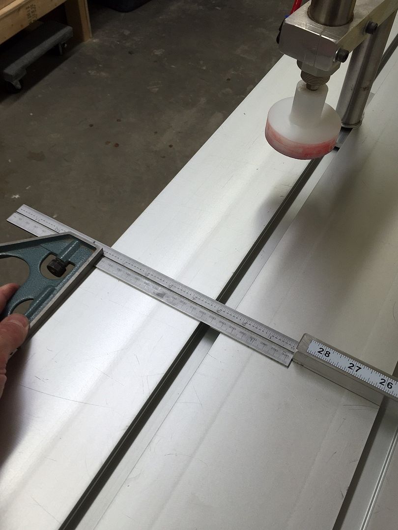

    Setting a stop isnt what I'd call a challange, lol. To each his own Dave. I am not planning to use this for every cut. however whn I want to make sure something is 100% parallel to the best I can, this will do it better than using the rip fence. JFYI I also make my uppers deeper but it hasnt caught on up here with the other shops. However I use a full 1/2" back and no nailer strip. My father used a 1/4" back, one of the changes I made to his construction methods.
    Some pictures of the setup. My two pneumatic clamps (also shop made for substantially less than bought ones) are another thing I did without for years. Until I tried one, and then now I wont use the saw without them. I ran the air hose through my carriage extrusion and I hook up the rear one when used.
    setting the fence is easy once you adjust the cursor to read perfectly. Then check that the front cross cut stop is set the same.
