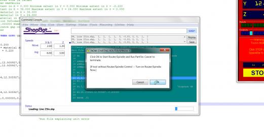

    Hey guys, I'm brand new to Shopbot but I have some experience in CNC machining.
    I'm doing something a little different with our Shopbot here at Air Power. We are using it to dispense a bead of fluid, I'm not using a router on this machine.
    With that being said, I keep getting this message box telling me its going to start the router/spindle even though I believe I have removed anything to do with the spindle. I'm controlling my pneumatic dispense valve using a solenoid valve that is triggered by Output 1.
    I WANT TO ELIMINATE THE POP UP MESSAGE BOX! It drives me crazy.
    Here is the beginning of my program:

    The message pops up around the "M3,0.500000,3.000000,-0.875000", right before I trigger Output 1 on. (I've tried with different outputs in case that message is tied in with Output 1)
    This is the message box I want to remove.
    2,724
    If you put your solenoid on output 3, you won't get the message. Output 1 and 2 are generally used for Z axes spindle/router outputs. So, use output #3 and edit your file to use SO,3,1/SO,3,0. Be sure that the output can handle the solenoid too. I'm not sure what the specs are. You may be better served with the add-on relay board from Shopbot or an equivalent relay setup.

    Thanks a lot srwtlc, that solved the issue.
    It had crossed my mind that Output 1 was for the router and that was why, so I tried Output 2 and got the same result. It didn't occur to me that they both were for the router.
    I now trigger Output 3, which will be wired to my relay and it runs without the message box.

    Jesse, I agree with what Scott is saying. Outputs 1 and 2 will have spindle prompts as they are used as such as default from SB. I have 4 dual spindle machines. The first instance of either SO,1,1 or SO,2,1 in a part file will force that display. A simple solution, as Scott said, is to run your solenoid off Output 3 or greater; check your I/O availability. I believe these output at 5V, and while you don't need to get a relay board as such, a relay coil which will flip at 5V can be used to bump up to your required voltage. In essence, you will probably need an intermediate, but not necessarily SB's relay board (it could be handy if you are planning on running other outputs). I have solid state relays in line with my outputs; they were inexpensive.
    I've quickly looked in the SB setting to find where to disable it with no luck. There may be a registry modification you can make to get rid of that warning. In fact, I thought I had read it in the SB User Guide (white binder). If you are set on using the Output 1, I would contact SB. It's probably a quick software bit you can set.
