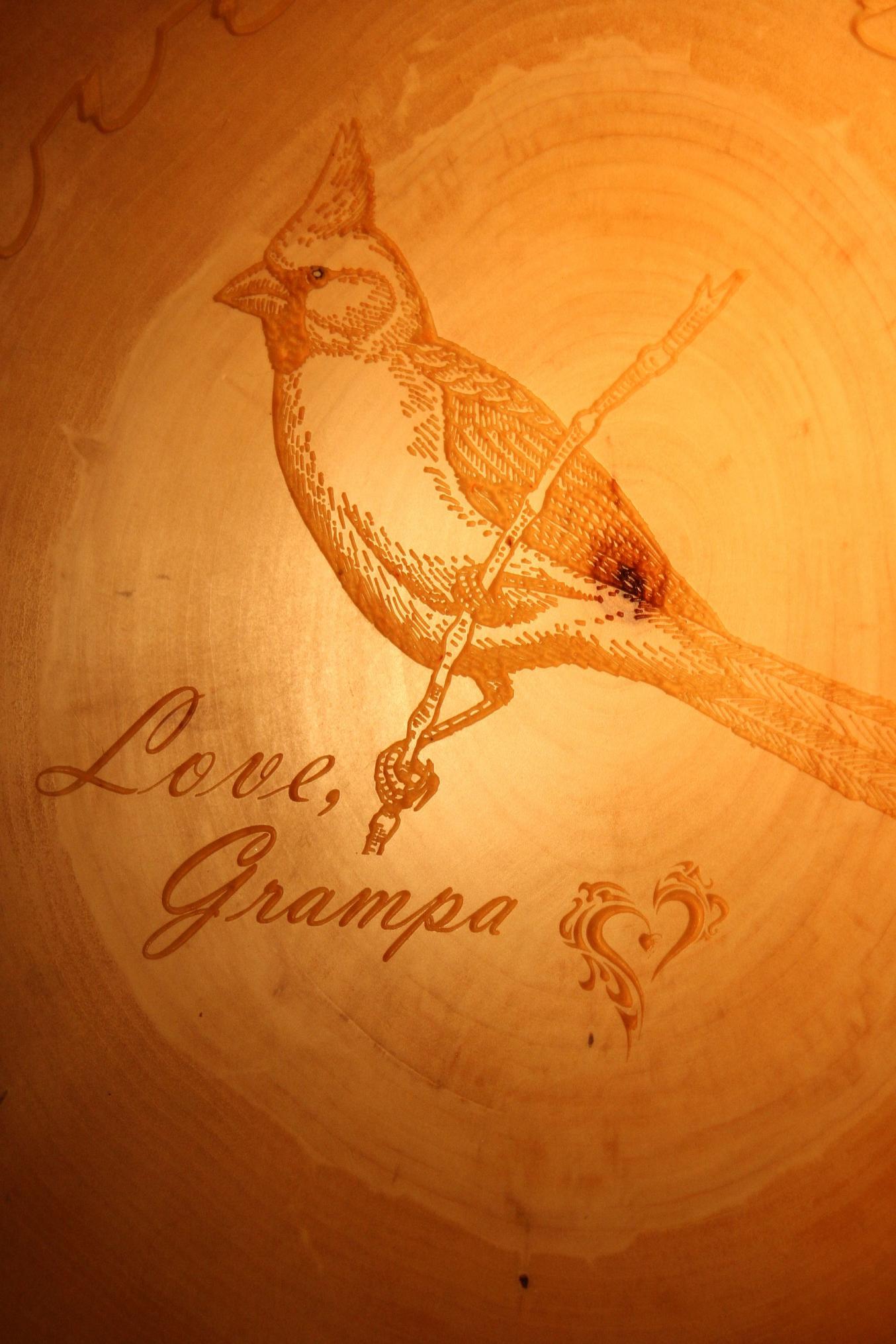

    My friends girlfriend's(now fiancee) Grandfather was a Sawyer for most of his adult life, and when she was 16 he gave her a chainsawed "Round".
    At 16 years old...she stuck it in her closet
    He died last year, and she was dismayed that she didn't have much to remind her of him, except some phrases she remembered he always told her, the fact that he wanted to come back as a Cardinal(his favorite bird), and this chunk of wood. "Love Grampa" was from the very last letter he ever sent her.
    Now that's she's of an age to appreciate what he did,
    She didn't know what to do, but my friend said"Maybe Scott can help"
    She was amazed what skimming the saw marks off and sanding to 600G and a coat of my Linseed "butter" did, and off we went into the design/font/etc.
    JUST finished the last coat on side 2.
    Hope she likes it for Valentines Day from my friend.
    I HATE working with a new wood(especially softwood) and not having a scrap piece for testing, and NO "do overs" allowed.
    13X17.5X1.2" Vladimir Script Onsrud 30 degree engraving with .01"flat on font side, Onsrud 60 with .005"flat on the reverse side.
