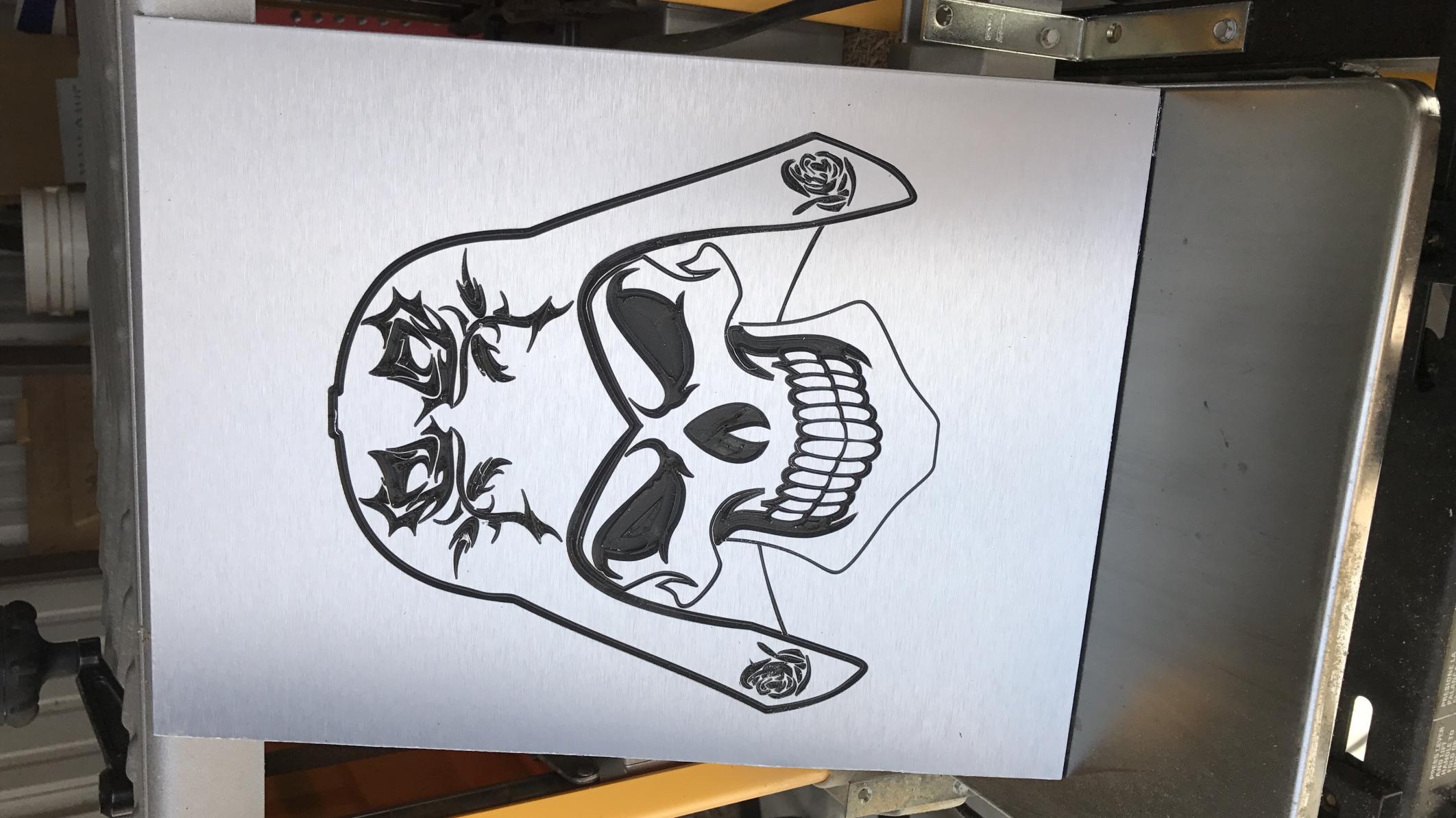

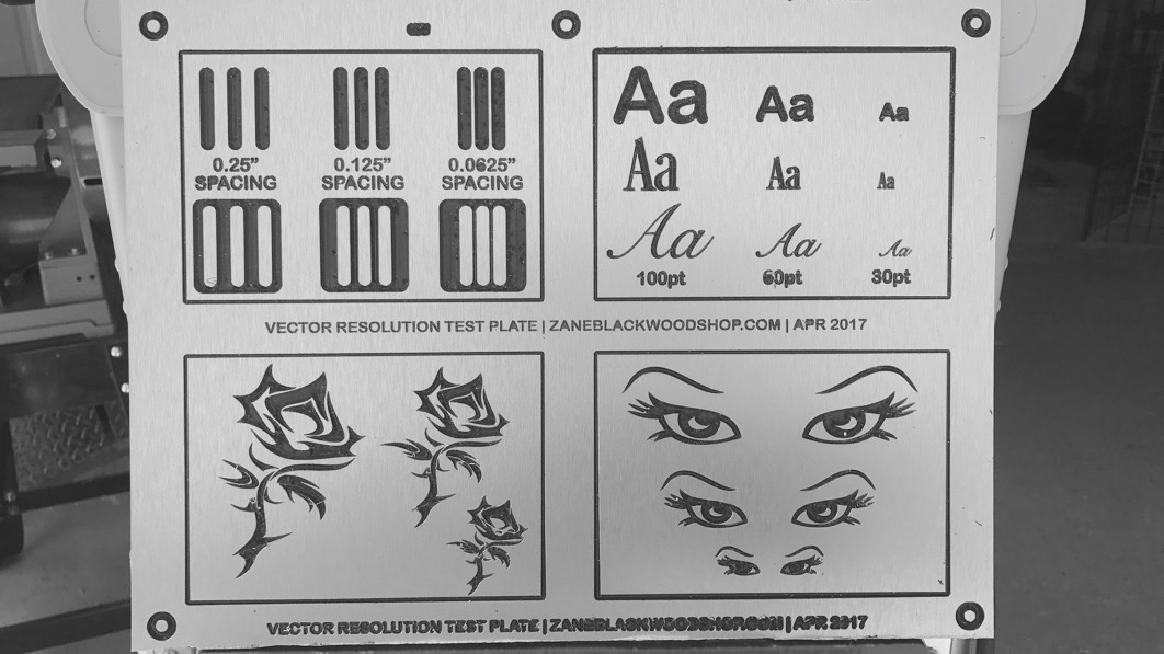

Anything with less than an 1/8" between vector cuts (no matter how you cut them, i.e., vbit or spiral) is problematic.

We cut this with a vbit 90 @ 0.075" depth of cut.
Conclussion: Small detail is best cut at a depth of 0.03 or less.
