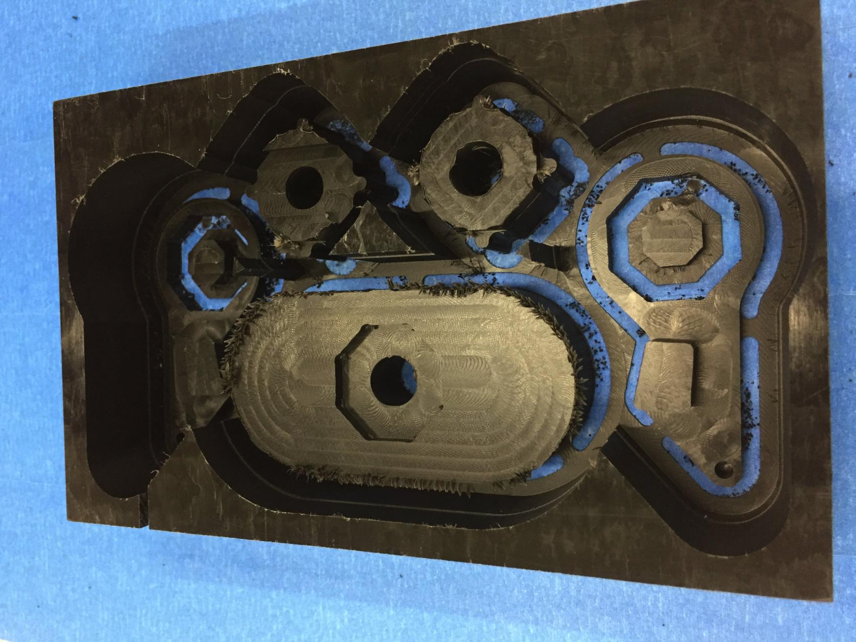

    We have a vacuum table, but I find we were using 23ga pins out of convenience (odd sizes, etc) - if the bit hits a pin, not the end of the world, and they are easy to pull.
    However, I ran across this video that changed everything for me:
    https://www.youtube.com/watch?v=ub6PsY4cgwg
    To be clear, I have extensively used double sided masking tape a lot with some success, but some failure as well. And it's just too expensive. There is often no way to get really good "rub the adhesive into the part/table" contact on one side. You can beat the hell out of it with a mallet and hope you get good contact.
    This changes everything, and I'm holding down things (without clamps) that I never would have attempted (see photo attached). That entire block is all of 3.5"x5.75". With the method in the video, you can really work the tape into both the part and the table, then use a medium or thick CA glue to secure the two. The glue makes up for any unevenness in the union where the double sided masking tape failed. And it's way way cheaper even with double the run of tape and a line of glue.
    Once the part is done, it takes a rubber mallet to shear it from the table, but the tape just peels right off, no residue on the part or table. Or on larger parts, just use it in the corners, center, whatever.

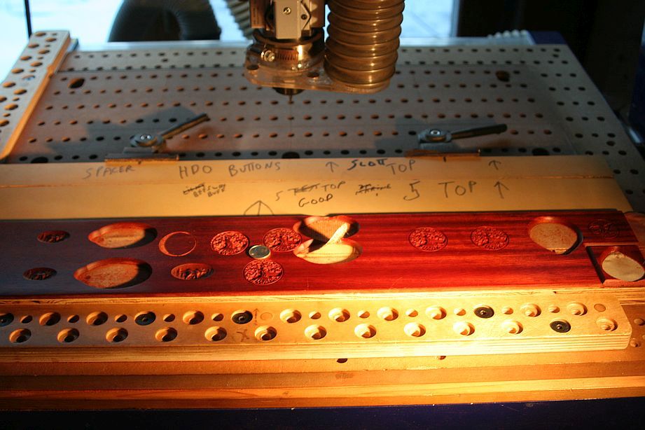

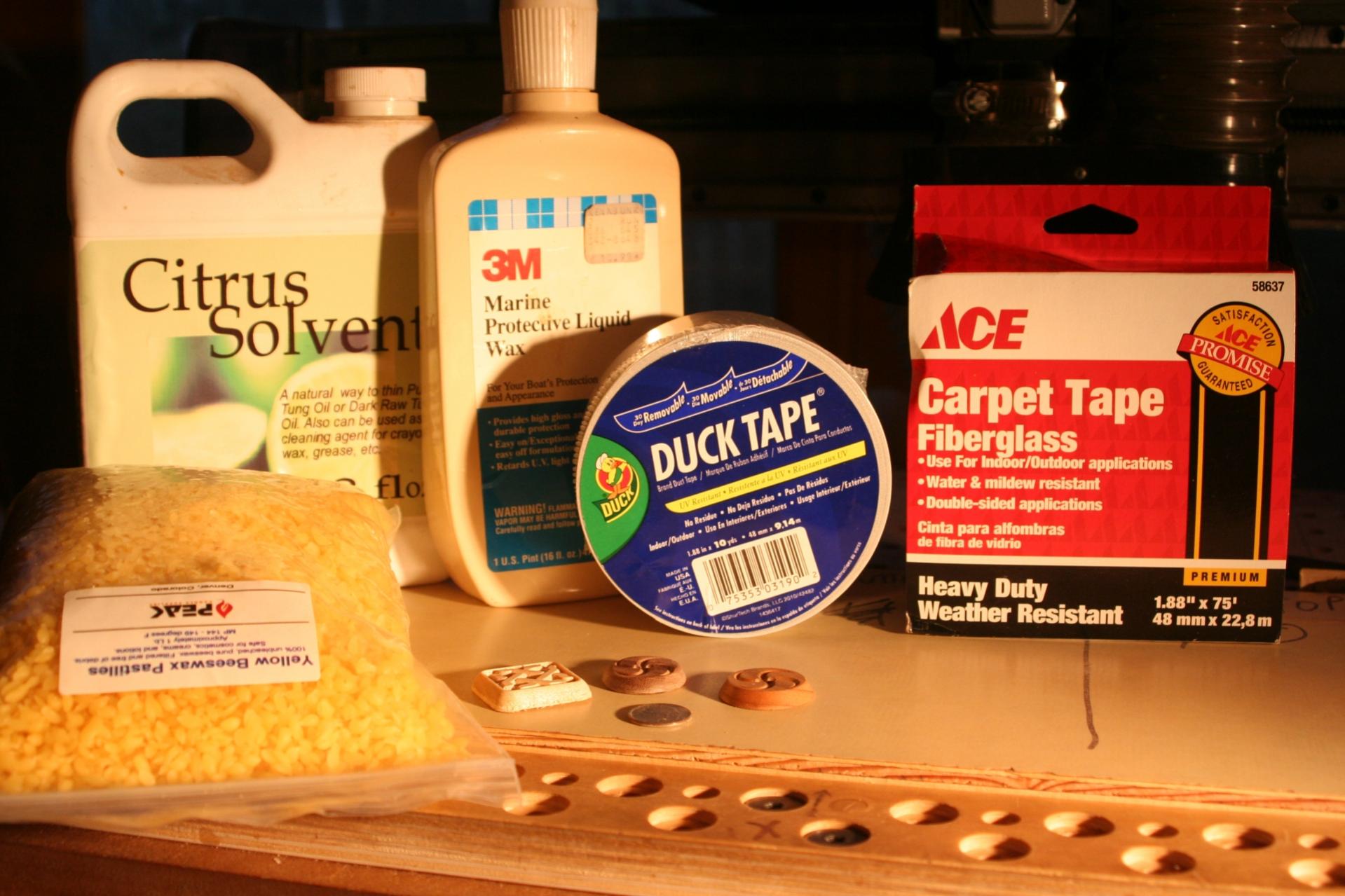

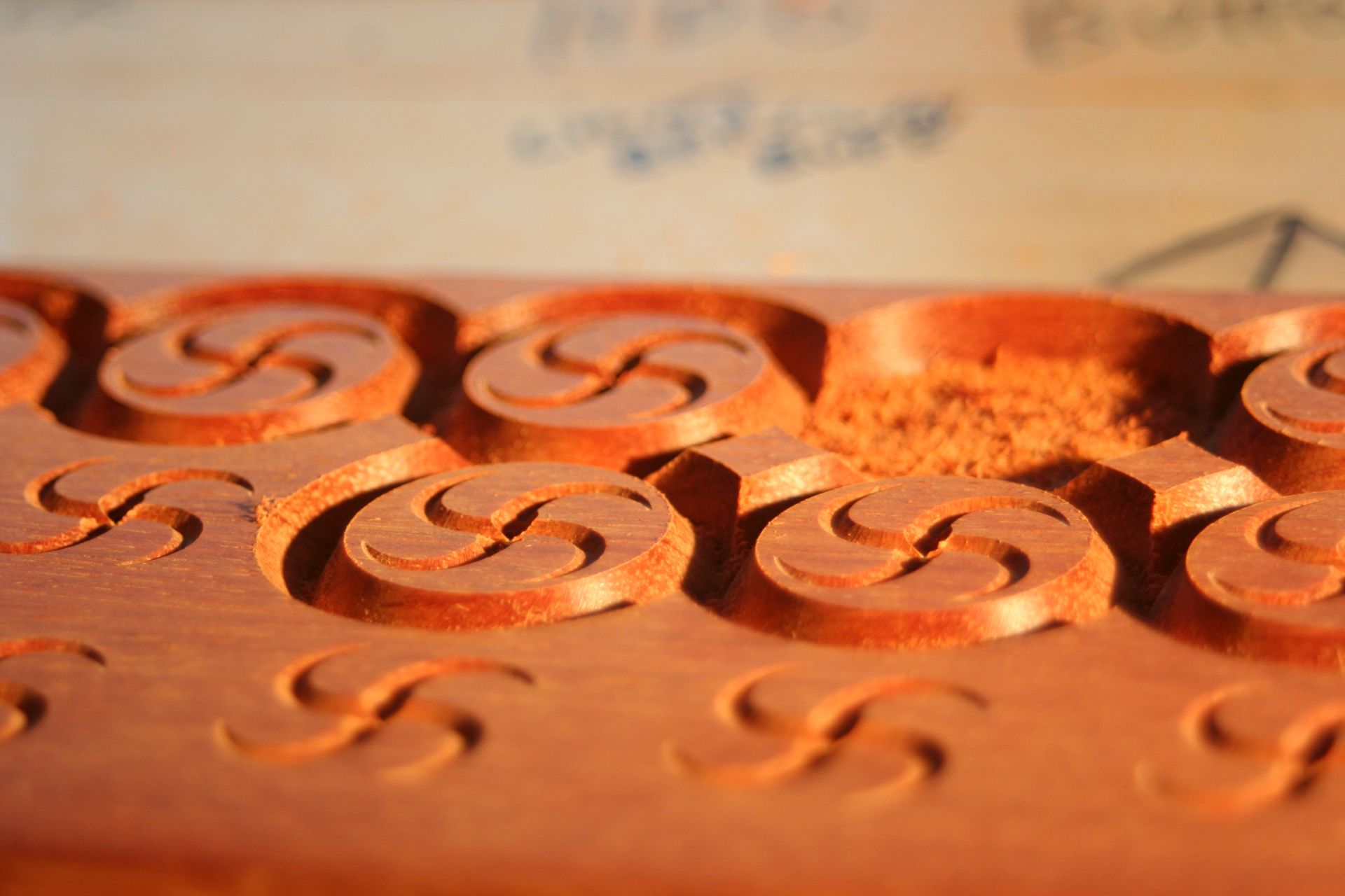

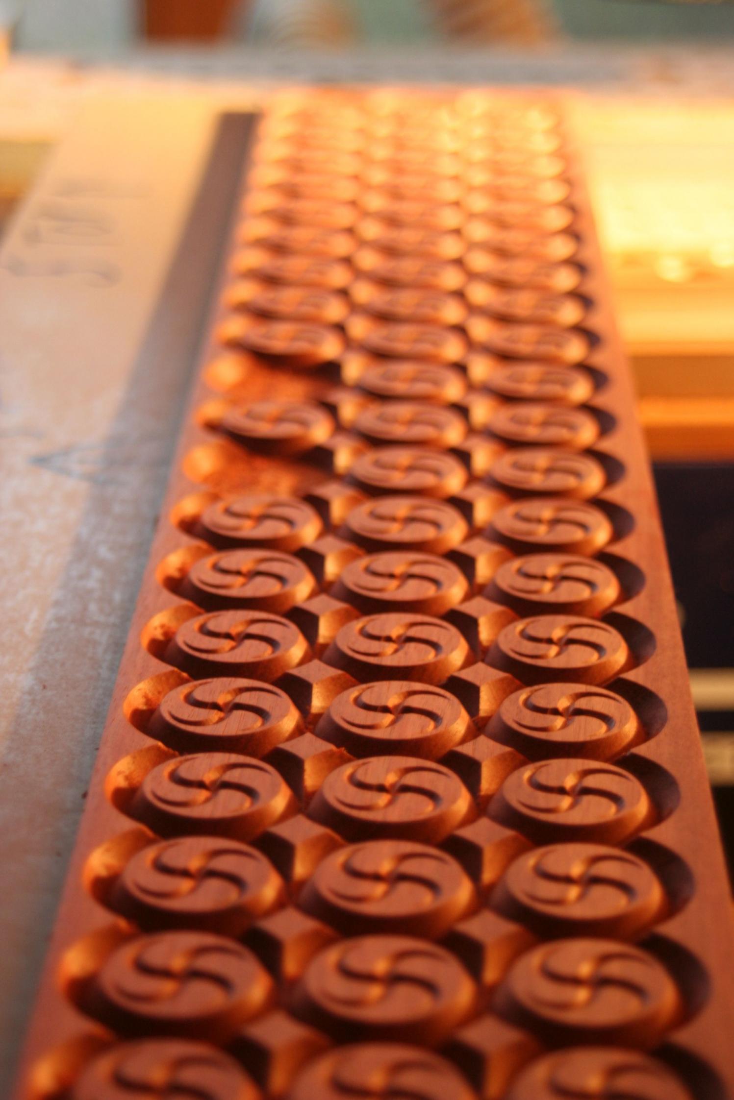

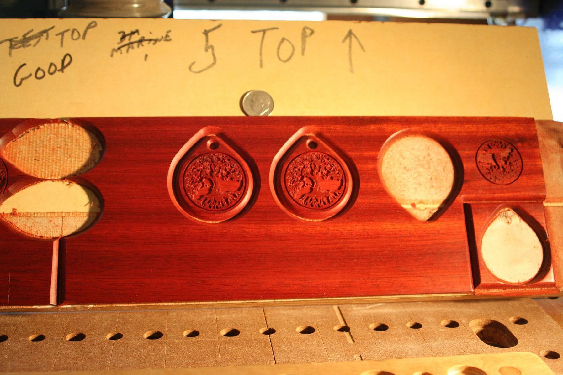

    Had VERY good luck using the carpet tape shown(1.88" width essential)/ and the "No Residue" Duck tape on a surface like HDO(waxed) or lacquered/waxed wood.
    "Bonnie" buttons were .75"D, and the Bloodwood "Trees" were cut Monday and no residue even though that Bloodwood has been stuck down 11 months(AND STAYED stuck FLAT) and were cut out using a .5" (.25"R)pointed round over bit.
    The trick is to cut only into the no residue tape, and to make last pass less than .01".
    I don't know, but works great for me.
