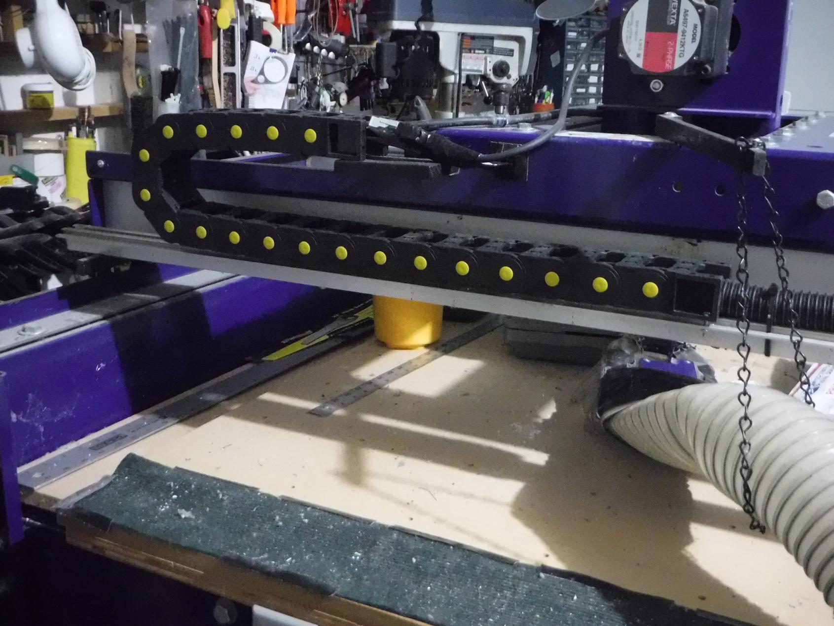

    "Wire springy acrylic thing" gets replaced by "E Chain". You can find it in lots of places. I have bought mine from SHopbot. You can make your own bolt on anchors in aluminum if you like and buy echain from all sorts of vendors. Search it on ebay and McMaster and marketplace, etc. You may want one along your y carriage as well as along the x axis. Again: PRS and PRT are different set ups and I can't help with the design on that style. I only have my Y carriage done on this machine, but my last one was on X and Y...

    Default carrier chain
    this carrier chain works well ... I still like the dust going out the back with a few supports to the vacuum hose
