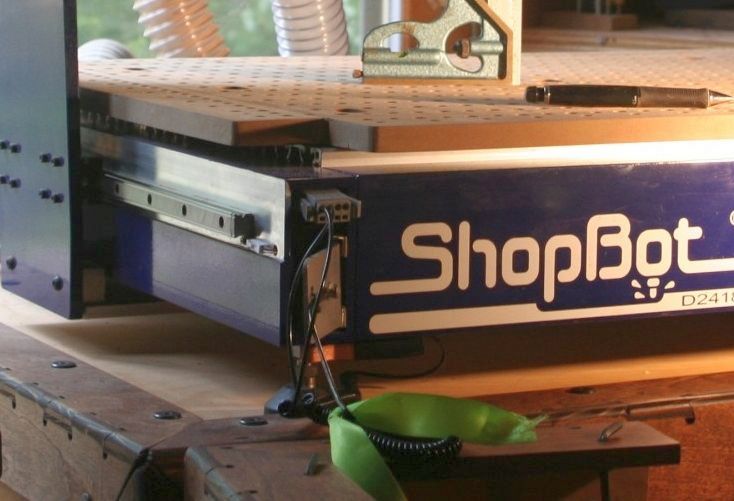

    You'll need a straight down close-up pic of the Z-rail to get the right kit(although Nate might be able to tell from the original invoice from the previous owner?)...There were 2 different rails in 4"Z Desktops.

    So I'm gonna have to admit ignorance here... Even though the owners manual says 4" of Z travel my machine seems to already have 5.5", I'm still waiting to here back from Frank to verify but is my logic here sound? I have a 3/4" spoil board and a 1.5"/1.6" tool and I end up being able to achieve a little over 4" of upwards Z travel before I run out of room. It also has a Z proximity switch which from what I understand the 4" machines didn't have. So if this is all correct, then what is the purpose of the Z (or any) proximity switch? Because when I drive the Z upwards it still tops out and makes horrible noises, is there a way to set up the Z proximity to be a stop switch or is that not how they work? Man, I have a lot of learning to do
    4,420
    Josh,
    The only way it has the Z-Prox is if the person asked for it to be added at the factory(or did it themselves) on the 4"Z like we did.
    The 5.5" Z that came out as standard in April 2015(?) already had it installed.
    Sounds like you have the 5.5" with a 4" manual maybe.
    Enter VN and make sure Limit Switches are "On" (ignore my switch settings as we had them mod us for 3 extra prox's and a fabbed spindle interlock that they had never done before and Gordon wired it differently).
    Run a TS (Tool Setup) again, and on the third page(?) checkmark the "I have Z proximity switch" box.
    If correct, then using the arrow key up...the machine simply stops when it hits prox.
    Then a Z-Zero routine will go down/touch plate twice/pause at whatever you have set for Safe-Z in VC (Value Cutter)/continue up to prox/then retract 1/8".
    NO hard stops(and saved my rear end just yesterday) and no lost position.
    On spindles, the 4"Z had a dust shroud, that was eliminated with the 5.5"Z, but not sure what the router model looked like
    Sales or support should have the info if you give them the original owners name.
    Oh, on both our Desktops we found we could leave the alligator clip attached to the leveler leg, and when we touch plate to the bit(EVERY TIME) we get a green light on input 3 in SB3 panel....Not sure with router, but you may want to see if there's a place on your machine for the alligator clip to stay permanently where you get the green light continuity check. Green light= good to go.
    Saves a lot of time not having to clamp it on bit or the nut every time.

    I also sent Frank my serial number and the original customer name to see what they can pull up. It might be possible that he (the original customer) told me the incorrect purchase date. I searched youtube for ShopBot Desktop and found some videos from 2014 and earlier with routers and they had the dust shield. This machine didn't have a dust shield and the original owner verified it never did, that along with the z-prox switch leads me to believe that he bought this more recently than he thought, which is good for me!
    I'm going to play with all this stuff when I get back on Saturday, I'm leaving tomorrow around lunch time to plow through the snowstorm to Durham. All of the info you gave me has been extremely helpful and makes total sense, thanks again! I love the alligator clip trick too.
    Two more questions for you, I see the extension on your bed, is that just for support or do you cut out there? And on your set up you have the x/y axis .5" larger than the bed and the z at 8", is there a reason for this or do you just do that so you get full travel and let the prox switched keep you from hard stops?
