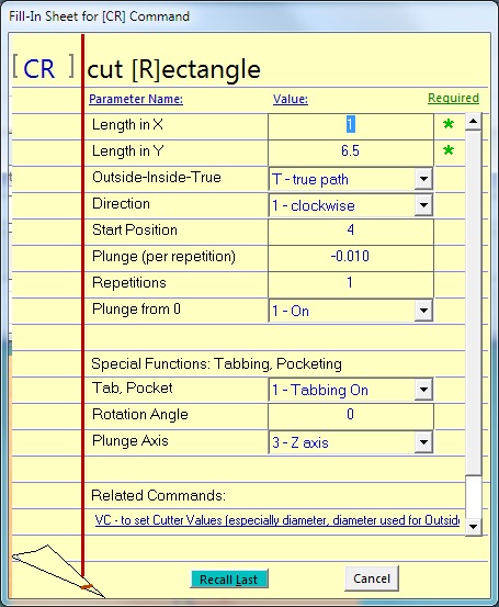

    Ok, this card works. It cuts a 2x2 rectangle 10 mils deep, just like it is supposed to.
    CR,2, 2, T, 1, 4,-0.01,1,2,1
    This card does not. It "cuts" an air rectangle 1" ABOVE the work surface!
    CR,1.0, 6.500, T, 1, 4,-0.010,1,2,1
    I don't understand why, so I try the following.
    CR,1.0, 6.500, T, 1, 4,-1.010,1,2,1
    And of course, it jams the bit down through the work piece into the spoil board, trying to reach 1" below the surface I reckon. Fortunately nothing broke before I could get the thing stopped. Any ideas on what is wrong?
    Thanks.

    Looks like you have a parameter off.
    The fill in sheet for CR using your parameters, gives the following code:
    ---------------------------------------CR, 1, 6.5, T, 1, 4, -0.010, 1, 1, 1, 0, 3
    Now here's your code: -------------CR, 1, 6.5, T, 1, 4, -1.010, 1 ,2, 1
    A value for Plunge from zero of "2" is invalid. It can only be 1 or 0, respectively; On or Off
    I realize you wanted to go 1.01, not .01...but you get the general idea.
    There ARE cases where the spaces matter - so don't discount that if you are tinkering with canned routines like CR. Lack of discipline with spaces will bite you...be consistent.

    Default found the bug
    I found the bug. Before I forget, I need to explain what went wrong so it doesn’t bite someone else. Fortunately it doesn’t appear to have damaged my machine, but it certainly could have and came very close.
    If you put a -0.000 for the plunge depth on a Cut Rectangle (CR) card, it will cut an air rectangle 1 inch ABOVE the zero elevation. I had put that card first to ensure that my initial surface was flat at 0.000, etc., and then interrupted the routine when I saw that it was not cutting at zero.
    The ShopBot folks might want to address this. Zero should mean zero, not +1.000!
    Thanks,
    BB
    PS. Thanks for those later replies. I'll try that too.
    PPS. I would also appreciate it if you two would independently verify what I am saying here.
    7,986
    I'm pretty sure that the 1.0" value is coming from the VC (Values Cutter) settings, which is why there is a quick link at the bottom of the CR fill-in sheet (card). You can change this to be whatever value you want.
    Also, the value in CR for Z depth does NOT have to be a negative number. It can be positive for verifying the cut via air cutting.
