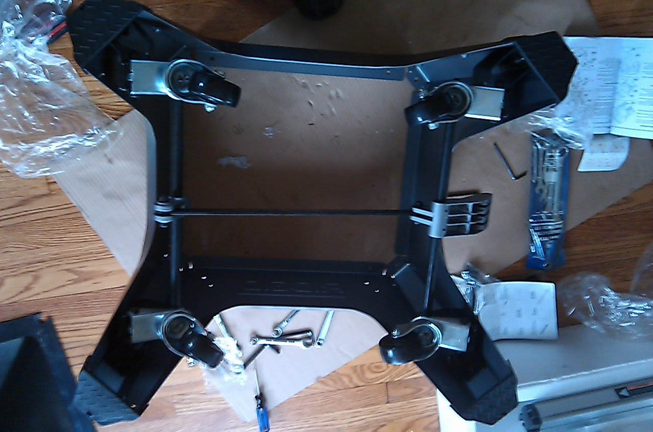

    Working on a podium - client is requesting a set of retractable casters so with the step on a single lever they are pulled up into base, lowering it to rest on it's own pedestal. A second step on lever lowers the wheels, essentially lifting podium up for transport. Idea is to keep casters hidden at all times and have a single pedal to actuate all 4 in unison.
    I know I've seen a framed system that does this, as well as my client, but having a tough time locating. All I'm finding are single wheels, in which all 4 must be individually triggered. Likely I'm just not using the right trigger words for web search, but words such as frame, system, set and unison are of no luck so far.
    Any direction for resources would be greatly appreciated.

    The Shopsmith looks pretty good, though a bit tall to tuck under as well as rigging a way to sync all 4. The setup in the Youtube video looks solid, but difficult to adapt a foot lever. While I agree with wayne's sense of simplicity and practicality, my client is uber particular. First request they had was for motorized.
    So far, it looks to me like the ridgid table saw base I found in an internet search under images looks perfect. One lever, all 4 casters, low profile, pretty simple. Problem is, you just cannot buy a kit to do this. Here's an image from someone's web documentation of assembling a Ridgid R4512 table saw base:
    I did look at ereplacement parts, and found a part number for this entire assembly. Unfortunately, looks like it has since been reduced to a 3 caster system, and the parts vendor popped up with a message indicating this part was extremely rarely requested, and indicated some research on their end may be required to verify availability.
    Still, hope someone may have run across a universal kit, as grim as the prospects appear at this point. Otherwise, I may look to having my brother (metal fabricator) quote a custom system based on this Ridgid system, which seems reasonably simple, if you follow general laws of physics. Just hate to kill a budget with excessive research.
    Final punt may be simply to get a brake foot to keep it still. Client says they have "leaners" who will prop themselves against this podium as they speak.
