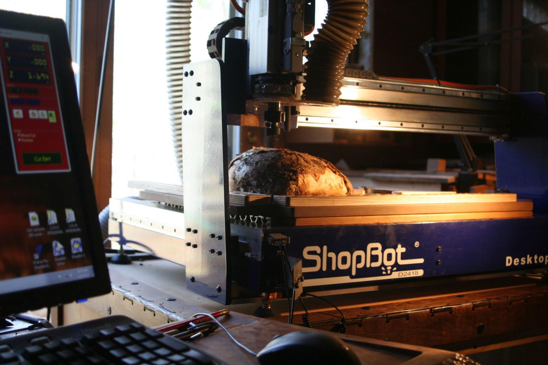

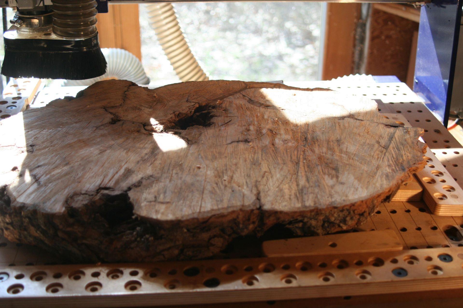

    Met a guy at Leo's unofficial meet and greet last summer...not a Shopbotter(DIY), but hit it off.
    Brian has been dropping burls as gifts, and I've been stuck in bed for a month, so first time back in shop I decided to surface the biggest burl to max thickness just to see what I had to work with

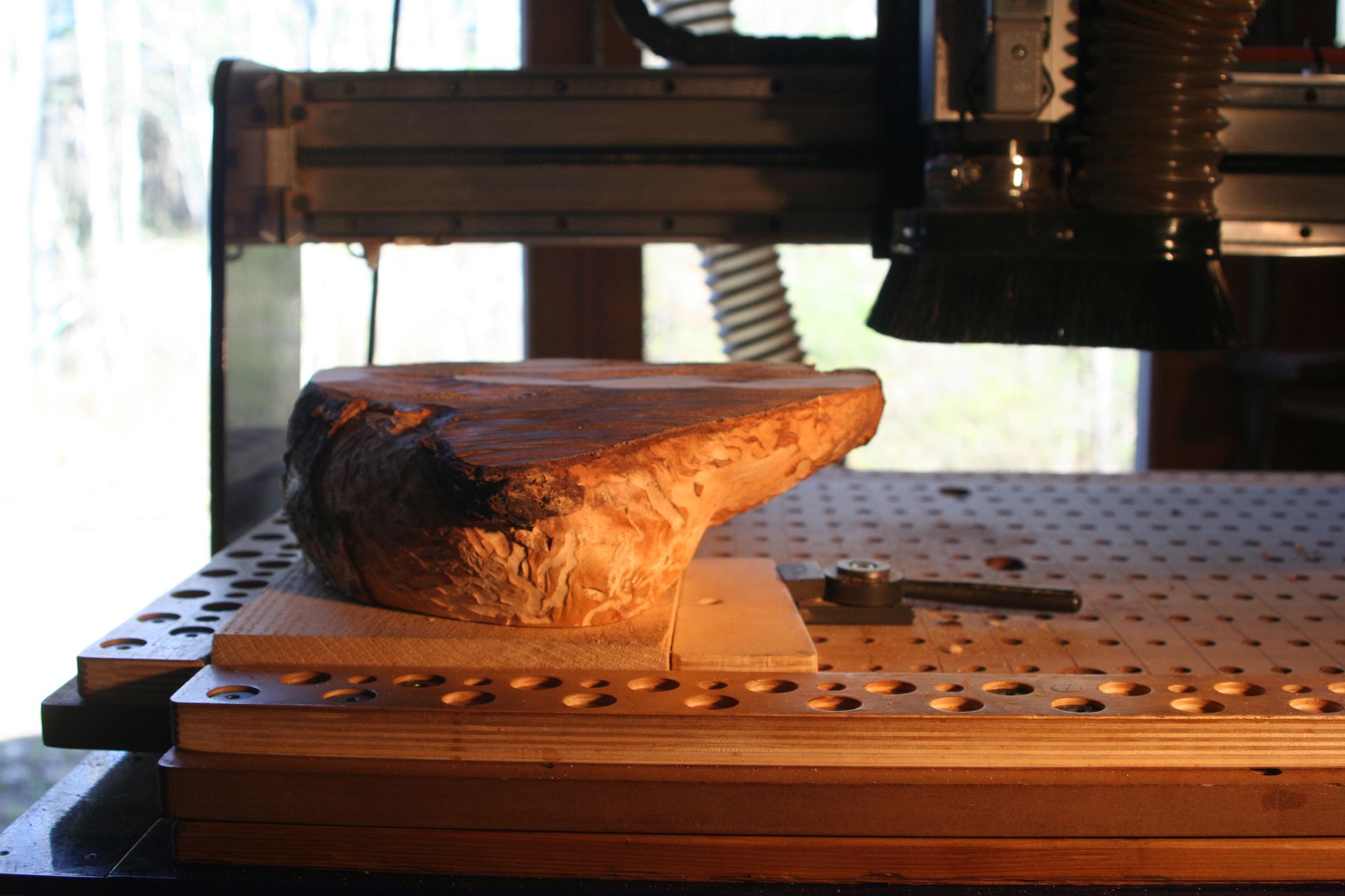

    First thing was it was 1" too tall for my shortest bit...timber framing chisel made short work of that.
    Then changed my VC "safe Z" to .01", and in my VCP material set up I changed Z1 and Z2 and home position to .02".
    Eyeballed the thickest point and my cutters CEL, and set my Z there.
    With the Whiteside 1.25" mortise bit the Desktop easily handled 3IPS .2" pass depth at 30% stepover at 15K.
    I just MN'd down with a one pass pocket toolpath so I could see what the grain was doing.

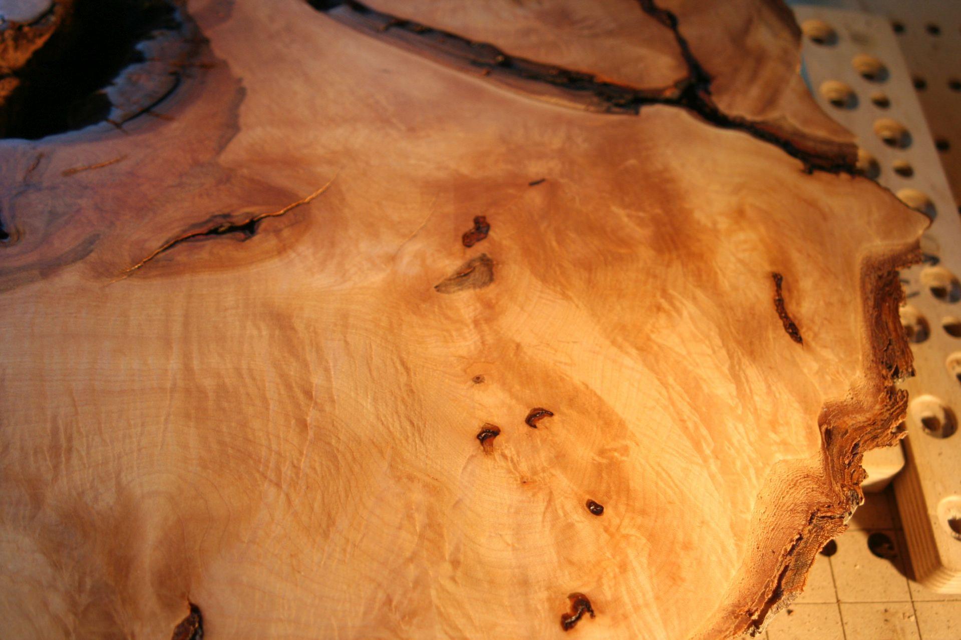

    NICE to get back into cutting, and see grain emerge!
    The tree side has major holes and bark intrusions, and thinking maybe trying infill ala Steve G.
    Going to go over it with dental pics/etc. removing loose bark while it moves to its final shape, so I can go final depth depending on if it wants to be a side table with live edge Black Walnut legs I've surface that were firewood.
    Heck...Maybe it wants to be something else
    Made me smile while it was cutting!

    4,401
    Brian,
    What species of tree was the first burl you gave me? Yellow Birch?

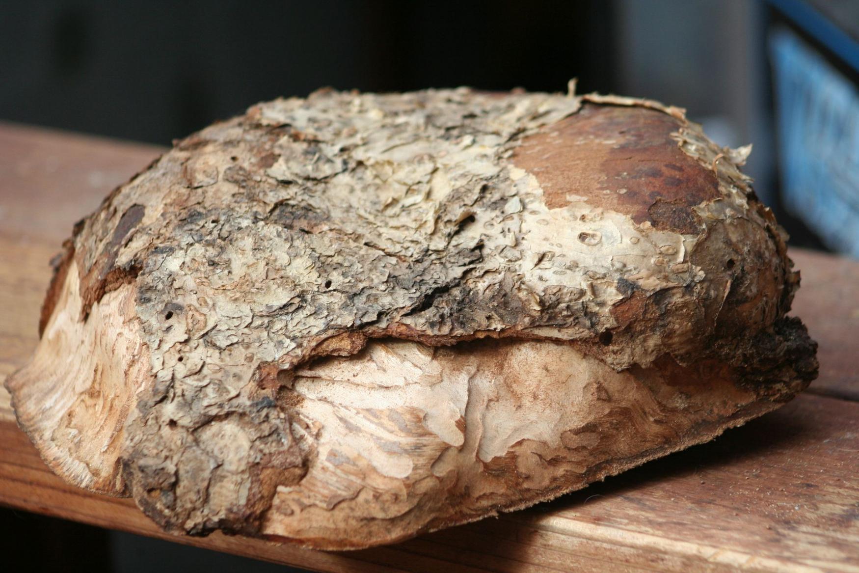

    That crazy method of linseed waxing the bare wood/floating in water for 24 hours/freezing for 48 hours/ and then setting in the sun in 80-115F greenhouse for 3 weeks loosened most of the bark wonderfully
    Insects had gone crazy just under the bark, and I'll probably use 3M 400G radial bristle discs to burnish after I get the loose stuff and the rest of the bark off.
    Taking the bark side down let me spud most of the bark off with those Ebony wedge scrap shapes.

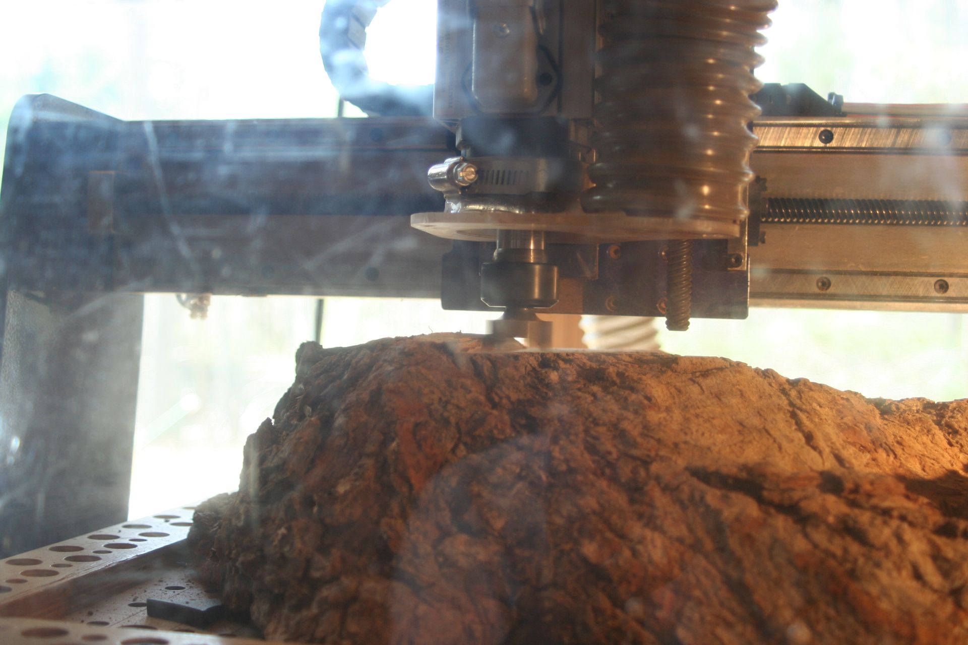

    I mucked up when I flipped it and used 3 year old rockler CA on the carrier board
    Super light .03" passes at 3 IPS, and then almost as I was totally finished I saw it move!!!
    It was solid when I started, but then loosened up???
    Shifted it and reclamped...but I'll wait a couple hours before I finish it, OR reglue?

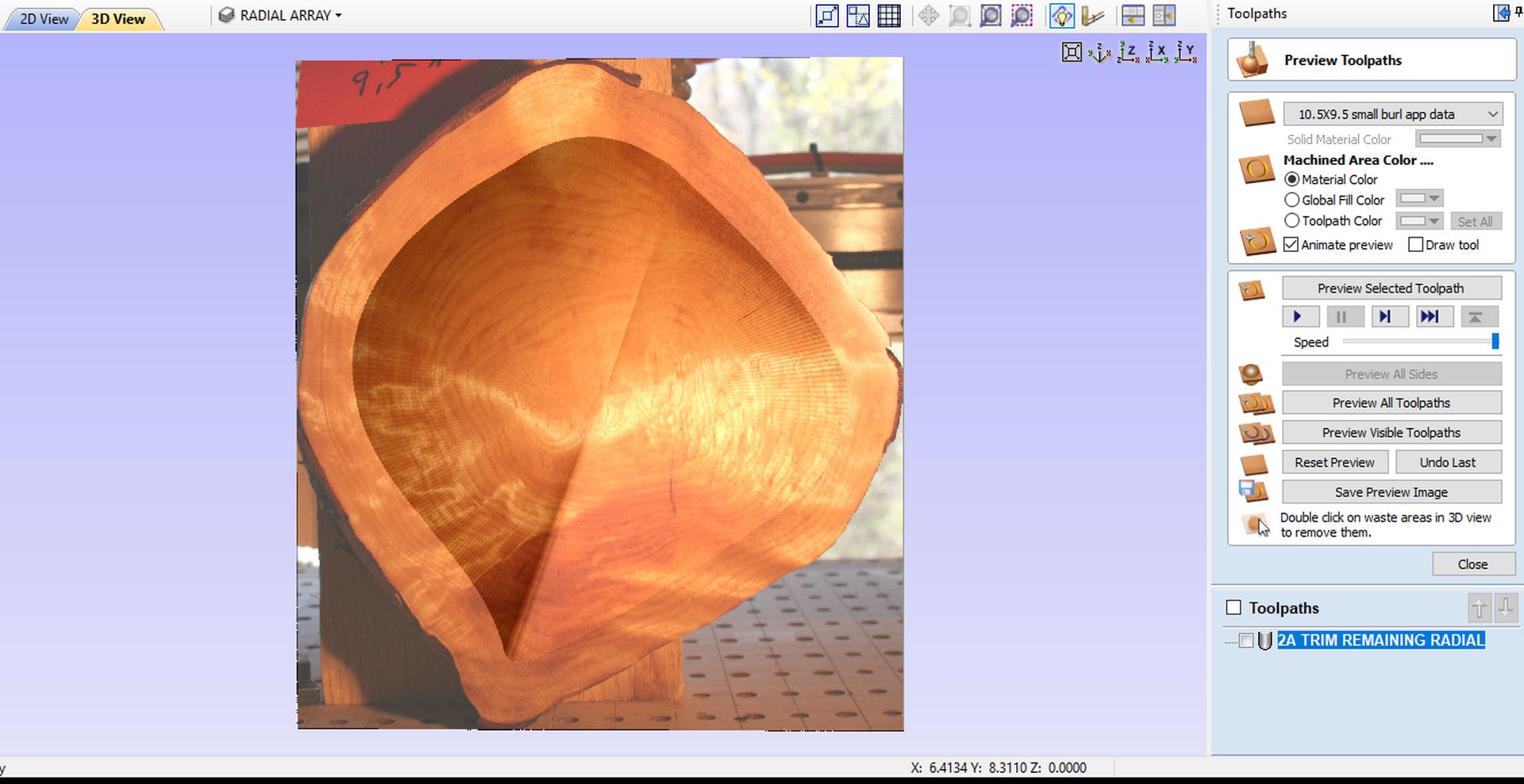

    This one definitely wants to be bowl.
    I'll probably take a pic and then put it in my App Data Wood folder so I can Play with it.
    Probably a circular array with the fluting toolpath /smooth/100% and then trim vectors to the shape.
    FUN!!

    4,401
    Awful nice words for this "Hobbyist" Joe THANKS!!
    When Dad visited last night he agreed with my friend from OZ that the "Grand Canyon" should be cleaned up and left as Mother Nature left it.
    Anything that moves with 90psi, or a bamboo skewer easily will be removed and then burnished on that big Maple slab.
    Judging what I got done in 2 hours this morning...I won't lack for something to do while something is cutting
    The smaller burl doesn't have much in pattern, BUT the chatoyancy(Cat Eye Fire) is GREAT
    The worm holes will be brushed and hand sanded burnished with all the bark off.
    Really haven't done much with VCP9, and it really showed....but this is roughly what I'm thinking....except smoother and tweaked.
