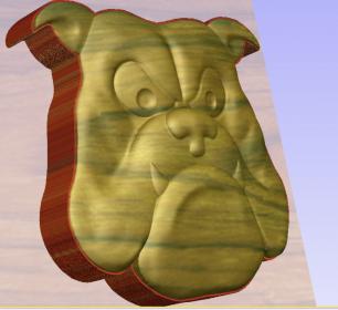

    shape height is how tall your 3-d component is; the more shape generally means more detail.
    base height is how high you would raise it about the base.
    in this example the bull dog is .8 of an inch in shape, but i wanted to raise it up an inch.
