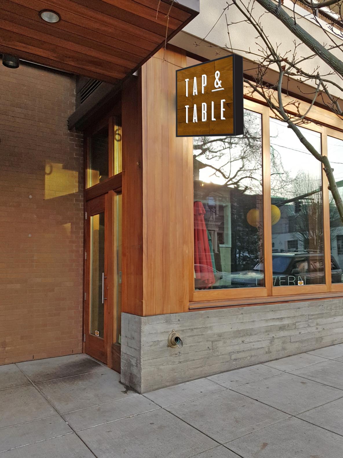

    I have a customer that wants me to make the faces for this sign. this is a rendering. his customer was a barnwood look and is willing to maintain it.
    but gluing barnwood onto say a piece of dibond is not a great idea. I was thinking of planing the boards down to 1/8" to make it a veneer and epoxy it onto a piece of 1/4" dibond then coat the face in epoxy then use a uv protection on that. I would also seal the edges after I cut through the face.
    does thsi sound like a good idea? would I need to laminate the backside too?

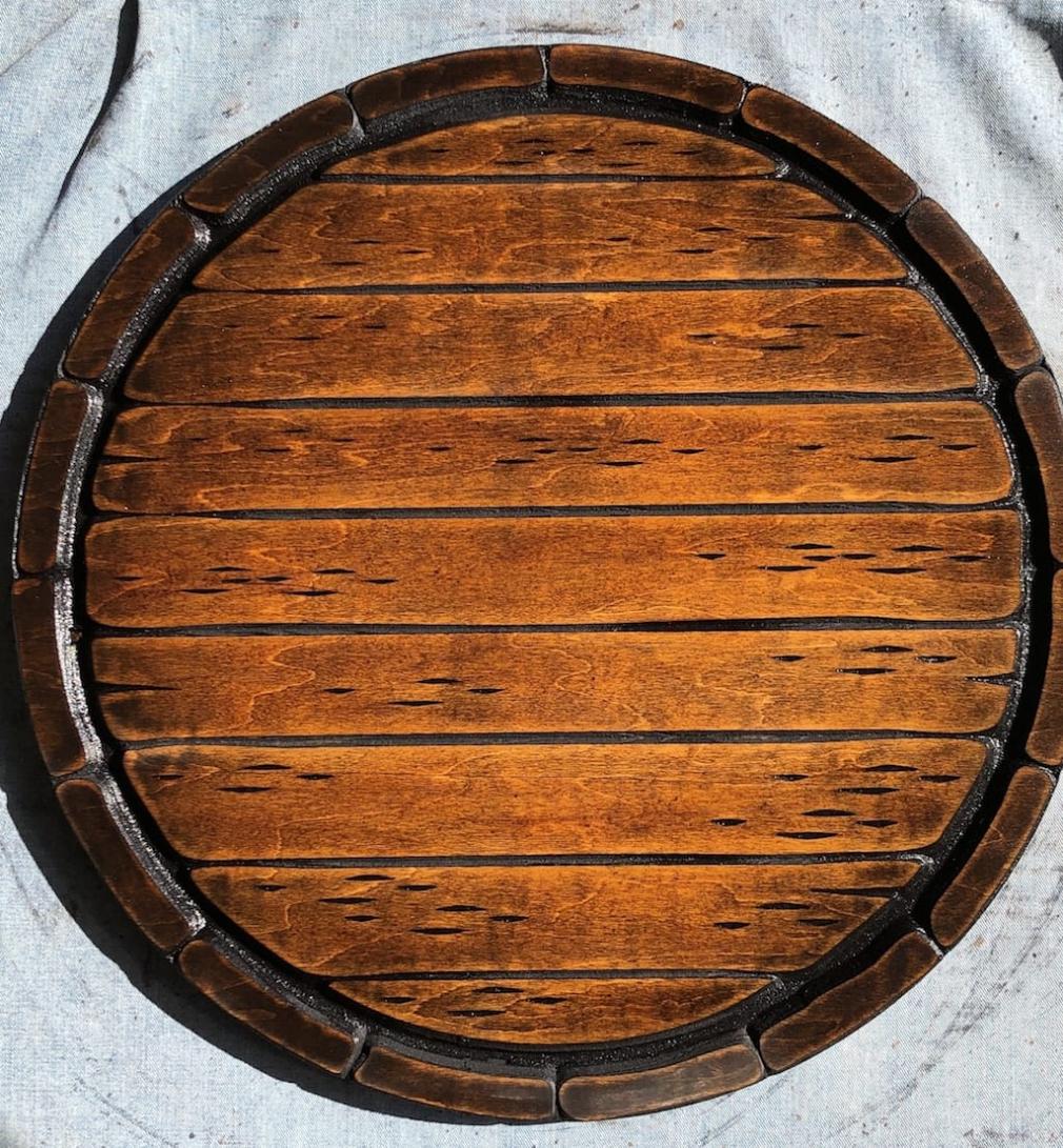

    We would use a sheet of Maple plywood, 3/4" thick. That would be two sheets for this project.
    1. Design the planks and cut them into the maple (to give the illusion of glued-up planks)
    2. Spray or brush the finished sign with lamp black stain.
    3. Sand off the lamp black with 220 grit (after it is dry).
    4. Spray or brush with General Finishes Pewter Die.
    5. Poly for a finish coat.
    Here we have designed and cut a wine barrel using Maple playwood. You could design and cut the planks. Actually, you can get wood plank artwork from vectorstock.com.

    I had thought of that.I can't do the painting though my paint skills are nil. but I will throw both at him.
    Quote Originally Posted by woodshop View Post
    IMHO...

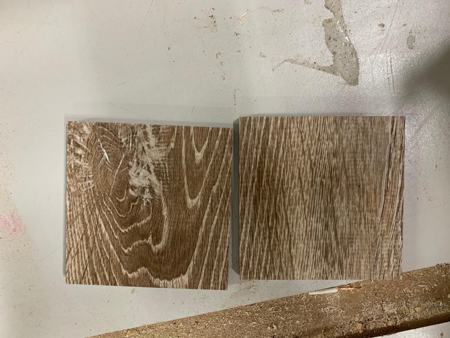

    my customer has been dragging his feet. but we were going to use some of this flooring from home depot. but another sign customer told me about precision board with a wood grain texture pre painted.
