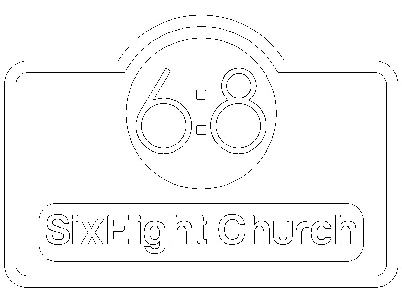

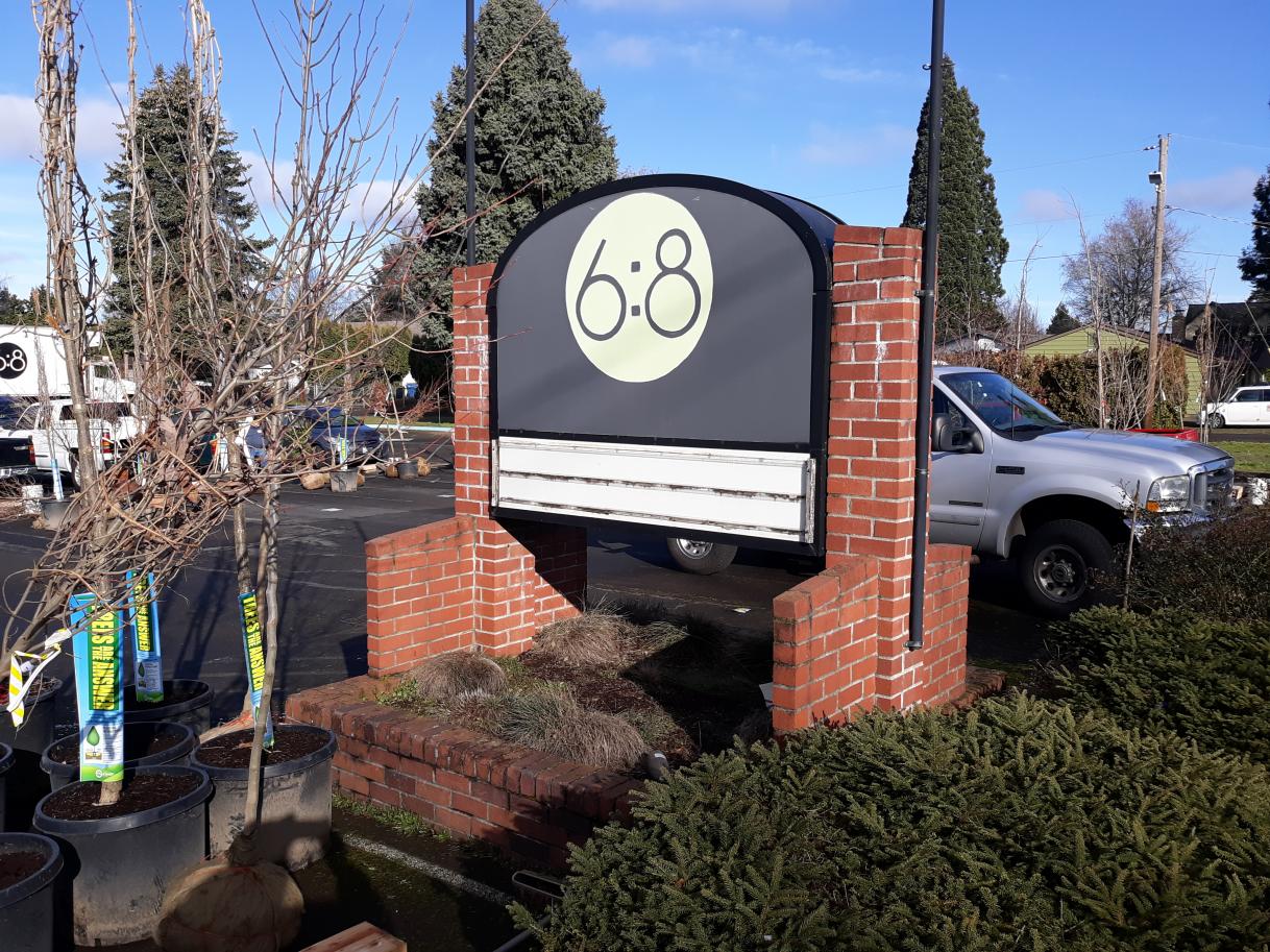

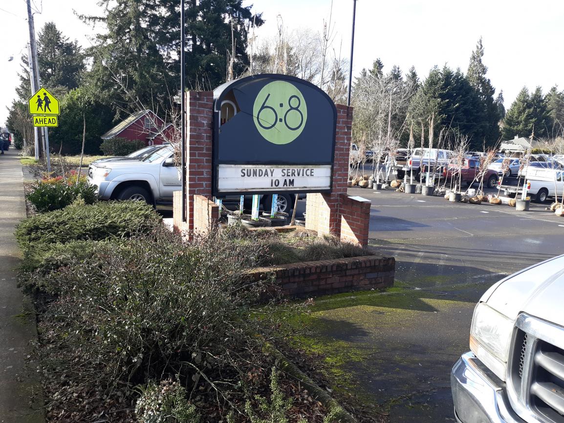

    I am trying to design and make a new sign for my church. Signs are not something I usually make. Cost is a factor we have a small church and funds are tight. The existing sign is broken but has a very nice brick base to work with.
    Can an exterior sign be made from insulation foam and sealed effectively?
    The sign will be about 68" x 47" overall. I will post some pictures of the existing sign and the current design that I made with my Pastor.
    I tried to post the image of the simulation that showed texture but the file was too large and it would not let me upload it.
    Thanks Mike

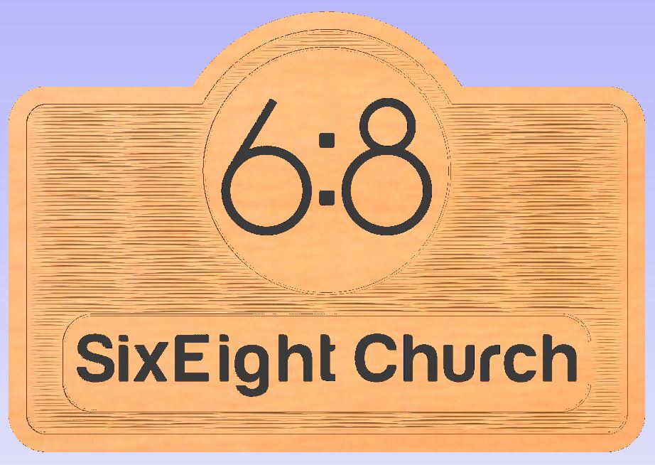

    Michael,
    "I am trying to design and make a new sign for my church"
    Wondering if this is Christian. The design doesn't look very spiritual. No matter what material you end up with, it's the design that rules.
    There's a world of decorative scrolls and designs that can be incorporated in the background. They are often used to support for a beautiful font. Your design needs a little Soul.

    Hi Joe,
    I feel the same way my Pastor likes it but to me it looks very amateurish I am not very artistic.
    6:8 is a Christian church the 6:8 is from Micah 6:8 "He has shown you O Man what is good to do justice, love mercy and walk humbly with your God".
    I was hoping you would see this and give me some advice to make a better sign. I don't like the font in the circle with 6:8 but it is the logo for the church. I did have some texture in the background but the bitmap image was too large to upload on here. I don't plan to go into sign making but I would like this to look as good as possible.
    Thanks Mike

    Why not repair the old sign?
    PRS Alpha 96x60x12
    Feb 2008
    Miller Marine Products, Ridgefield Washington
    877
    Quote Originally Posted by coryatjohn View Post
    It is in bad shape and hand painted over the old church sign (Whipple Creek Church). It is made from 1/4 plastic of some type and painted it has a large corner broken and was designed to be lighted from inside but we have lost power to the sign and the electric service runs under the church parking lot. The plan is to light the new sign with some solar LED flood lights. The brick base is in good shape and looks nice.

    Here is the image the software created. I have the latest version of Aspire. I have not added any color to anything but the font so it would stand out. I plan to carve the sign and let one of the other members paint it. This is not a paying job it is just me helping out the church. I normally machine mechanical type parts from plastic & aluminum.
