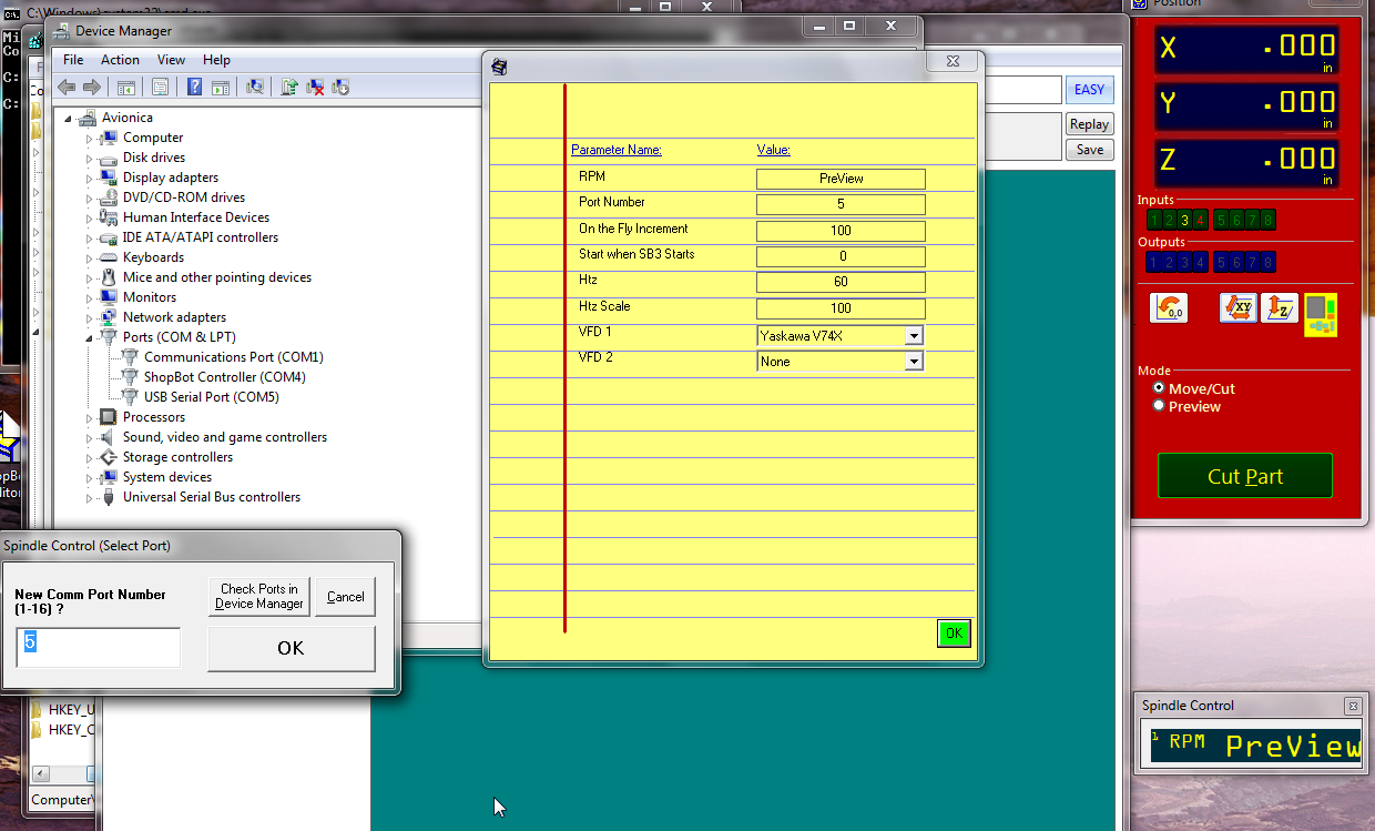

    So my trusty ShopBot computer bit the dust today. 13 years is a good run, right? (motherboard won't post...)
    Anyway, I get a replacement machine up with Windows 7x64 and after a lot of scrambling I get the machine to recognize my IUSB24AT RS-485 interface board - it's basically a USB to RS-485 box. It appears as COM5.
    When I ran the SBP software, I tried to pick COM5 for the VFD via the RPM tool's configuration screen. It refused to accept "5" for the port # - it never threw a dialog but, it never dismissed the configuration window on "OK" either.
    I cancelled out of it and the RPM tool went away. Now, nothing I do will bring up the RPM Tool! I can see the window flash on to the screen for a fraction of a second before it vanishes again.
    I'm using SBP v 3.8.50
    I NEED my RPM control. Help!

    Open regedit (click windows start and type 'regedit') and open this key...HKEY_CURRENT_USER\Software\VB and VBA Program Settings\ShopBot\Virtual Tools\Spindle Control ...delete that folder and then try opening SB3 and the spindle control window again.
    Do you have the drivers installed for that IUSB24AT RS-485 interface board? What SB3 version were you running on the old PC? I was using one of those several years ago and don't remember if it worked with SB3 3.8.XX.

    I may not be understanding your problem, but if your ShopBot is connected on COM5 then the spindle controller will be on a different COM port. You need to find the port that the spindle control is connected to and not try to set it to the same COM port as the ShopBot control card.

    srwtlc had the right idea. Thank you! (There's /zero/ excuse for using a VB6 program in production in 2019. As a professional software developer with 35 years of experience, this makes me angrier that it probably should.)
    After deleting the registry folder, my RPM control came back! Unfortunately, it's still not taking the port number as it should and issues no error message, just won't dismiss the form. (BUG!)
    Here's a screenshot of the issue:
    (because the forum software is mis-configured, I'm including a link to the image that's the original, readable size here: https://www.geneb.org/shopbot/rpm-screenshot.png)
    As you can see by the device manager listing, COM5 is present, however the RPM configuration screen is refusing to accept it. Is there a "debug" version of SBC available that will give me usable information in solving this problem or do I get to cough up $$$$$ to replace an RS-485 controller that functions perfectly because of a fatal bug in a $20k machine tool's software? (And yes, I'm kind of irritated right now.)

    Update - after being reminded that the application is written in VB6, I tried changing the device to COM2 via Device Manager and it worked perfectly. The "1-16" indication in the dialog box is misleading. It won't see any port higher than 4. (4 is used by the SB control interface).
    This really should be noted in the software.
