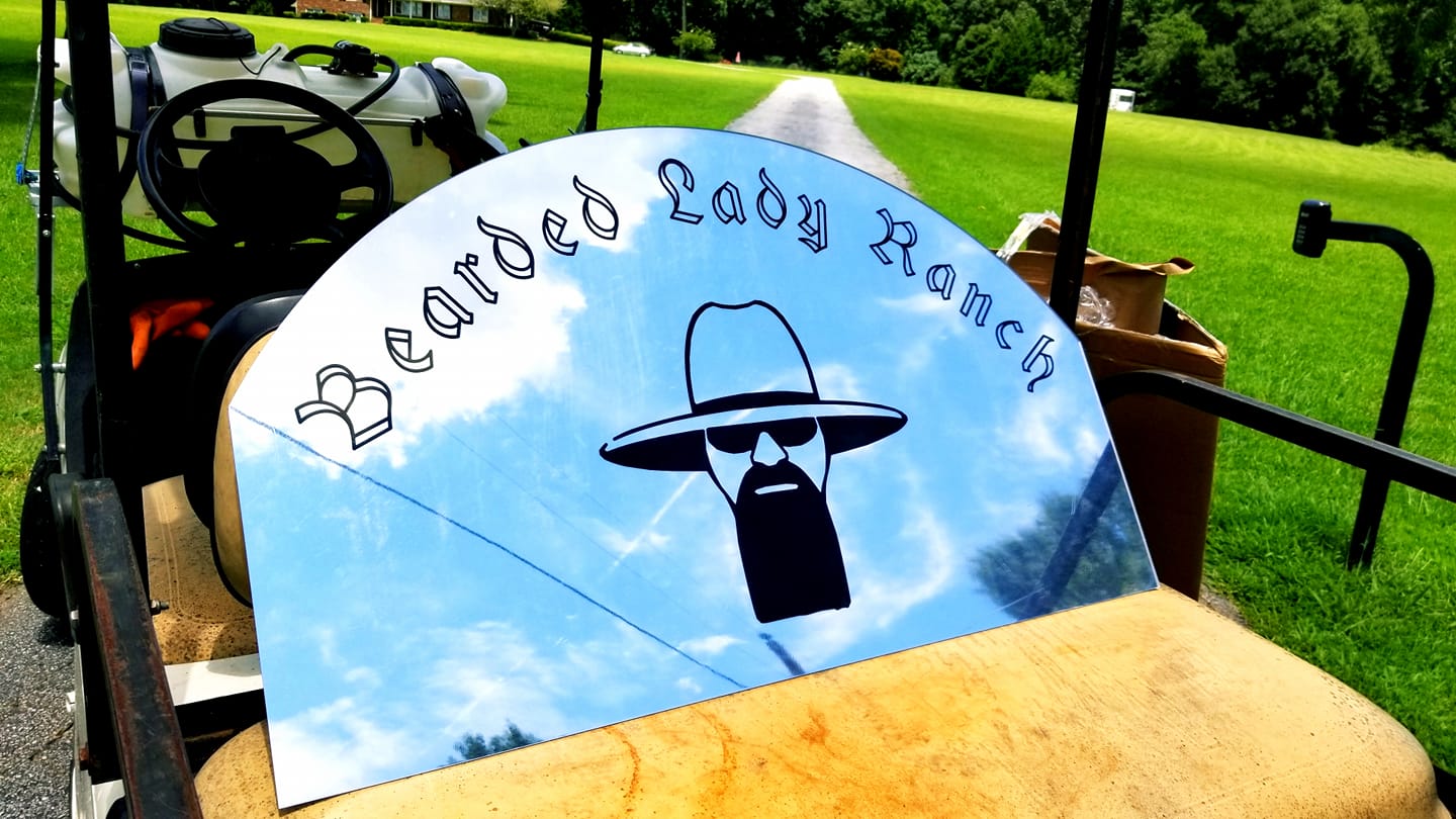

    Hi everyone.
    So, I have several different instances where I am cutting out acrylic mirror shapes, and also, need to "etch" shapes or words into the acrylic coating in order to paint the acrylic. Example attached.
    On that project, I cut a pocket in the coated side of the mirror about .040 deep using a 1/4" O-Flute bit. It came out great!
    These new projects are much smaller, so a 1/4" bit is too large. So, I'm using a 1/8" O-flute and having mixed results. Generally, when pocketing, I have it offset 80% of the bit diameter per pass (so, .1" in this case). The worst results come when choosing "offset". The generated toolpaths end up having some - I guess you would call it - abrupt direction changes, and that leaves small divots in the back of the mirror that show up through the paint.
    When I have manually offset the toolpaths, making sure there were no direction changes or Z-up and Z-down moves during the pocketing, results have been better.
    My question is whether there is a better bit to do the material removal on the back of the acrylic mirror to leave a more uniform surface? Also, do y'all think that "raster" is a better method for toolpathing for this purpose? I'd prefer to not have to create manual toolpaths if I can avoid it (time consuming).

    I have a vacuum system, so it's definitely not that. I even leave of dust collection so that it's not fighting the vacuum. I also recently skimmed the spoilboard.
    It seems to happen when leaving the software to generate the toolpath, and then it sometimes has the z-axis go up, move, go down, and the clear a small portion.

    First, set your tool to 40% in the tool database and unless you are cutting something really dense, like aluminum or brass - just leave it there. It is going to be the fastest/most aggressive setting for pocketing without leaving little triangular islands in the corners.
    Second, if you haven't already, go here: http://www.plasticrouting.com/BitSea...?Page=Material and enter in your material (or closest to what you have) and see what they recommend. I do know that Onsrud makes an O-flute specifically for getting a cleaner bottom finish. You're more than likely going to get a better finish using a multi-fluted O-flute vs a single O - spiral or straight. Don't underestimate the advantages of making friends with your local tooling dealer. You'll get better tools at better prices than schmucky retail - plus in many cases the professional answers you need.
    Lastly...Use raster for anything that people are going to see. The offset strategy seems to draw the eye to it - rather than your overall design. It has a regular look to it and is much easier to either camouflage or clean up.
