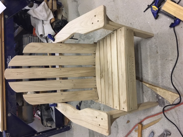

    My son and I built 3 Adirondak Chairs for a friend's cabin in Colorado. The wood is White Oak. "Splats", seat boards and arms are all 4/4 lumber ( some slightly planed to remove rough patches) . Back legs are 6/4 to make it very stable. IMG_9134.JPG

    Here is a shot of one of the assembled chairs before we put in the buttons over the screws and finished them to the same color as the body of the chair

    Of course, we had to make a prototype! (Which will, with its twin, reside at OUR house!)

    Looks great. What parts did you make on your CNC machine?
    Oct 2010
    TX
    797
    Phil We made ALL parts on the CNC. We did easing of edges with a 3/16 round over, by hand. All cut out, all pre-bore for buttons to cover the screws, the V-carve on splats and front kick plate, we all done on ShopBot. We got 1" x 12" x 16' white oak for the 4/4 material. And lopped them to 103" to do half the parts and then did it in two segments... I have 120" available, so it was easy for us. And having them all CNC'd made it SO nice to assemble....
