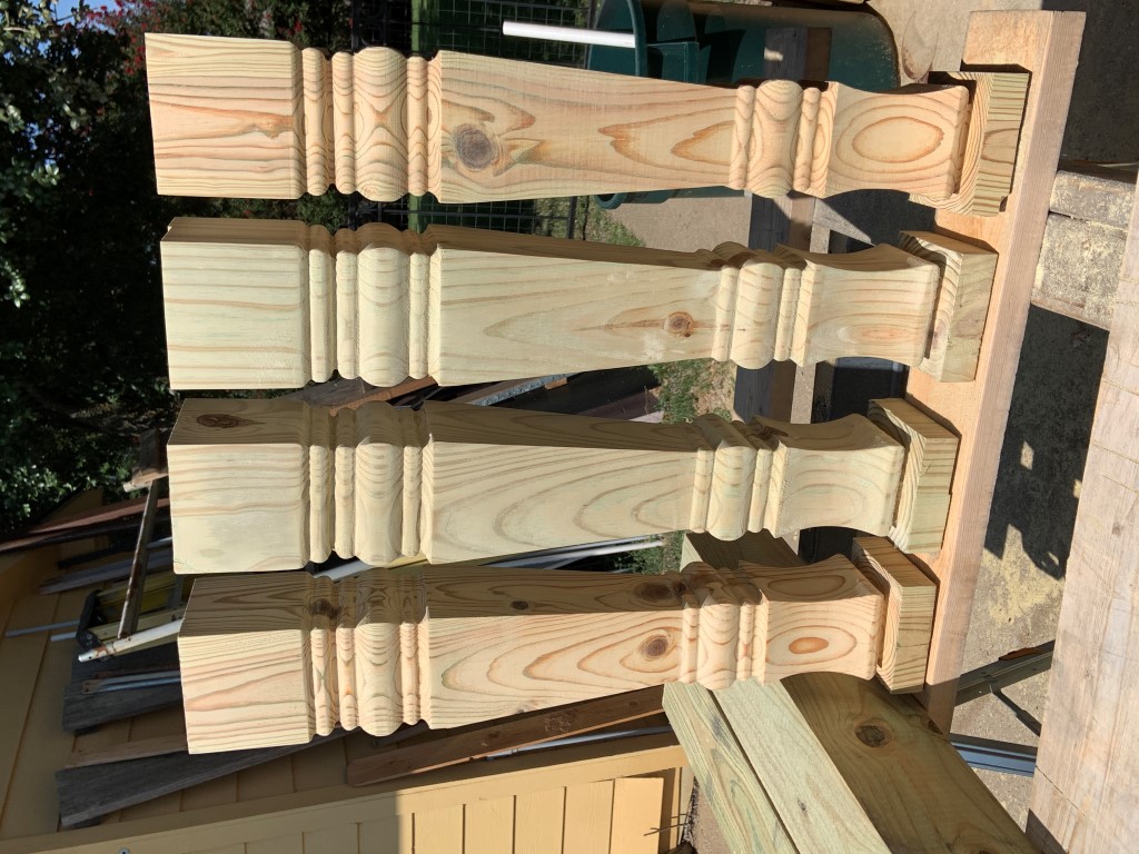

    I was asked to design/make a series of “Farmhouse” tables. My customers interpretation of “farmhouse” is long and narrow, thick top and chunky legs.
    I decided to try making the legs using the “moulding toolpath” feature of V-Carve Pro. This technique involves extruding a profile along a driverail…
    I made a prototype set of the legs for the customer to see, but mainly to see if I want to make them that way, they will require considerable machine time (turns out, about 6 hours for a set).
    I needed 5” X 5” X 30” blanks for the prototypes, The only thing I could find locally, fast, were 6” X 6” treated posts at the orange big box store… Blanks for the production run will be custom run at a mill…
    The treated lumber was VERY WET and machined very poorly because of this…
    However, they cleaned up nicely with a minimum of sanding.
    I’m pleased with the results, and I’m sure my customer will be also!

    Excellent to get good protos on first shot that look that good .....and certainly Sturdy!!
    He SHOULD like them!!
    What final woods are being considered?
    Well Done Steve!

    “What final woods are being considered?”
    Pecan, Oak, Walnut and Osage Orange!
    The wood will be, or has been, cut from his property. The Osage Orange (Bodark for you southerners) will be interesting! I’ll have to get a crane to move it!

    Those look great! I didn't know V-Carve could do that. Did you use a single profile bit or multiple bits with different profiles to cut those?
