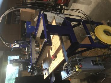

    I inherited a PRT Alpha (2004, I think) from my uncle who passed away. I’m brand spankin’ new to CNC, so I’m just learning the basics. It has twin z routers, but I cannot figure out how to control the auxiliary axis. Any help would be great. Thanks!

    Perhaps post a few pictures so everyone can see what you have.
    Jul 2020
    Appleton, WI
    4
    I am able to move it. I even cut the sample Shopbot logo this morning!
    Here are some pics of the machine. D1C27F58-B28C-48B1-926A-3CE6049D13BE.jpgBB4429EE-B3C2-4971-AE78-EF57E8B660B9.jpg0403BBDA-67BA-420C-A60B-04FF5DB6A9FF.jpg

    In the ShopBot control software under the “Values” tab. Select “Display values” this will bring up a list of option… don’t mess with ones you’re unsure about! On the “Number of Axes” line change it to say “4”, this will add the second Z axis as the “A” axis to your control pad. Also, when using the keypad to move, holding down the [ALT] key will now switch the arrow keys to operate the “A” axis.

    I was able to add the 2nd z axis and can move it. Thanks!
    Now if I can figure out how to zero it...

    Somewhere in the files you downloaded from ShopBot, is a file called “Azero”. You run that file just like it’s a cut file…

    Now… before you get in trouble… when you set up your bit database, watch the tool numbers you assign to them… bits 1-19 will cut on the Z axis 20-39 on the A (second Z axis).

    Just in case if this happens to be a new software setup, be sure to run Tools/Shopbot Setup to set the offset for the second Z. Just follow the prompts and instructions to work through it.
    If you were able to cut the logo, you may already have it taken care of.
