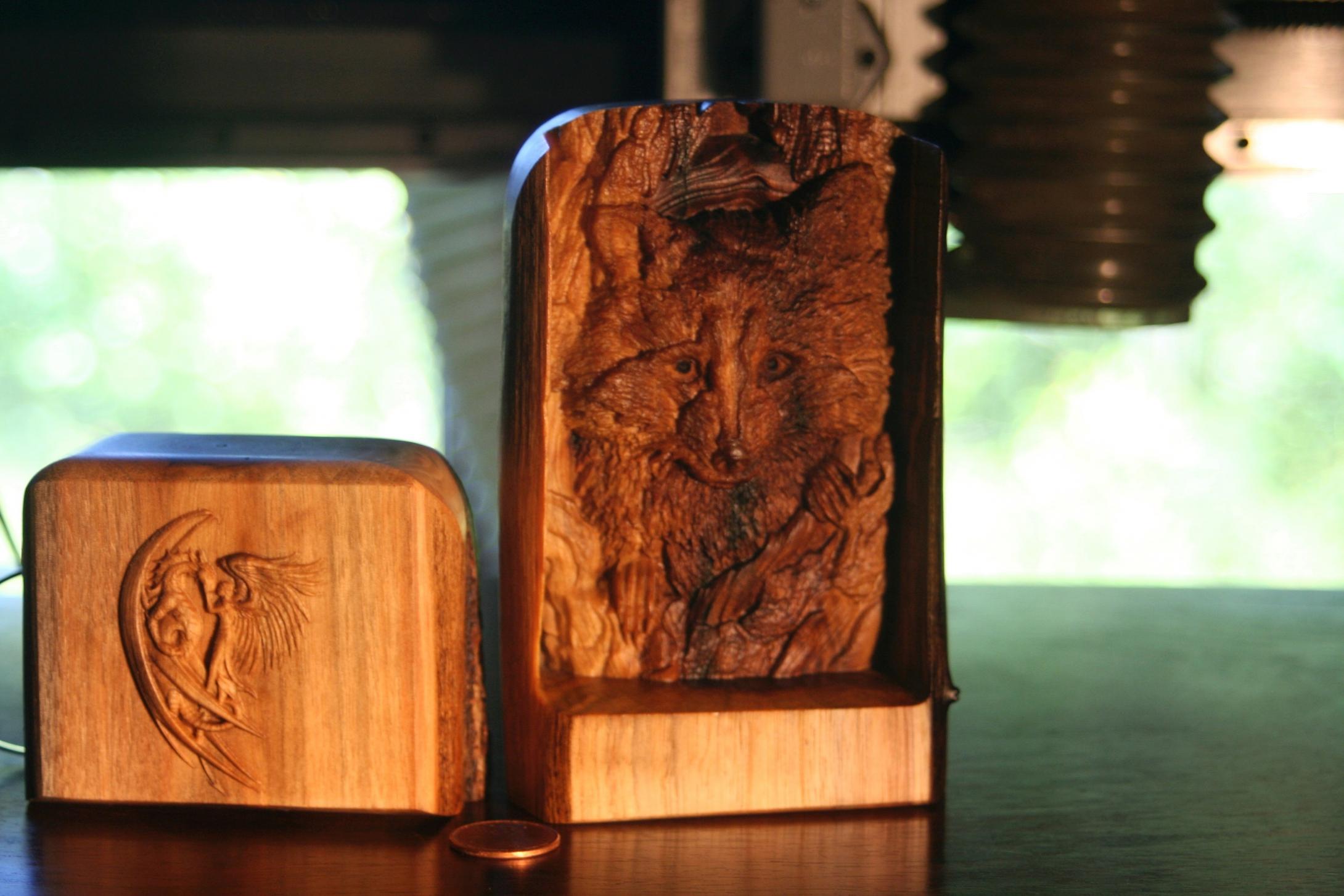

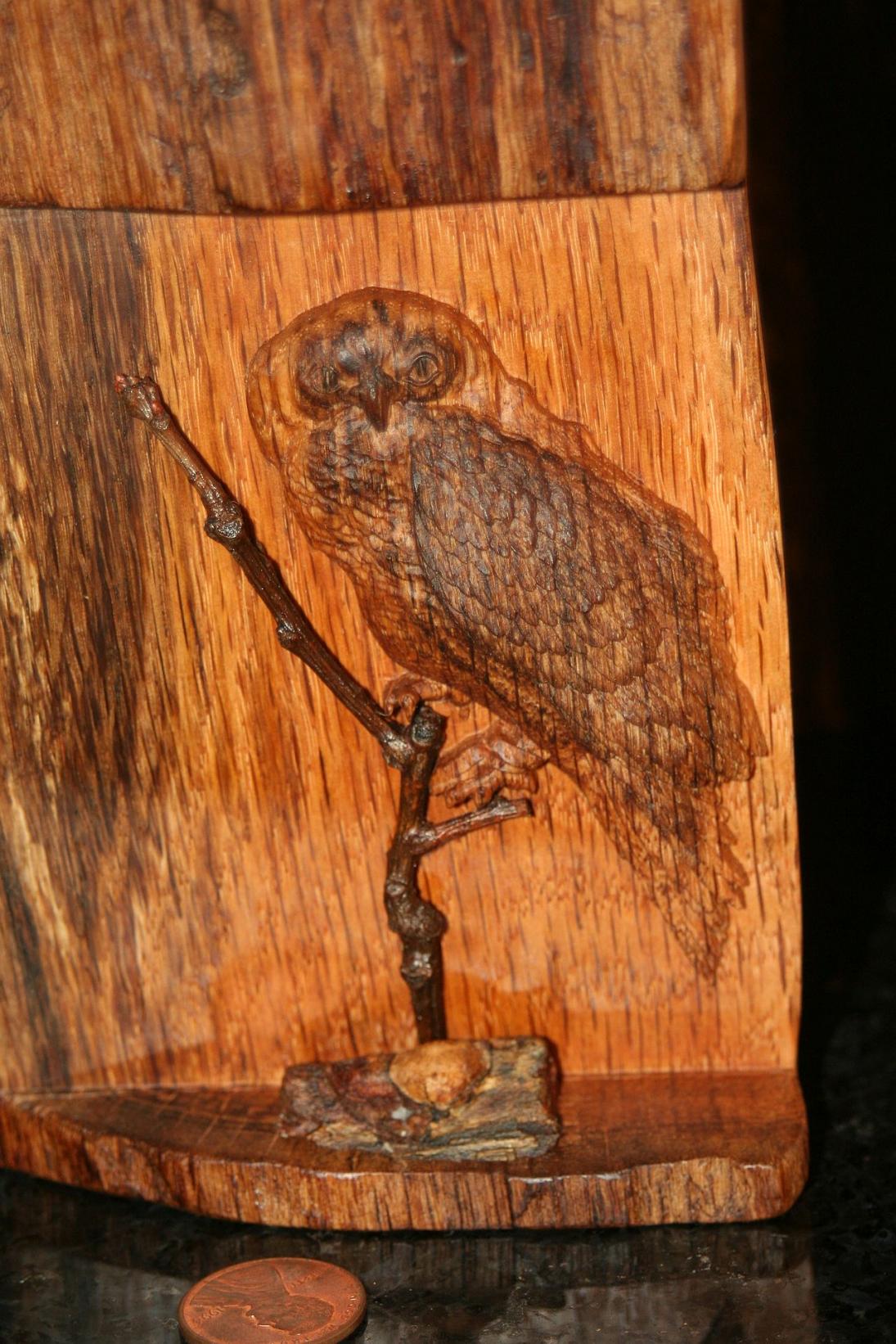

    Here are just a couple of detailed 3Ds, and the smaller fonts are generally .15- .2" font height(usually with the "Bold" option checked)
    A pic of the exact problem would help.
