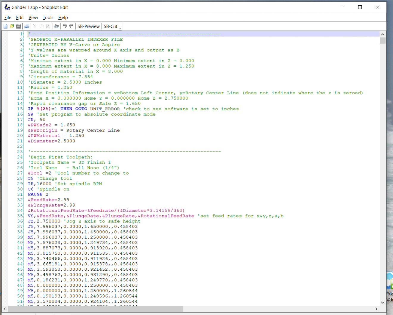

    This is the top of the SBP file.
    For some reason I am unable to copy and paste that file here.

    Post your cut file. The supposed problem is happening when the cut file calls up ShopBot's manual tool change file. If you were to comment out (') those calls in the cut file, how does it run then?
    Be sure to do this as an air cut, just in case.

    You can change it to .txt and then we can change it back to .crv3d or add it to the extension already there. The sbp file is just a screen grab, so try generating just a one tool file and then open it in the editor like you have there and put an apostrophe (') in front of the C9 and save. Do a find/replace to see if there are any other C9's.
    After that, zero out your tool manually like you normally would to start with and run the file (air cut with no tool). If it works/runs as expected, it's not your PP for VCP/Aspire, it's ShopBots own MTC file that is causing the problem. If they can't figure it out from that point, they can send their 6 week paycheck to me and I'll dig deeper.
    Yes, it that C9 is not there, the cut file will not ask you to change a tool, so you'll have to make separate toolpaths.

    So I deleted the C9 command in a part file, and the A & B axis did not change when I started the program.
    This solves the problem of the indexer moving when a program is called up.
    The downside is that I will have to create a new cut file for each tool in the program, not that big a deal as I typically only have a few tools in a program. At least I can use it now.
    Thanks all for the assistance.
    Perhaps Shopbot will come up with a fix that will allow for a manual tool change.

    Go to your C:\SbParts\Custom\MTC folder and attach the MTC.spb file you have. That is the file that is causing it.

    Just for curiosity sake, what is your B axis unit value set to? (VA, Values Units, B Unit Value)
    In both your videos, the MTC script is falling through the "Safe 5 axis" sub when it should be branching to the "Safe 4 axis" sub, which is meant to ignore the B axis.
