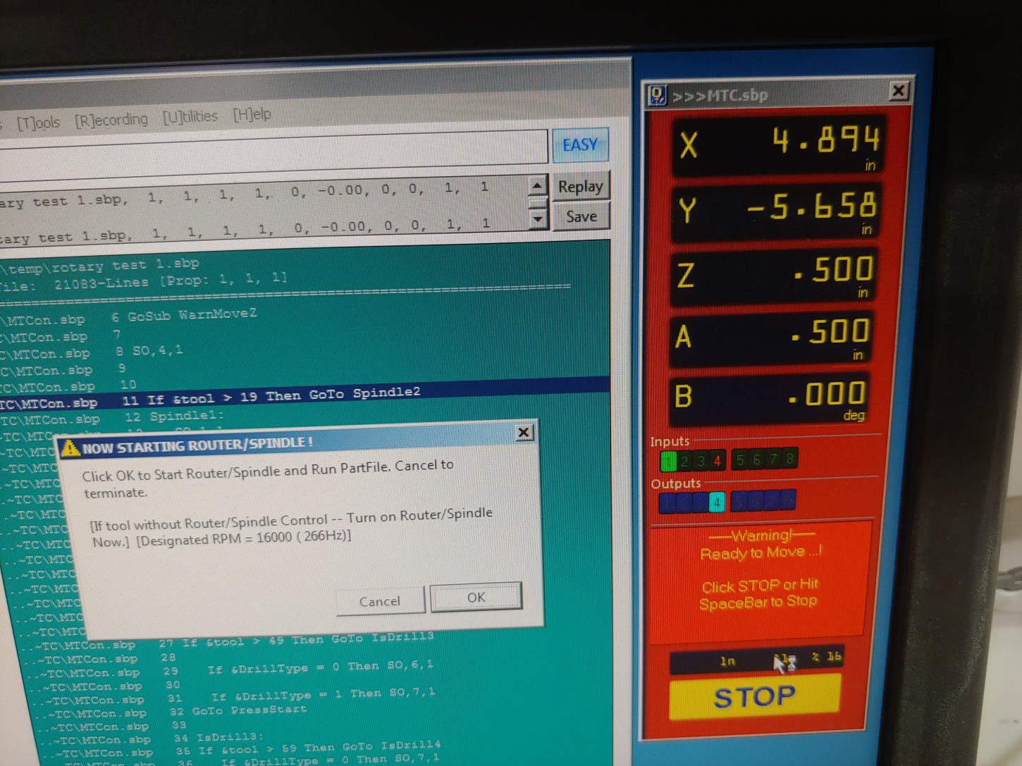

    See the attached pictures.
    Desktop Max
    Aspire 10.5
    I created a rotary part file to verify rotation of the indexer.
    Screenshots are below.
    I created a rounding toolpath with the gadget program and it worked fine.
    The 2 vertical lines created ring grooves, I created these with the quick engrave function. Both grooves cut the full 360 degrees.
    The deep groove that was created with a 2 rail sweep did not cut the entire 360 degrees, but the readout for the B value read 359 degrees. Note the location of the reference line on the end of the part. It started at B zero a vertical line, but when the program stopped it was not vertical, but the B value reads 359 degrees. The line should be much closer to vertical at 359 degrees.
    The Value for the stepper is 83.3333
    I verified full rotation my scribing a line on an aluminum bar and using a pointer in the collet. Rotation at 360 degrees was as close as my eyes could register using a magnifier glass.
    Note that the vector box I drew should have been big enough for the tool to overlap.
    The puzzling part is why does the B value not match actual rotation in some parts of the program and not others?

    The last picture
    Top pics are the Aspire screenshots.
    3&4 are before initiating the program
    5&6 are after the program stopped.

    My guess is that the B-axis lost steps. I'd bet the depth of cut is different for that feature or the feed speed.
    You could try running that feature without a blank in it and a reference mark on the headstock for B=0...air cut it..and see if it runs correctly?

    Thanks for the response.
    As I said, I did verify that the rotation is accurate at 360 degrees.
    The curious thing is that this error seems to only occur when doing a 2 rail sweep.
    The grooves I cut as a V Varve rotated the proper amount.
    Also using the gadget to create a round from a square worked as well.
    I did recut the part after re-zero the B, since the part was already cut there was absolutely no resistance from cutting, and the result was the same.
    For some reason, when running a program the B value is changing...don't know how that could happen, but that is what it appears to be.
    Tool, feed and speed is all the same for both the VCarve and the 2 rail sweep.
    Seems like something I am missing in creating the feature in Aspire with a 2 rail sweep, but I cannot figure that out. As shown in the screenshot, the vector boundary I drew should be more than enough overlap to make the machine rotate more than 360 degrees to eliminate the uncut portion.

    I'm thinking that your 2 rail sweep is actually stopping at the job dimensions of 6.6602" and not 7.5". Try setting up your job dimensions as 7.5 and redo your sweep and try it again. Any components that are out of the job area are not able to be toolpathed. Or put this way, components (your sweep), are not read if they're outside of the job dimensions.

    So, I was mounting another piece of wood for more testing, and as I was tightening the chuck I noticed that the chuck will rotate.
    Power is on, I can rotate the indexer manually.
    This does not seem right to me, I would think that with the power on to the chuck that it would not rotate easily by hand.
    I do not want to take the thing apart for fear of voiding the warranty.
    I will send this to Shopbot to see what they say.

    SB support directed me to the location of a split coupler screw that connects the motor to the gearbox. That was indeed loose, and tightening the screw fixed this issue.
    I am just before making another couple cuts to see if this had an effect on the other problems I am having.
